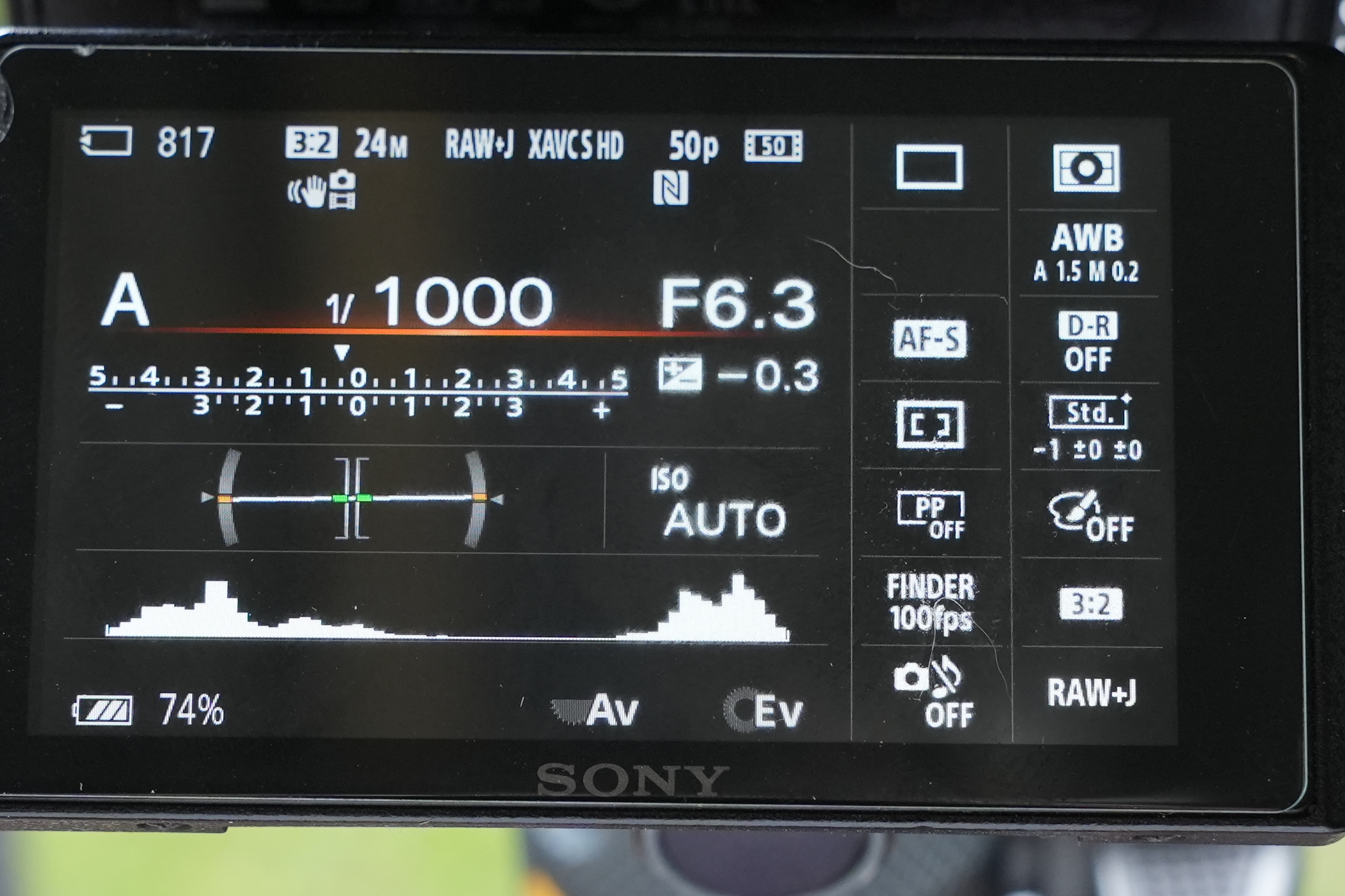

  • Members 1738 posts
    May 13, 2023, 9:31 p.m.

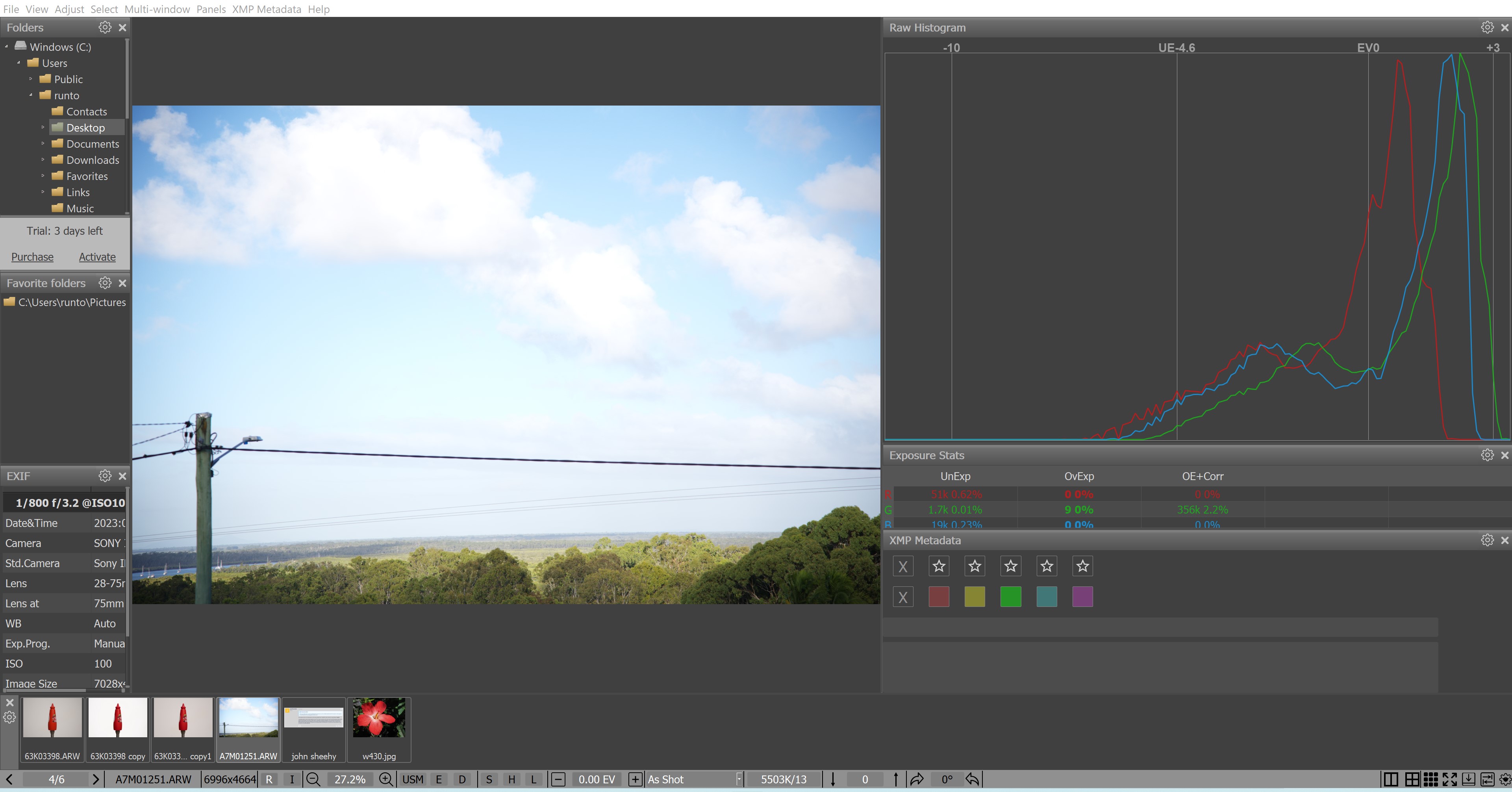

    The one time in this thread where you posted an in-camera histogram and a raw file, it showed the in-camera histogram was quite far from the real raw histogram, particularly, as I remember, in the red channel. I posted the raw histogram and compared the two. If we had threaded view, I could probably find that post.
    As I said earlier, I have not tested your camera, but I have tested the a7, a7II, a7R, a7RII, a7RIII, a7RIV, a9, and a9II. The in camera histograms of those are in the same inaccuracy ballpark as Nikon Z cameras and Fuji GFX ones.

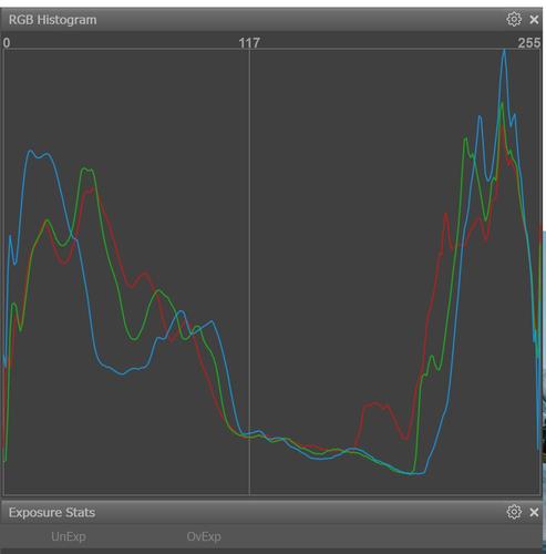

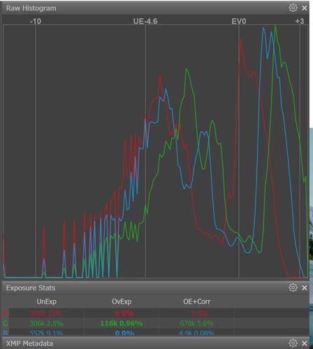

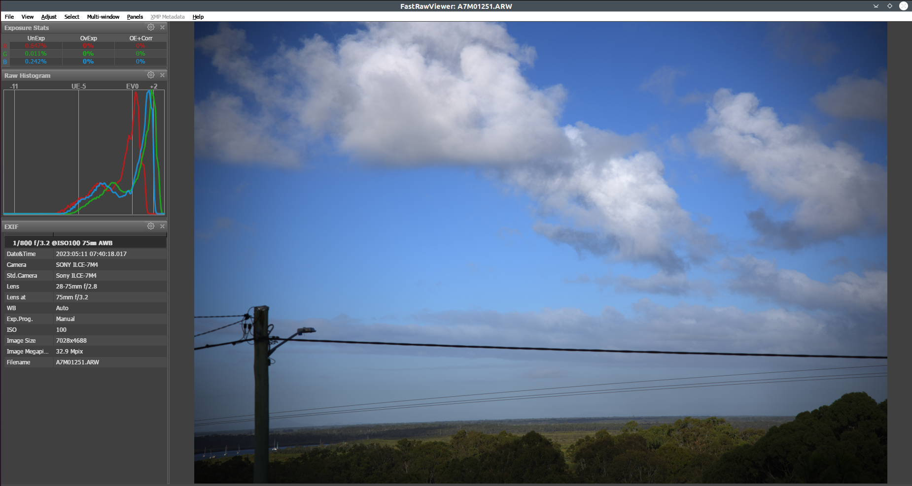

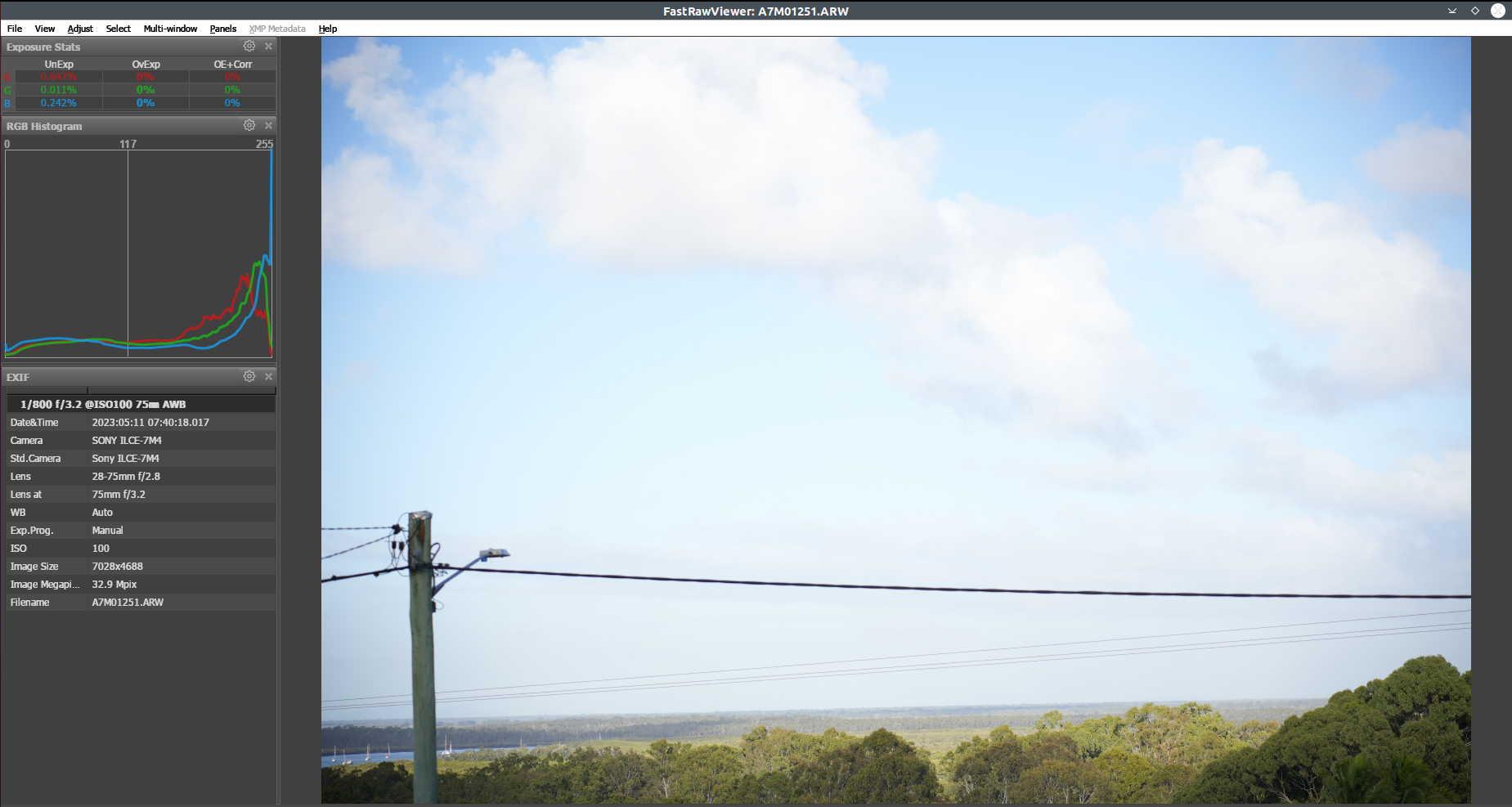

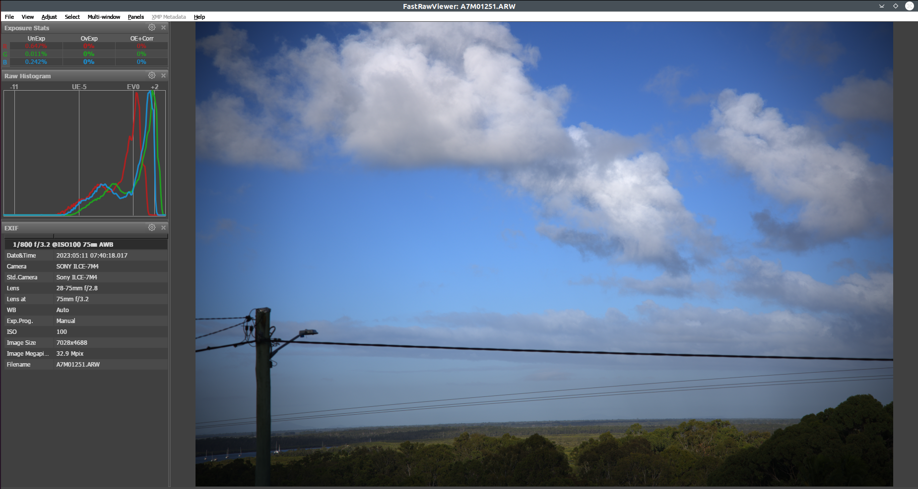

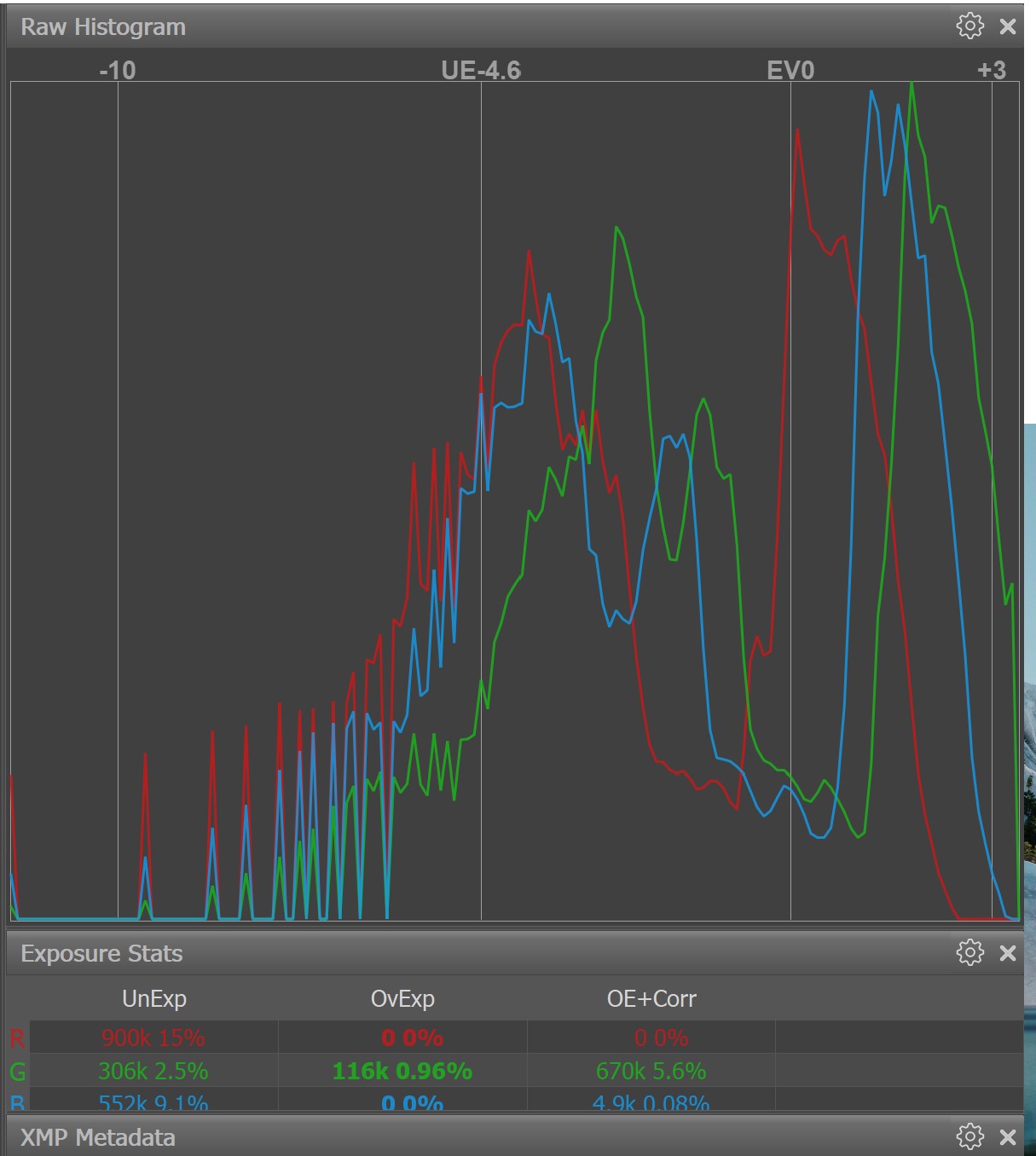

    May 13, 2023, 9:45 p.m.
    Well, here is from one of raw files Donald posted for everyone to see:
    It shows clipping when there is none in raw. Raw highlight inspection tells that there is plenty of details in highlight to work with:
    PNG, 1.6 MB, uploaded by IliahBorg on May 13, 2023.
    PNG, 1.1 MB, uploaded by IliahBorg on May 13, 2023.

  • Members 976 posts
    May 13, 2023, 9:54 p.m.
    Stop with that already. Everyone can check the raw file and see you are wrong in your accusation.

  • Members 976 posts
    May 13, 2023, 10:01 p.m.
    And how different are those raw histograms? Scale tricks you?

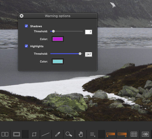

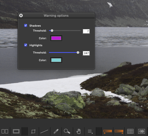

    May 13, 2023, 10:07 p.m.
    The last image in that series is of a photo in Phocus preceded by: "But when we turn the clipping warning on, some of the flowers are tinged in purple". Unfortunately, there's no way for the reader to know what the highlight warning indicates because you don't say what threshold setting is being used. The screen shot would be more useful if the highlight / shadow warning tool was included to show what the warning is actually indicating is clipped or if that information was included in your text.
    www.lensrentals.com/blog/2023/05/how-to-expose-raw-files-part-2
    PNG, 330.6 KB, uploaded by TechTalk on May 13, 2023.
