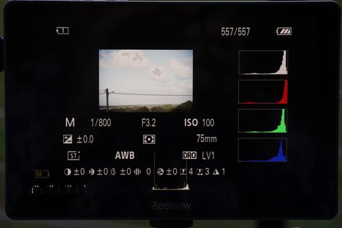

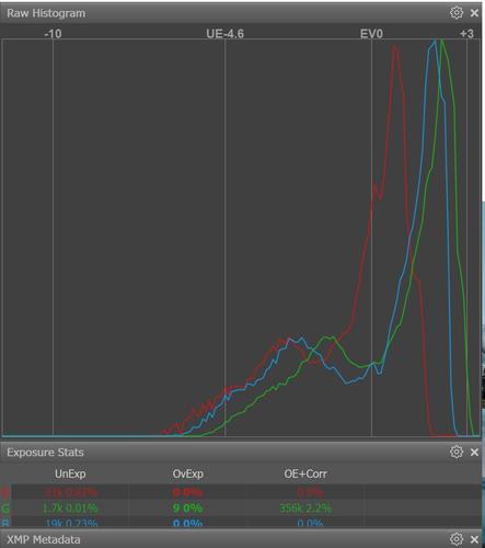

    Post the raw file. Post FastRawViewer statistics screenshot. It's possible that your zebras are not accurate.
    1drv.ms/i/s!ArStsPjQ301PmTGIRYjPX5i7OTOO?e=GpypBH
    will shoot some more tests today as i have a day off work.
    Thank you. The raw data in this raw file maxes at 12180. Clipping for A7M4 happens at 15871. Zebras are wrong if they indicate clipping.

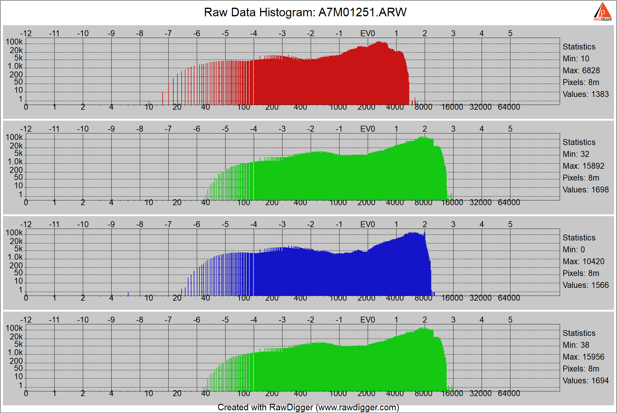

    This is an ETTR raw file:
    But the shot of the back of the camera shows the red channel blown. The red channel is nowhere near blown,

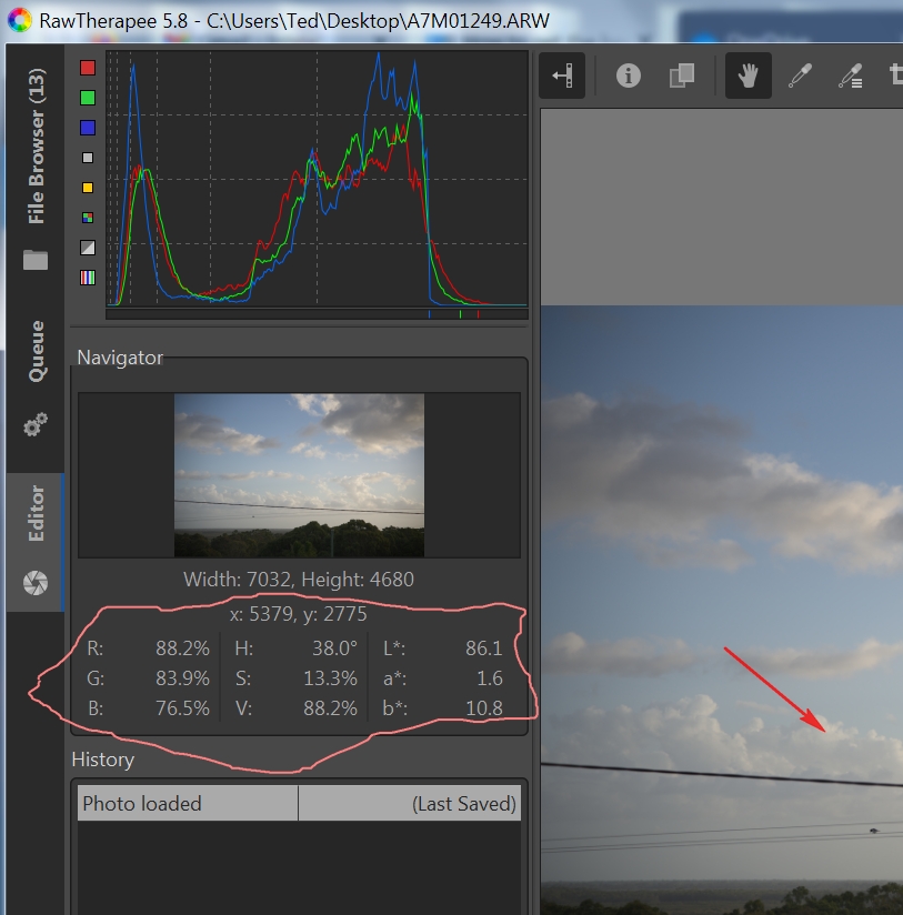

    And here's what RawTherapee thinks, FWIW ...

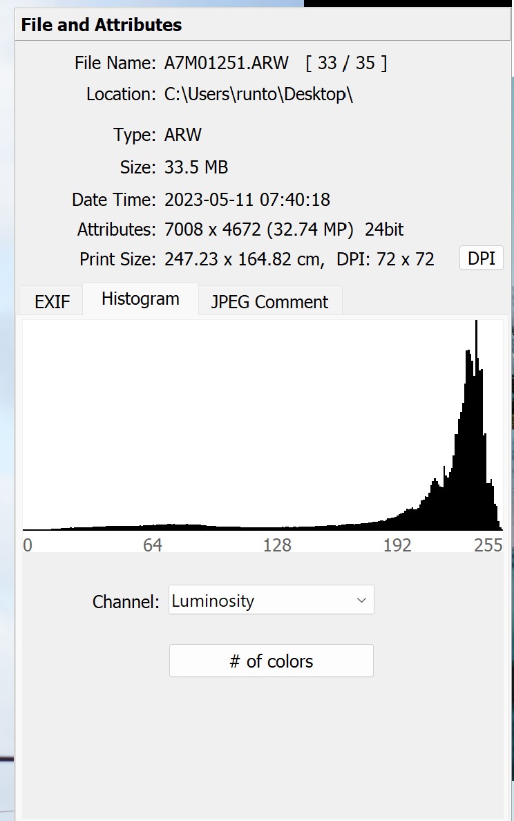

    faststone histogram
    JPG, 98.7 KB, uploaded by DonaldB on May 10, 2023.
    IliahBorg
    Members 976 posts
    May 10, 2023, 10:43 p.m. May 10, 2023, 10:43 p.m.
    @DonaldB has written:
    Raw file
    1drv.ms/i/s!ArStsPjQ301PmTJktgwBeeArFb21?e=gxNLgG
    faststone histogram

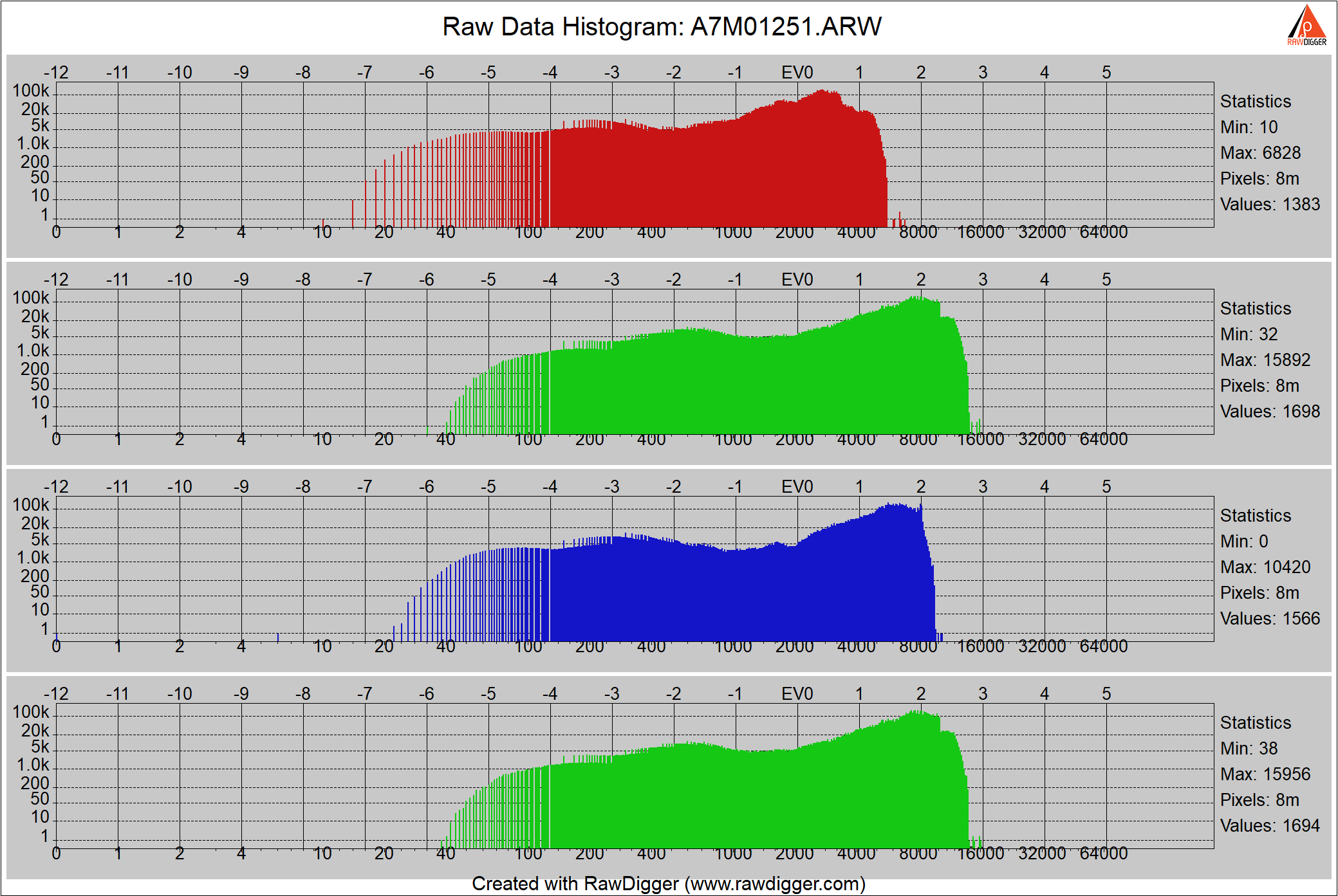

    As FastRawViewer indicates, 9 p;ixels are clipped, 5 in one green channel and 4 in the other.
