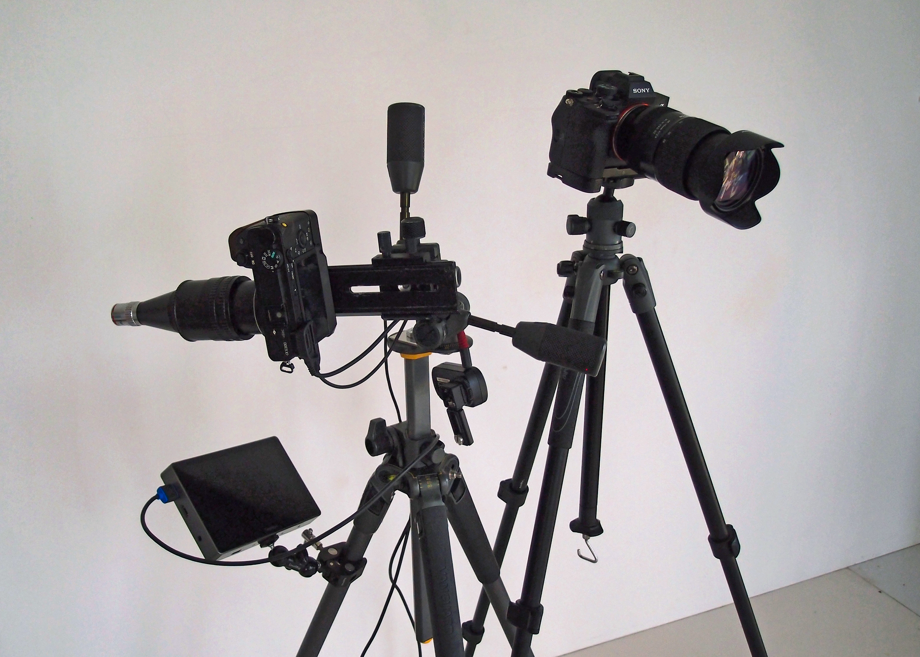

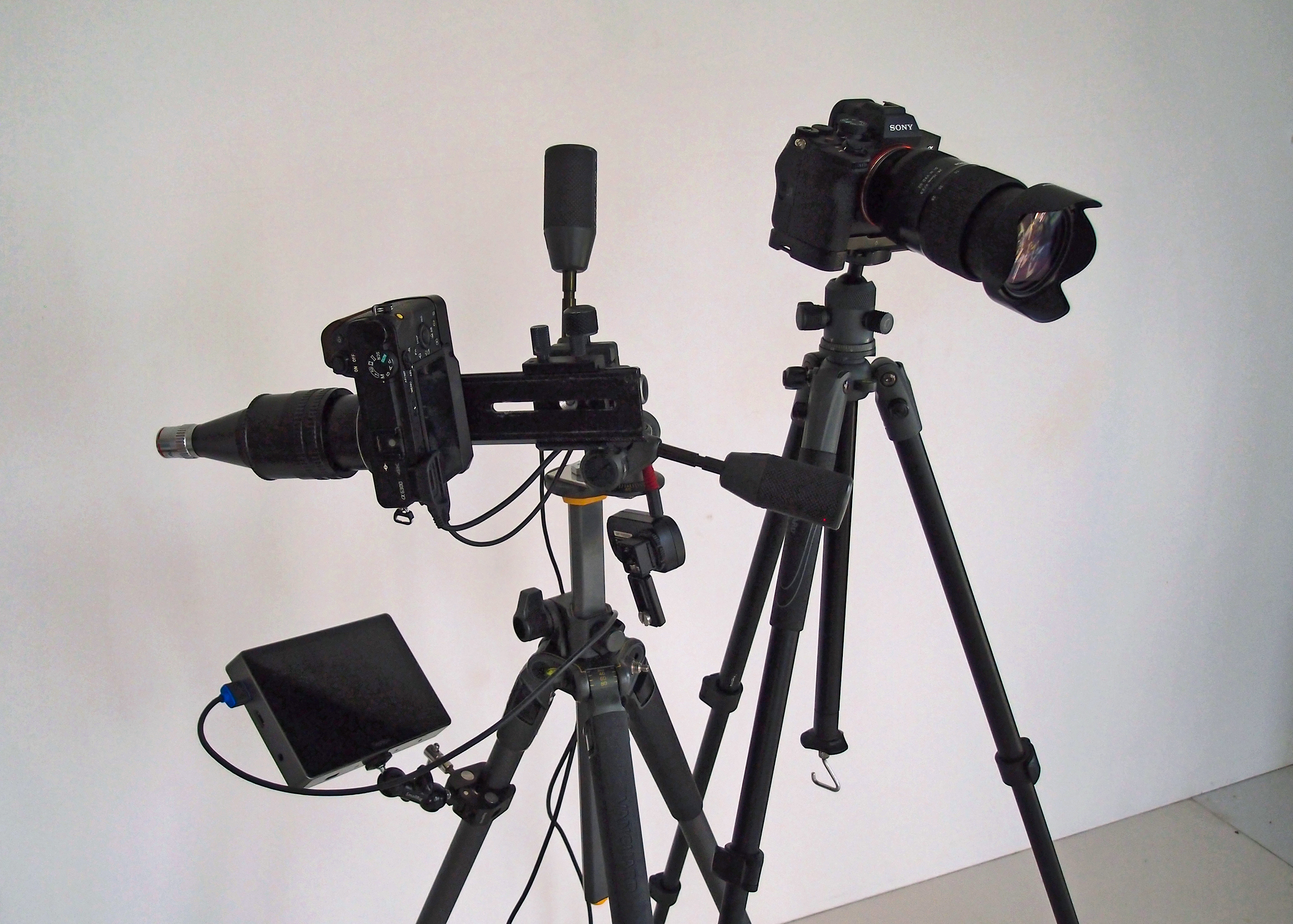

    Just for you Dunno
    JPG, 4.1 MB, uploaded by DonaldB on May 14, 2023.
    May 14, 2023, 8:32 a.m.
    I have no way of verifying who took that photo, so what point are you attempting to make?
