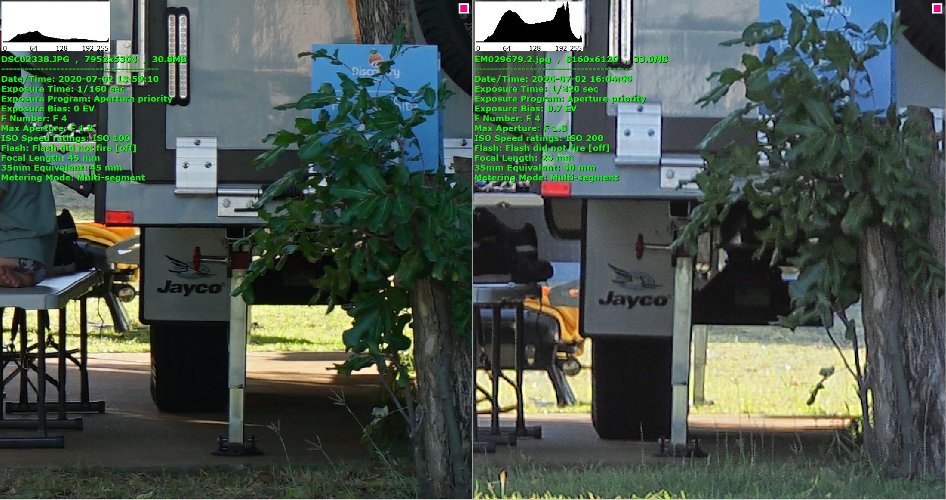

    By tricking you into viewing at a lower magnification with the go-to 100% pixel view.
    100% pixel views are important to some degree, but they are totally meaningless without context. I contend that if many photographers had access to a 2 GP FF sensor with higher QE and less read noise per unit of area than current sensors, they would say that the camera is "as soft and noisy as all hell".
  • Members 591 posts
    May 18, 2023, 3:48 p.m.
    Is that a joke? I have no idea what I'm looking at. The right half has clear stability issues.

    Clear stability issues 🙄 its the in camera hi res shot from the em12. everyone else
    knows that its a sony camera 1st image and olympus second.
