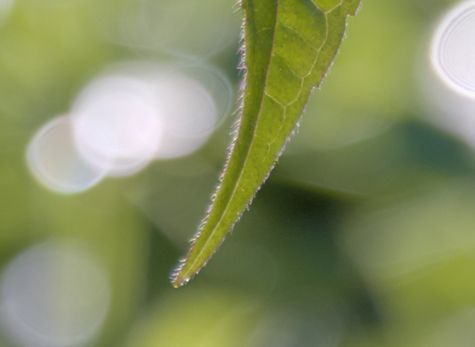

    This is part of a photo taken with a7Rmk4, 3,76 micrometer pixels. The aperture was between 8 and 11, so the diffraction was in the play too.
    What I see in the picture is aliasing if I understand how aliasing looks in pictures.
    I'll bet aliasing was visible in picture taken with 3,1 micrometer pixel pitch sensor.
    That means the lens outresolves the sensor?
    JPG, 991.7Ā KB, uploaded by TimoK on July 17, 2023.

    The aliasing improvements in real world photography when switching from the 50 MP to the 100MP 33x44mm sensor was something I found important in my photography. But I still see aliasing with the GFX 100x and the Hasselblad X2D.

    I see no aliasing here.
    I would expect aliasing to show up most clearly on a photo of a city scene, with plenty of slanted straight edges on buildings.

    I see aliasing, even though there is a bit of softness in the image. In this case, it would be pretty easy to deal with in post.

    July 18, 2023, 2:57 p.m.
    F/11 is enough to suppress aliasing effectively — but not completely — with a 3.76um sensor.
