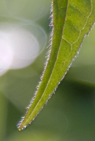

  • Members 300 posts
    July 18, 2023, 6:40 p.m.
    There is aliasing, I'm sure of it. But my example was not so good. It is a cropped screenshot of a picture shown at 200% in Gimp. I think here it is magnified more, maybe to 250 - 300%. So, it is pretty soft, when at the same time the lens is too sharp. 😅
    I post here a crop from the opened picture, a little sharpened.
    JPG, 186.6 KB, uploaded by TimoK on July 18, 2023.

  • Members 78 posts
    July 18, 2023, 9:21 p.m.
    Hard to tell with processing and downsizing. Is the raw available?
  • Members 509 posts
    July 18, 2023, 9:30 p.m.
    Back in my Kodak 14n days, over on the DPR Kodak forum we used to call those lovely colour sprinkles on the hairs on that leaf "Christmas tree lights". They were every where on that camera unless you blurred the a & b channels in LAB mode.
  • Members 1737 posts
    July 18, 2023, 9:45 p.m.
    I once took a picture of a wet asphalt driveway with the 14n and it looked like an oil slick.
