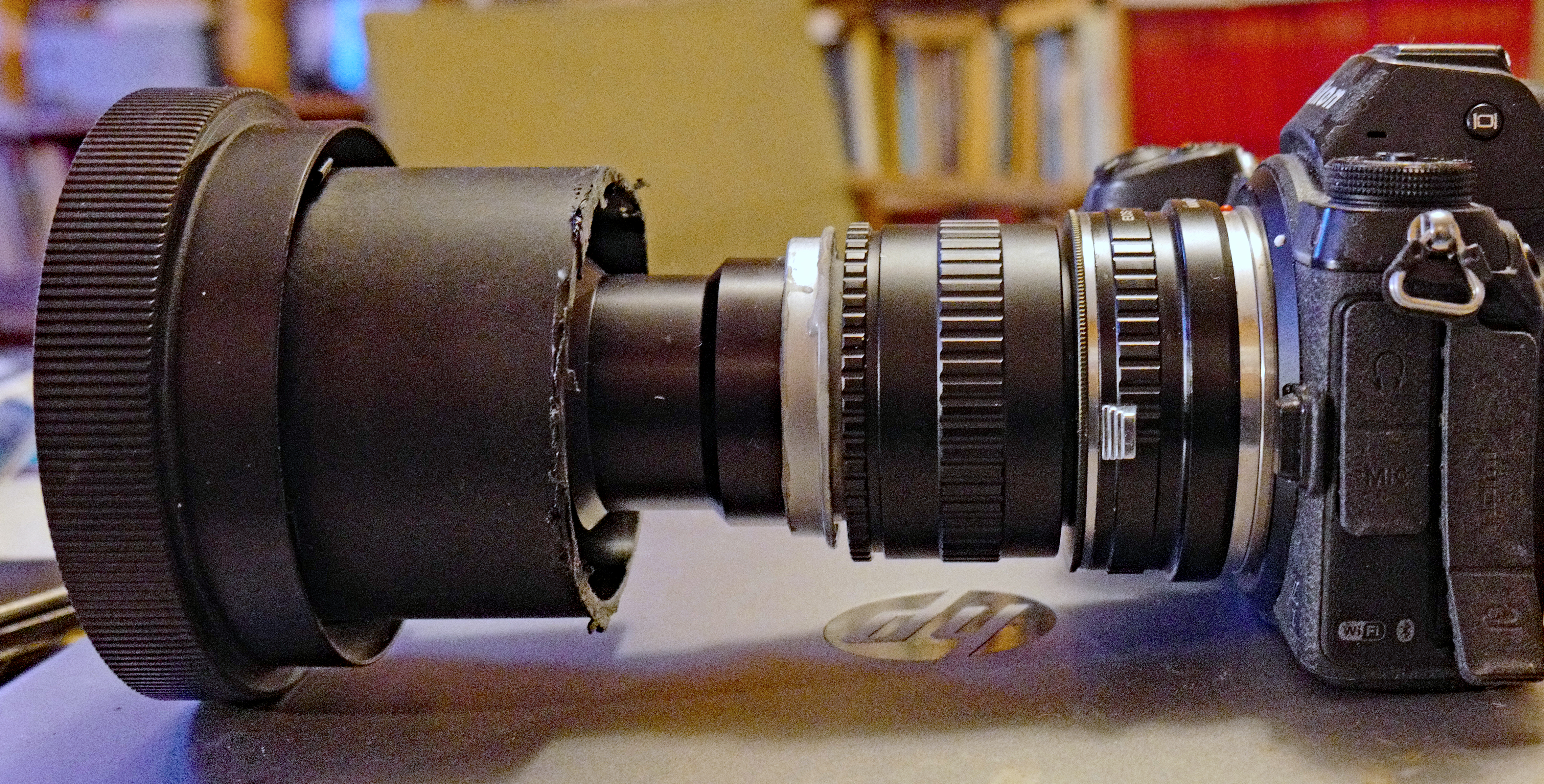

    This time i can report onhaving sawed off the plastic shroud of a zeiss distagon 75mmf2,8 hasselblad projection lens, glued on a suitable monting ring on the narrower lens shroud that was made accessible, and fitted a helix focusser.. The resulting fixed aperture lens works. (Ad the cat name-; tau is the greek letter symbol for 2 pi since her predecessor was sophia-pi (named after the first female maths professor plus the relation circle radius to circumference that another of my grandchildren thought ws a more obvious marhs connection))
    The advice above ad enlarging included snaps does not work on my machine.
    p.

    Works well. But, sawing on a Zeiss Distagon seems extreme. I don't have the courage to do it. Have a Leitz Colorplan 90 that needs trimming to reach infinity. Haven't been able to pull the trigger. Just using it for close-ups now.

    the lens data should read 75mm f.2,8, but i was too lazy to edit the Exif data on this snap. Ssawing a plastic shroud does not affect the glass and metal innards. I would never attempt amateur surgery on a lens beyond changing mounts. and even then only if it acn be done without disturbing centering, aperture funcrions and intended back focus result.

    furter to the lens surgery i performed, here is what the result looks like
    JPG, 11.4 MB, uploaded by PHz on Feb. 4, 2026.
  • Members 742 posts
    Feb. 4, 2026, 6:25 p.m.
    Looks brutal. I feel sorry for the lens. But, if it works well optically the surgery is probably justified.

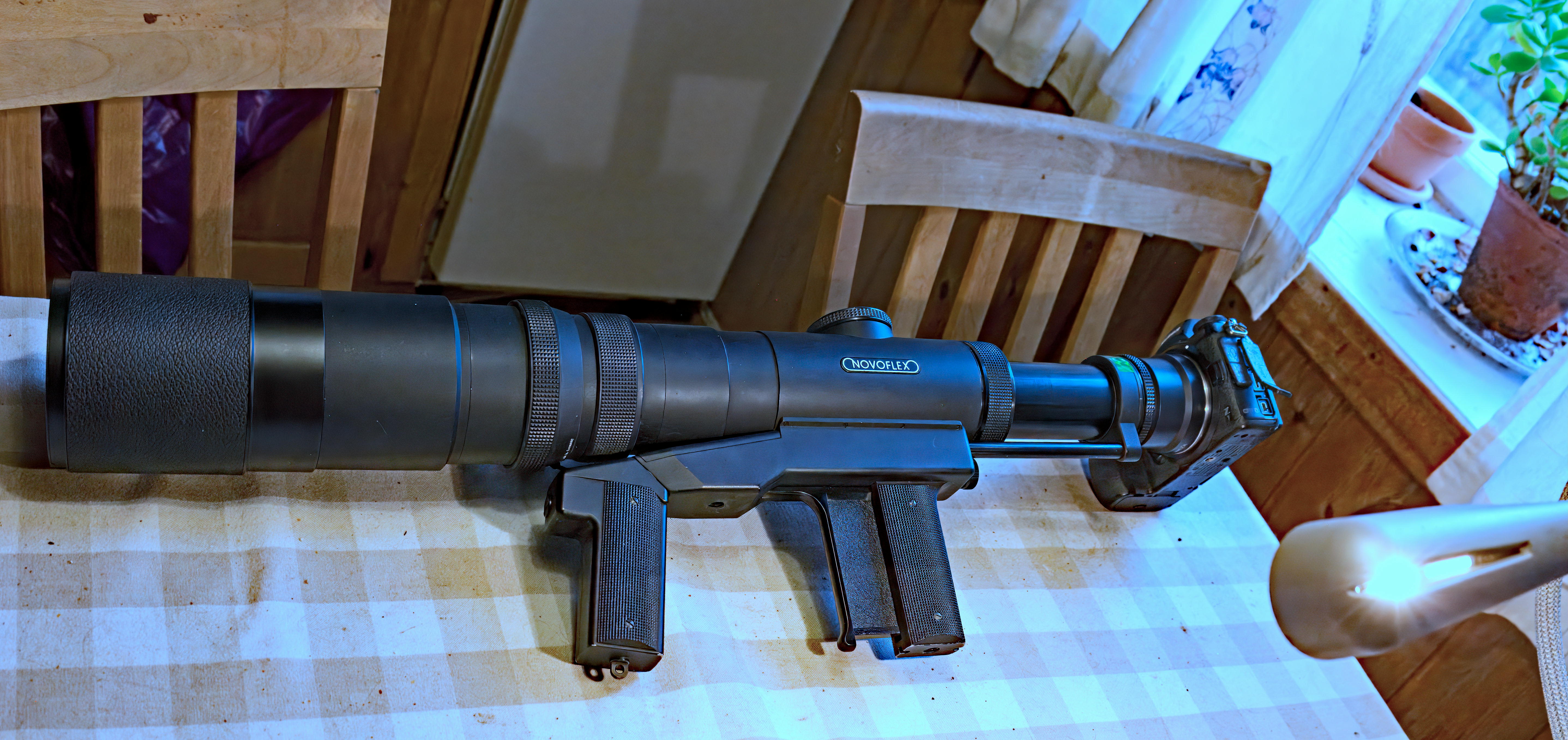

  • Members 130 posts
    March 15, 2026, 7:04 p.m.
    I keep replying to my own thread but then it becomes a real chronicle
    JPG, 1.7 MB, uploaded by PHz on March 15, 2026.
