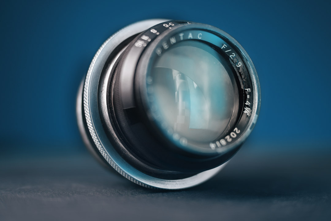

    I decided to start this one by showing a lens, which might not be spectacular in terms of sharpness and contrast (it's quite old, so uncoated and s relatively simple 5 elements in 3 groups design, from what I could find), the
    Dallmeyer Pentac 4 1/4 inch f/2.9
    It has a beautiful rendering though, which is the main reason I really enjoyed using it. I haven't tried finding out the exact date when it was built, but I would suspect perhaps in the 1930s or thereabouts. Quite impressive that it still works reasonably well. Here are a couple of shots:

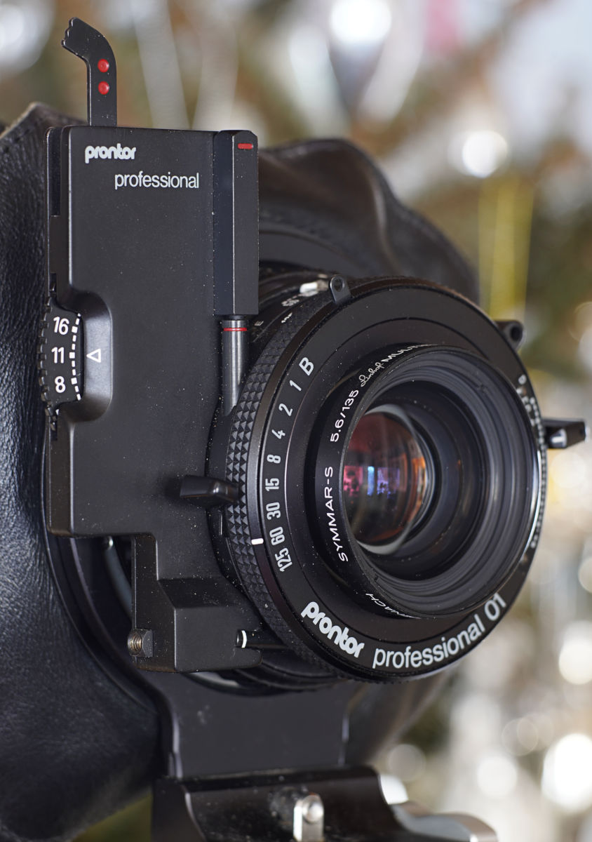

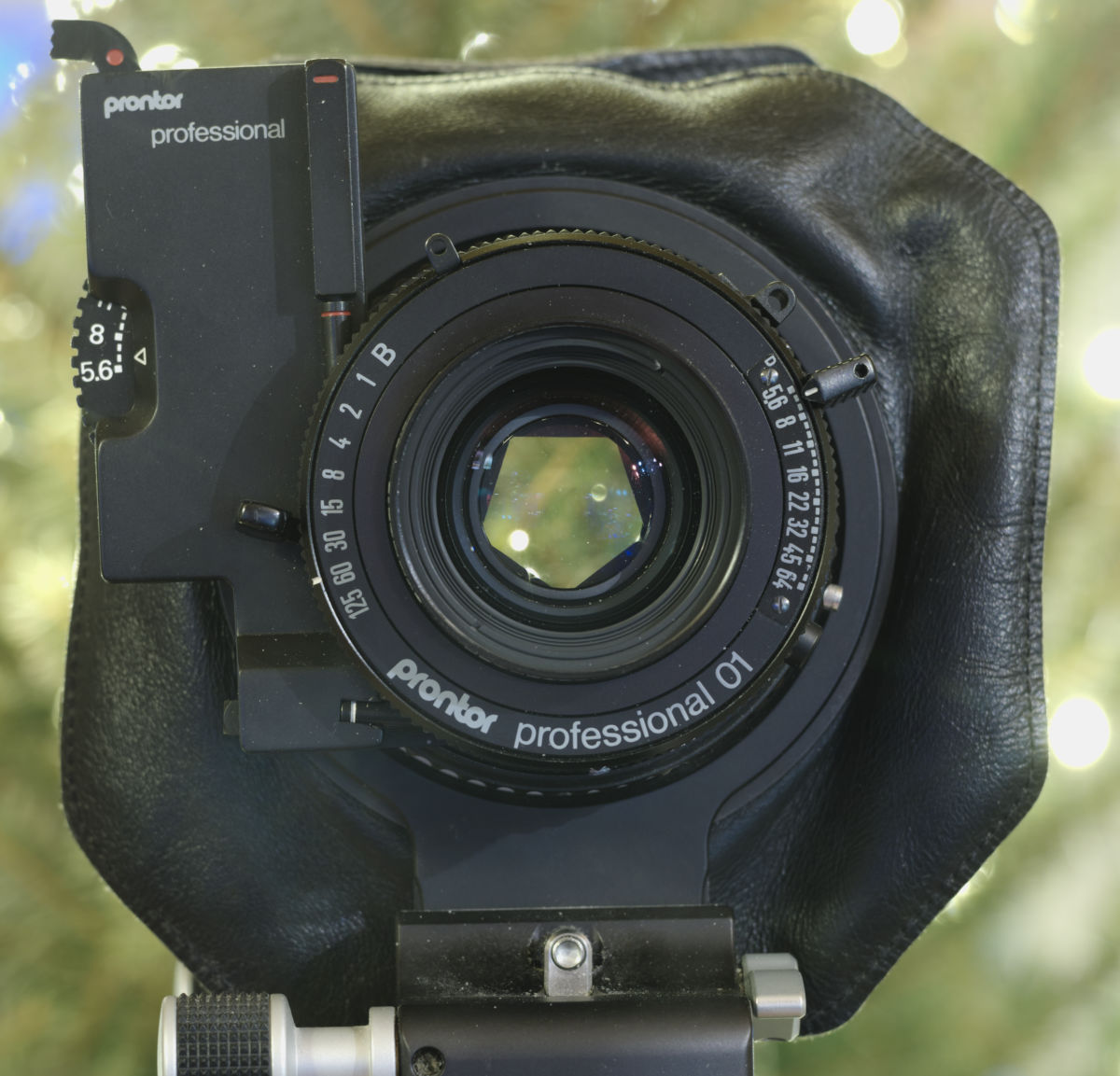

    I have a maybe 60 years younger lens, a multicoated, Linhof selected, 135mm Symmar-S by Schneider in Prontor 01 shutter:
    I took a test shot, it looks quite sharp.

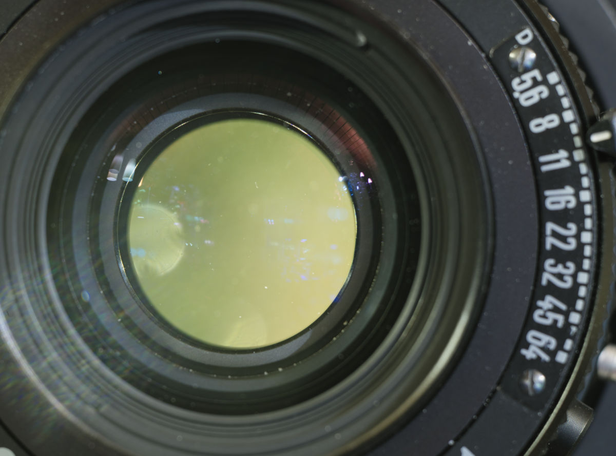

    Looks very nice! Is the diaphragm on your Symmar-S fully open at f/5.6 or not? I have a Symmar-S 150 mm f/5.6 and it seems to be at least an f/4 lens, but doesn't open fully, so I was wondering if it could possibly be changed by using a different housing...
    Thanks - yeah, that's likely its design. It's very interesting that those Pentac designs are very close to the Heliar design (just slightly different and mirrored outer groups) and both types of lenses are known for their nice rendering. The symmetrical 6/4 Double Gauss and similar designs may have their benefits in terms of correction as well as performance in the corners, but when it comes to rendering many of the 5/3 designs seem to do really well (even quite old ones) while the 6/4 designs seem to be all over the place.

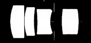

    It's a very unusual design to say the least. Just look at it:
    (Lens Drawing from Marco Cavina's excellent article: www.marcocavina.com/articoli_fotografici/TEST_Zeiss_Makro_Planar_50mm_2_vs_S-Planar_60mm_2,8/00_pag.htm

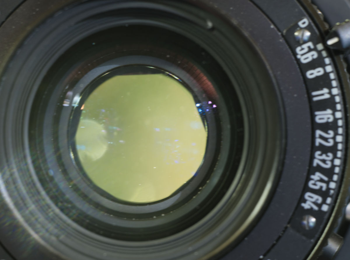

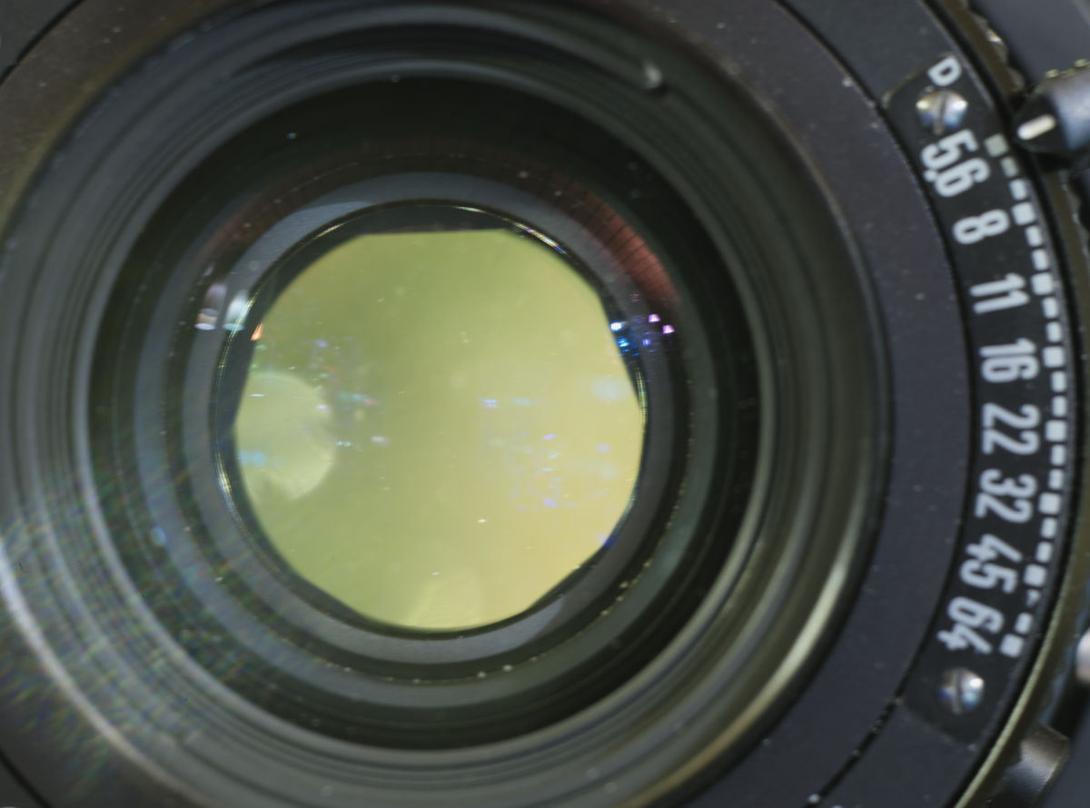

    Yes, it's almost fully open. I see a little difference between fully open and stopped down to 5.6 mark. Aperture blades just come visible at f/5.6. Sony camera doesn't react in that at exposure time. It looks less than one third of stop. I also have Apo-Symmar 150mm lens, the next generation after Symmar-S. It's in Copal 0 and have the same behavior. I think those both are f/5.6 lenses.
    Compare the aperture at f/6.3
    Edit. These pictures was taken with Schacht-Novoflex-Travegar 1:3.5/105mm R in Novoflex bellows using aperture f/8

    Thanks a lot. Yeah - mine does indeed look closer to your f/6.3 opening with the blades clearly showing. I really don't get Schneider's thoughts behind their aperture systems.
