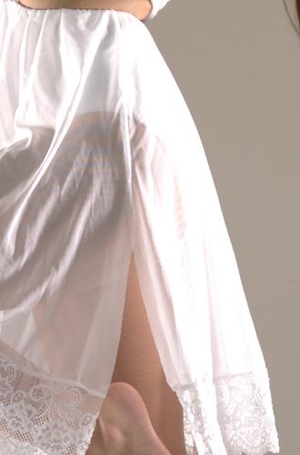

  • Members 2567 posts
    April 14, 2023, 5:41 a.m.
    nothing is clipped in the file, its just when i convert the raw to tiff in raw digger it clips the white dress.

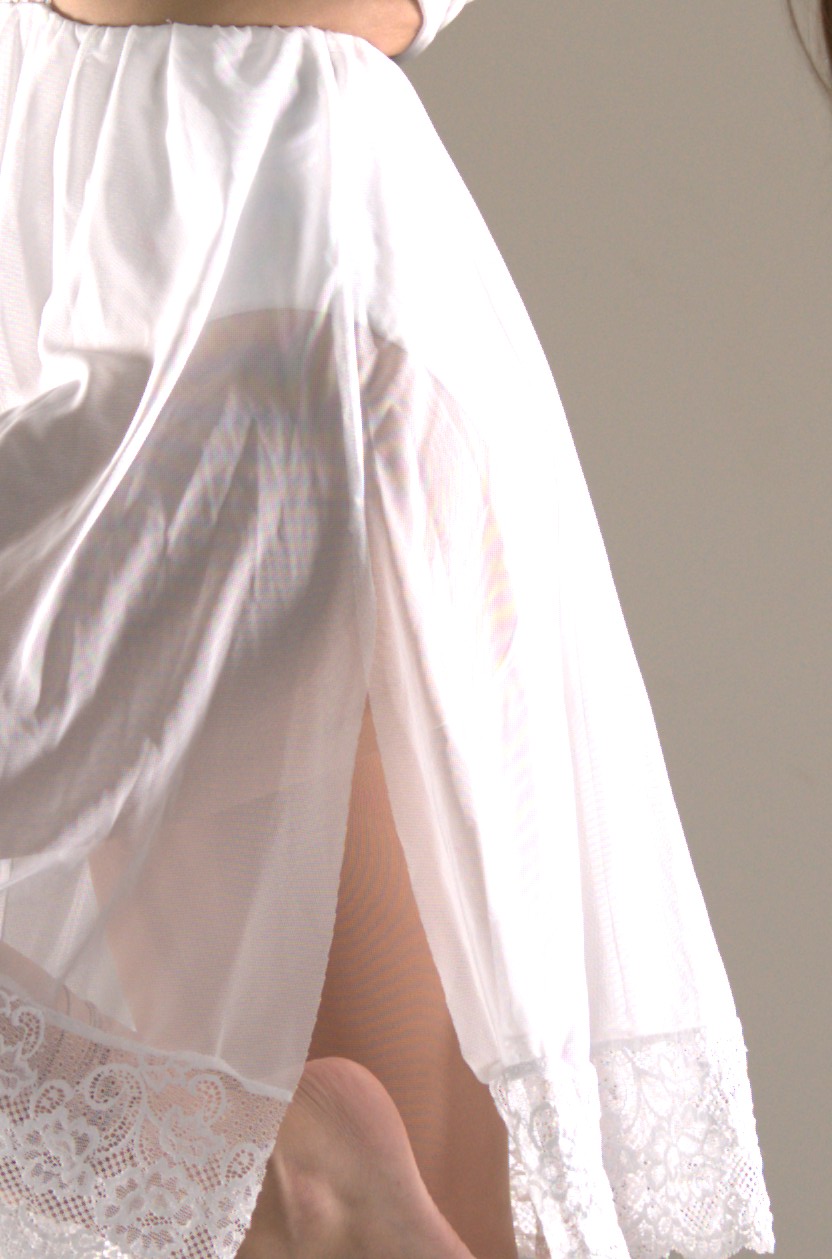

    April 14, 2023, 5:46 a.m.
    JPG, 185.8 KB, uploaded by DonaldB on April 14, 2023.

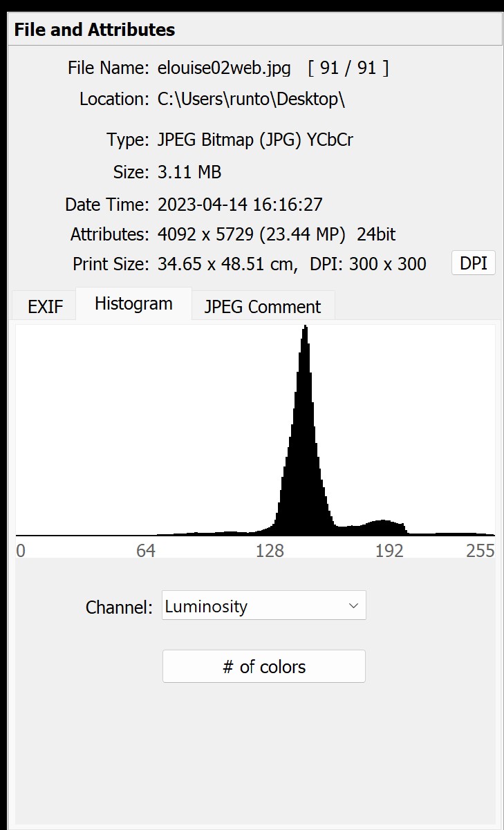

    April 14, 2023, 6:19 a.m.
    thanks for that , so dont use the program other than figures ?
    my PP image

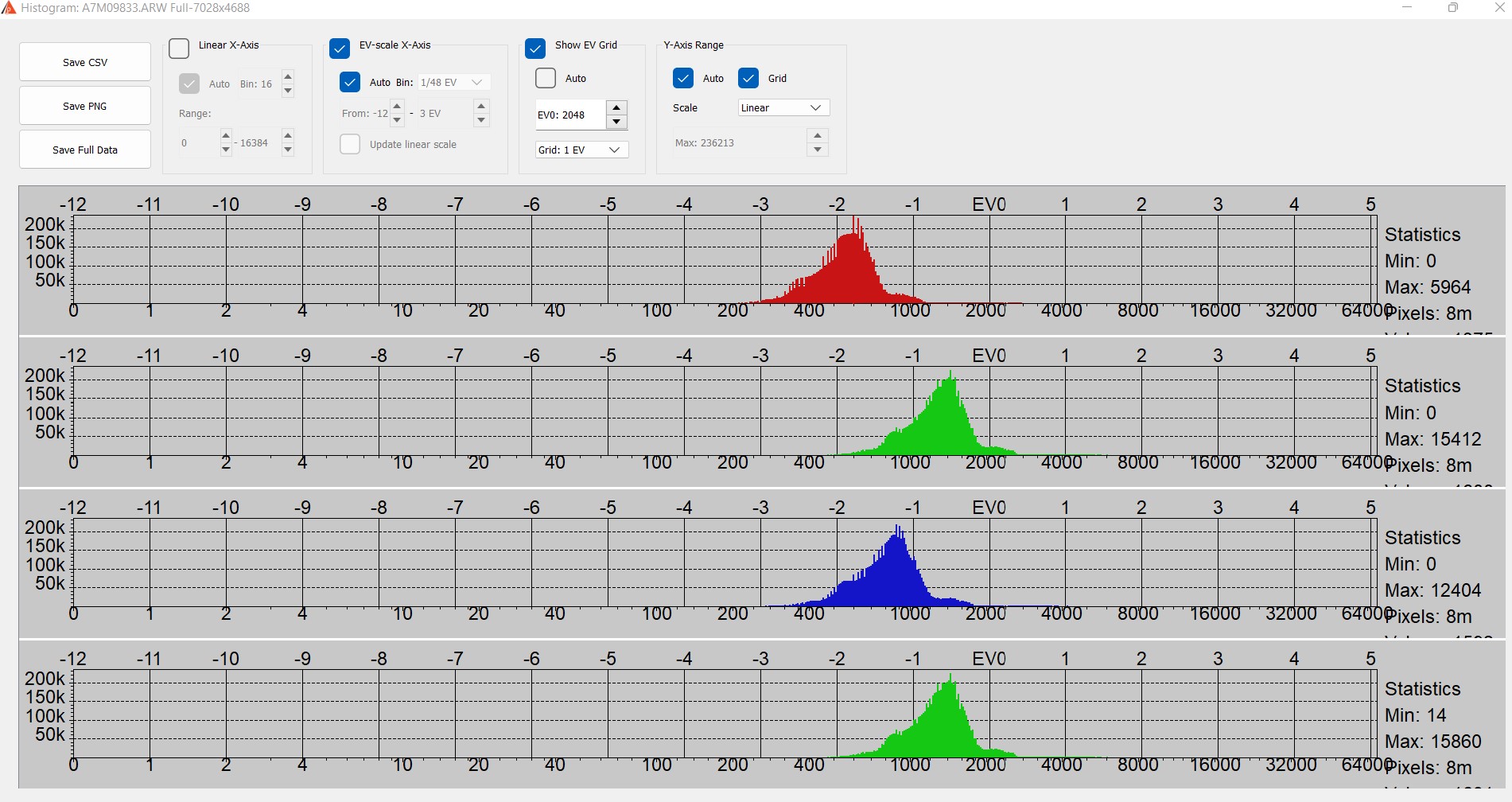

    April 14, 2023, 7:38 a.m.

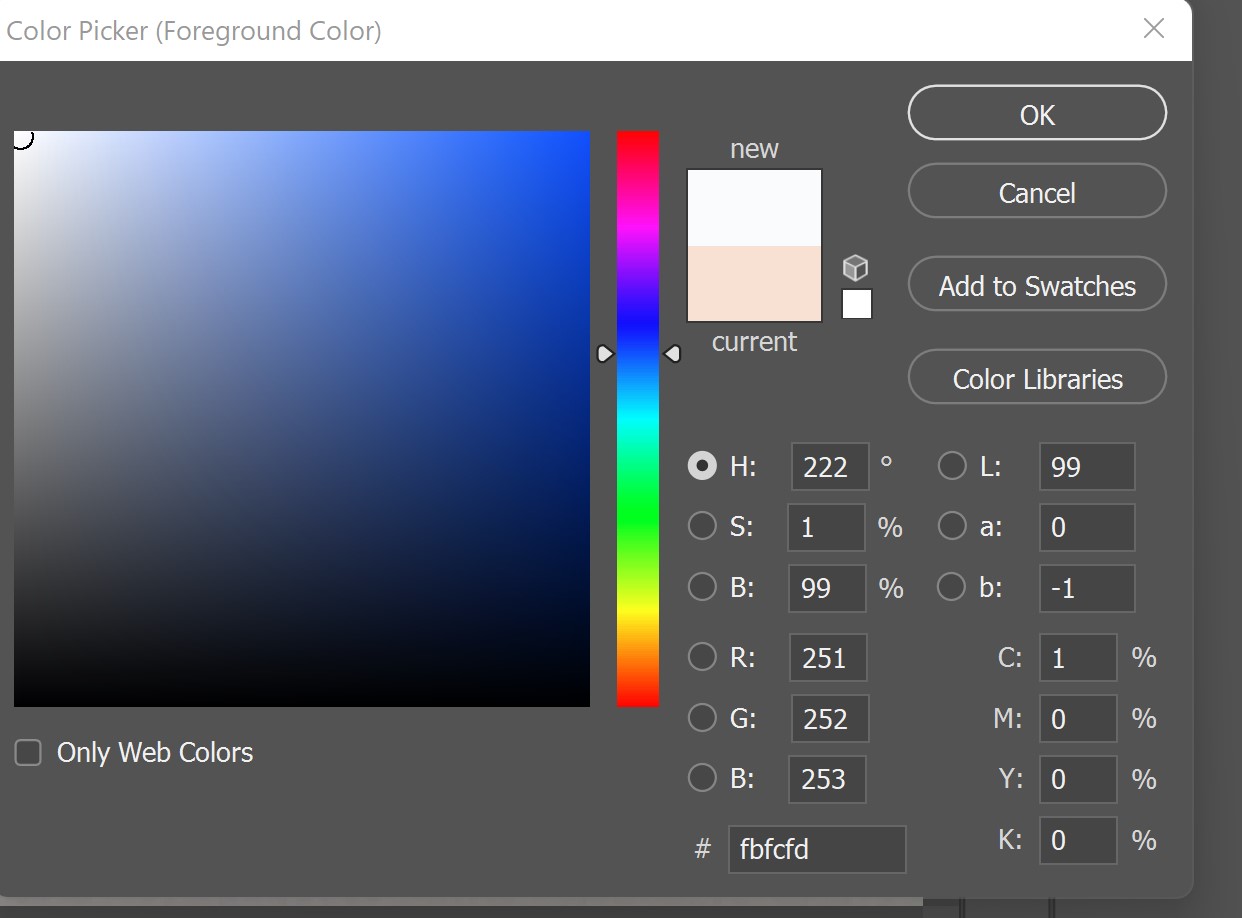

    what im finding is raw digger is not accurate at all. for the girl image these are what im seeing.
    JPG, 387.3 KB, uploaded by DonaldB on April 14, 2023.
    JPG, 97.5 KB, uploaded by DonaldB on April 14, 2023.

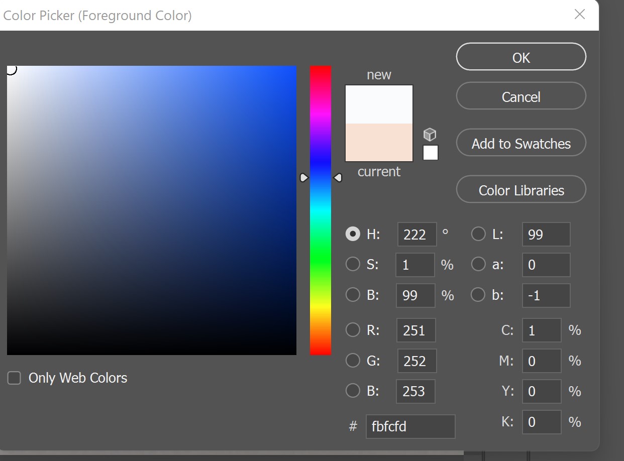

  • Members 227 posts
    April 14, 2023, 7:43 a.m.
    Around and around we go, how much is ACR shifting your raw data to the right do you know? if you don't know then how can you know what is clipped when look in ACR so please tell me how much behind the scene processing is being done?
    What without knowing how much your 3 channels are being multiplied for a given WB how can you tell what is clipped in the conversion? Please tell me how much is being done for a daily light WB? can you tell me this and if you can not how do you know what is clipped within the raw conversion?
    No IT REALLY TELLS ME HOW LITTLE YOU REALLY KNOW
    What it is telling you is where in a color space that color falls
    Oh no look at my red at 255 they are soooo close to clipping
    photos.smugmug.com/Temp/Temp/i-7TK9fpd/0/7574a945/O/redclipping.jpg
    but wait a minute the very same color show this how can it be? the red is not even close to the side of the histogram what gives
    photos.smugmug.com/Temp/Temp/i-CpL6KfN/0/90c599fe/O/sdfeerer.jpg
    one grab tell me that color of red is at 255,0,0 and the other is 179,70,26
    So please tell me which value is the correct value with how that color looks with in the image. I would start there. Its seems like you are unwilling to learn anything outside of what you think you know
    Like I said it really tell me how little you know.
    The best thing would be to rather than assume what you know as correct and start looking to see where and how you are incorrect
    I think i finally get it, tell me if im right or wrong . the greens in raw digger are showing slightly over EV0 correct ! but when i take the raw into ACR the WB has been processed thus reducing the 2 green channels ! and then not showing clipping ,is that whats happening ?
