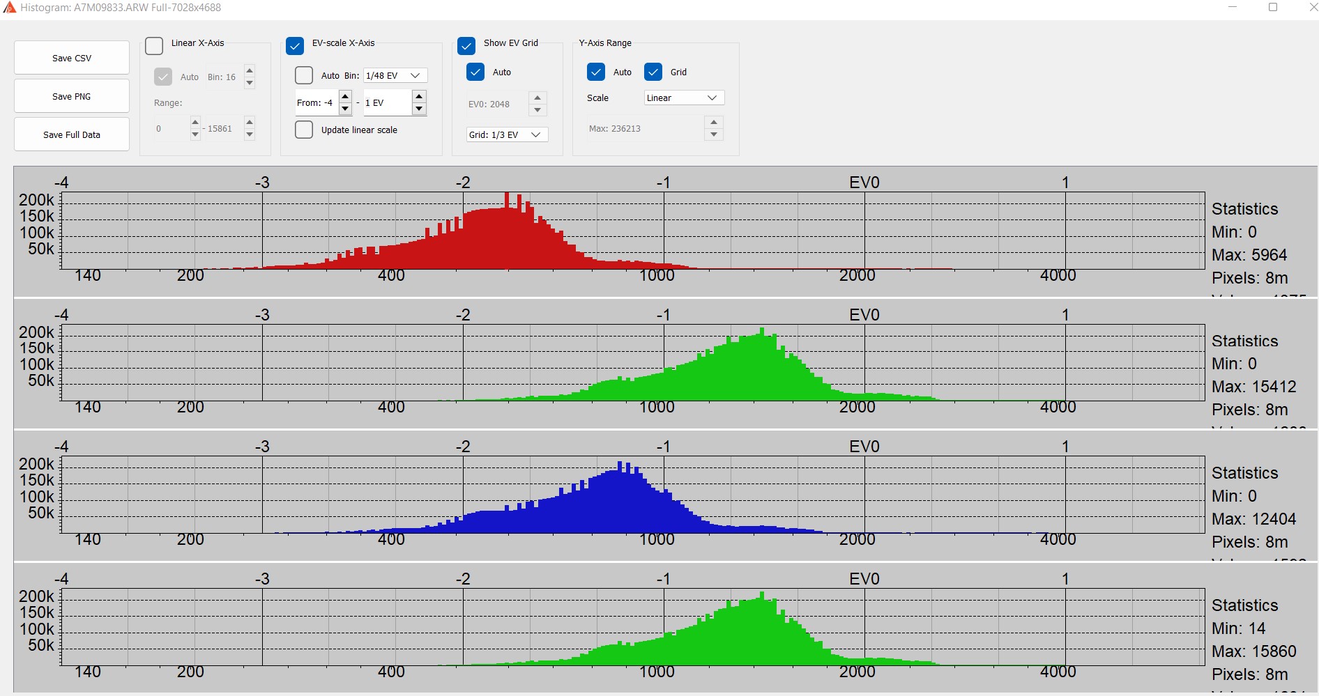

    No what is you baseline exposure for that make of camera and what processing is being done that is hidden you in the raw conversion.
    WB correction is only being added to the blue and the red
    April 14, 2023, 8:03 a.m.
    If RawDigger is not accurate as you say, then what should have RawDigger displayed?
    April 14, 2023, 8:13 a.m.
    Without having the actual raw file I cannot say what is happening.
    What I can say from the raw histogram is that the greens are about 2.5 stops underexposed assuming 16000 is the clipping point for 14 bit data.
    The reds are nearly 4 stops underexposed and the blues are 3 and bit stops underexposed.
    So based on my previous post you could have safely added 2 stops of exposure* than what you actually did for the shot the raw histogram is related to without clipping the raw data. Now of course the camera's histogram would have shown significant clipping if you added 2 stops of exposure* but the actual raw data would not have been clipped.
    If you had added that 2 stops of exposure* and then opened the raw file in ACR and lowered the image lightness by 2 stops using the 'exposure' slider then the resultant image would have less visible noise than the original image where you did not add that 2 extra stops of exposure*

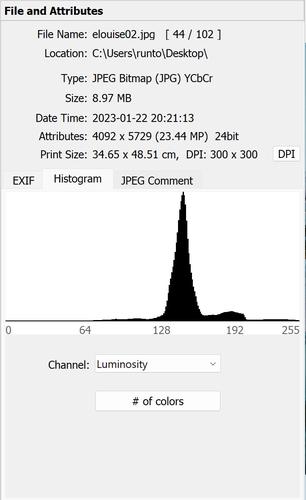

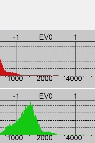

  • Members 2661 posts
    April 14, 2023, 8:39 a.m.
    this shows "0"EV can you not see that ?
    JPG, 26.5 KB, uploaded by DonaldB on April 14, 2023.

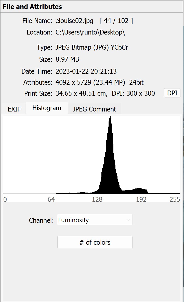

    April 14, 2023, 9:24 a.m.
    conclusion: thanks for the discussion but needed to know how good my studio exposures were using another program.
    I will not be adjusting my work flow because my images show "PERFECT EXPOSURE" using the in camera A74 histogram.
    If you want to debate it further then dont include me. as im now brain dead after a record 230 posts 😵‍💫😵‍💫😵‍💫
    my go to histogram fast stone.
    JPG, 101.1 KB, uploaded by DonaldB on April 14, 2023.
    JPG, 3.1 MB, uploaded by DonaldB on April 14, 2023.
    JPG, 344.3 KB, uploaded by DonaldB on April 14, 2023.
    April 14, 2023, 9:48 a.m.
    yes i was referring ev on the raw digger histogram as the figure "0" and after reading the info on there site and at DPR i was right as the histogram is in Photographic mode. or whatever it is.
