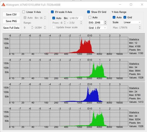

    Your raw data was 2 stops underexposed as shown by the histogram you posted.
    If that meets your definition of "perfect exposure" that's fine as it is your choice to make but my definition of perfect exposure is the optimal exposure** which is clearly different to your definition.
    * exposure - amount of light striking the sensor per unit area while the shutter is open
    ** optimal exposure - the maximum exposure* within dof and motion blur requirements without clipping important highlights.
    *** under exposed - more exposure* could have been added with the DOF and blur constraints still being met without clipping important highlights.
    April 14, 2023, 9:59 a.m.
    That question has already been answered so not sure why you are asking again.
    I don't have the raw file but we have the raw histogram for that raw file that you posted.
    How you add that 2 stops is up to you. If had, you would have ended up with higher quality raw data than what you did and less visible noise.

    your assumption is wrong there is no 16000 past "0" EV is clipping

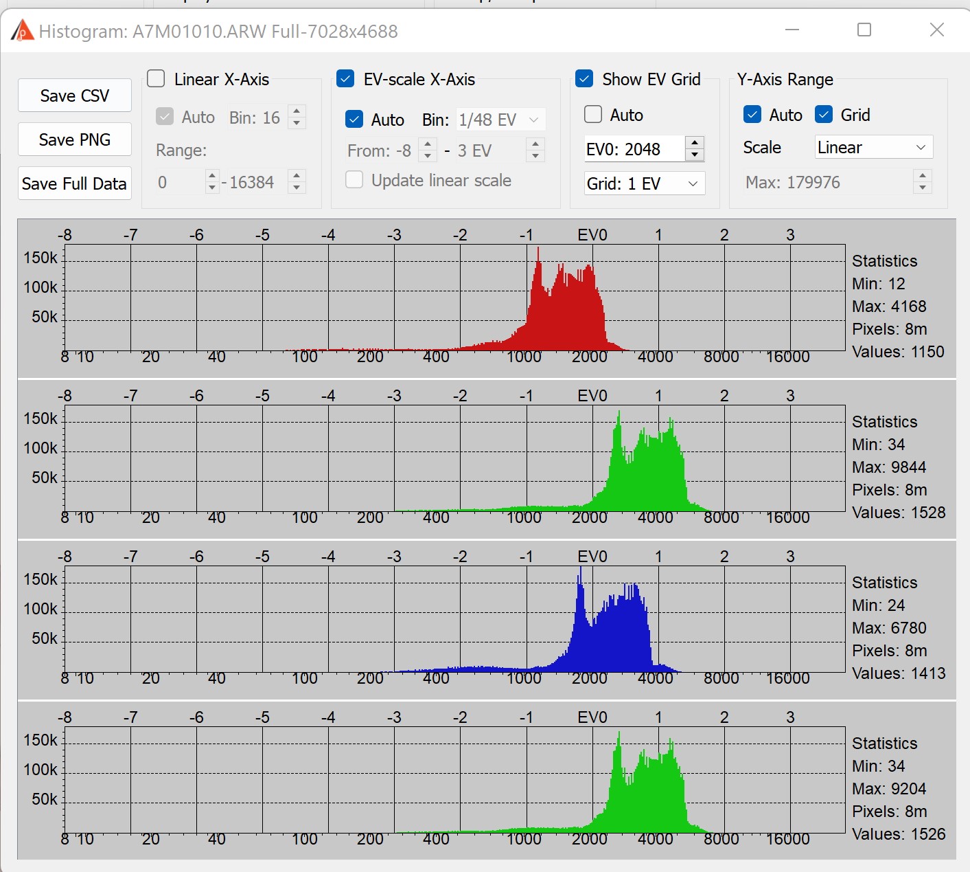

    I was referring to the histogram you posted below
    and you knew I was referring to that histogram because you posted it in your reply to my post at
    dprevived.com/t/raw-histogram-and-why-does-it-matter/1848/post/15814/
    So to summarise what I posted:
    JPG, 335.6 KB, uploaded by DannoB on April 14, 2023.

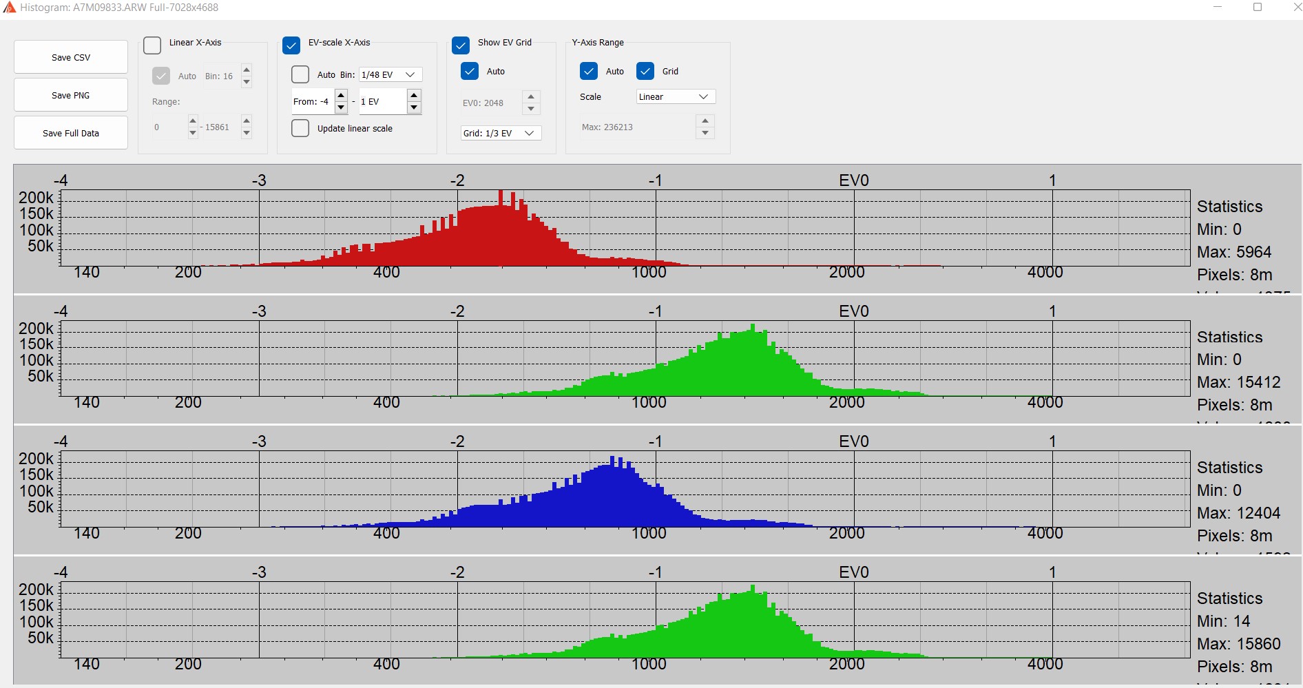

    sorry mate that was from another image. im referring to the dancer i posted with the accompanying histogram. i sent a link to Ian so he could have a play with the image of the dancer not the other one was just a selfie of me .
    sorry for the confusion ,its hard with the forum configuration as to what im posting to, its getting a bit confusing.

    At least now that we are on the same page regarding the histogram I was referring to, I hope the explanation and example in my earlier post give you an idea of the benefits of raw histograms in helping to maximise raw data quality and hence image quality.

    Please could you send the link to the raw file to us at support@rawdigger.com and we will explain what is happening and why.
  • Members 2663 posts
    April 14, 2023, 11:52 a.m.
    Thank you thank you thank you , sent link to you via private messaged

    Thank you for the file. When you export TIFFs in the "RGB render" mode, autoscaling ("Autoscale to use full 16-bit range") is applied by default. That may be good for previews, but not for analysis, and especially not for clipping analysis.
    To switch autoscaling off, please go to RawDigger preferences, "Display options", and switch off "Automatic exposure correction for RGB render" (page 44 of the manual). If raw isn't clipped and the clipping point ("white level") is set correctly, RawDigger will export a 16-bit TIFF without clipping. In this mode, 78 pixels are clipped in Photoshop 255 histogram limit if the RawDigger export is set to sRGB (default), 15 if it is set to ProPhoto RGB in preferences ("Display options" - "RGB rendering color space", page 43 of the manual). Photoshop rounds 16-bit files for the purpose of displaying histograms in 8-bit mode.
    If you look at the distribution in ImageJ (a very useful image analysis tool, en.wikipedia.org/wiki/ImageJ ), nothing is clipped in the TIFF, here is the extreme highlight portion:
    244 62463 57
    245 62719 37
    246 62975 34
    247 63231 35
    248 63487 45
    249 63743 25
    250 63999 31
    251 64255 31
    252 64511 13
    253 64767 11
    254 65023 1
    255 65279 17
    The 16-bit limit is 65535, but the maximum is 65279, that is lower.
    Also, in Photoshop, use "Set foreground color" to set it to 255, go to "Select" - "Color range", choose "Sampled colors" as the mode, press OK, and Photoshop will prompt "No pixels selected", meaning the pixels at exact 255 value are absent or so few and scarce that Photoshop can't isolate them.
    RawDigger TIFF export is not of a general raw converter, it is an instrumental one, like the other functions in RawDigger.
