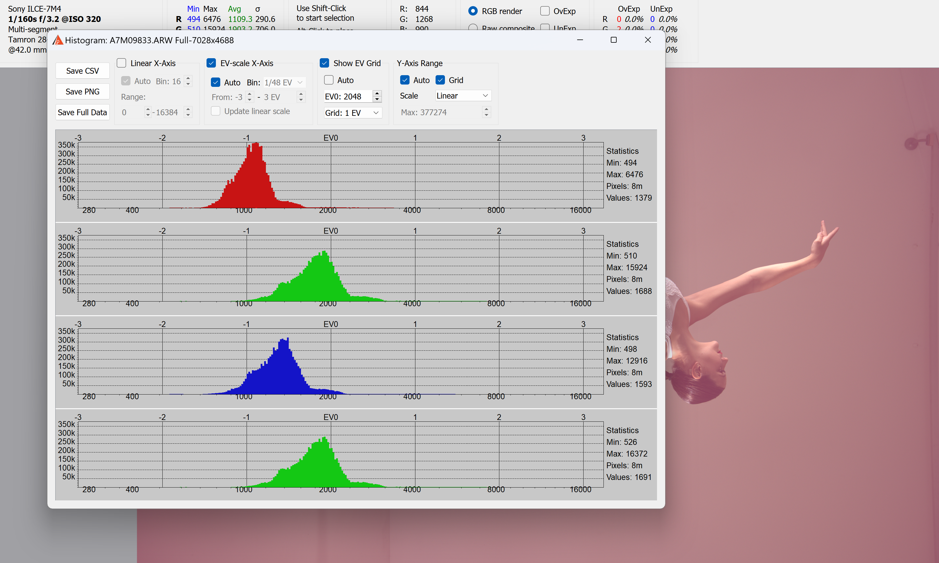

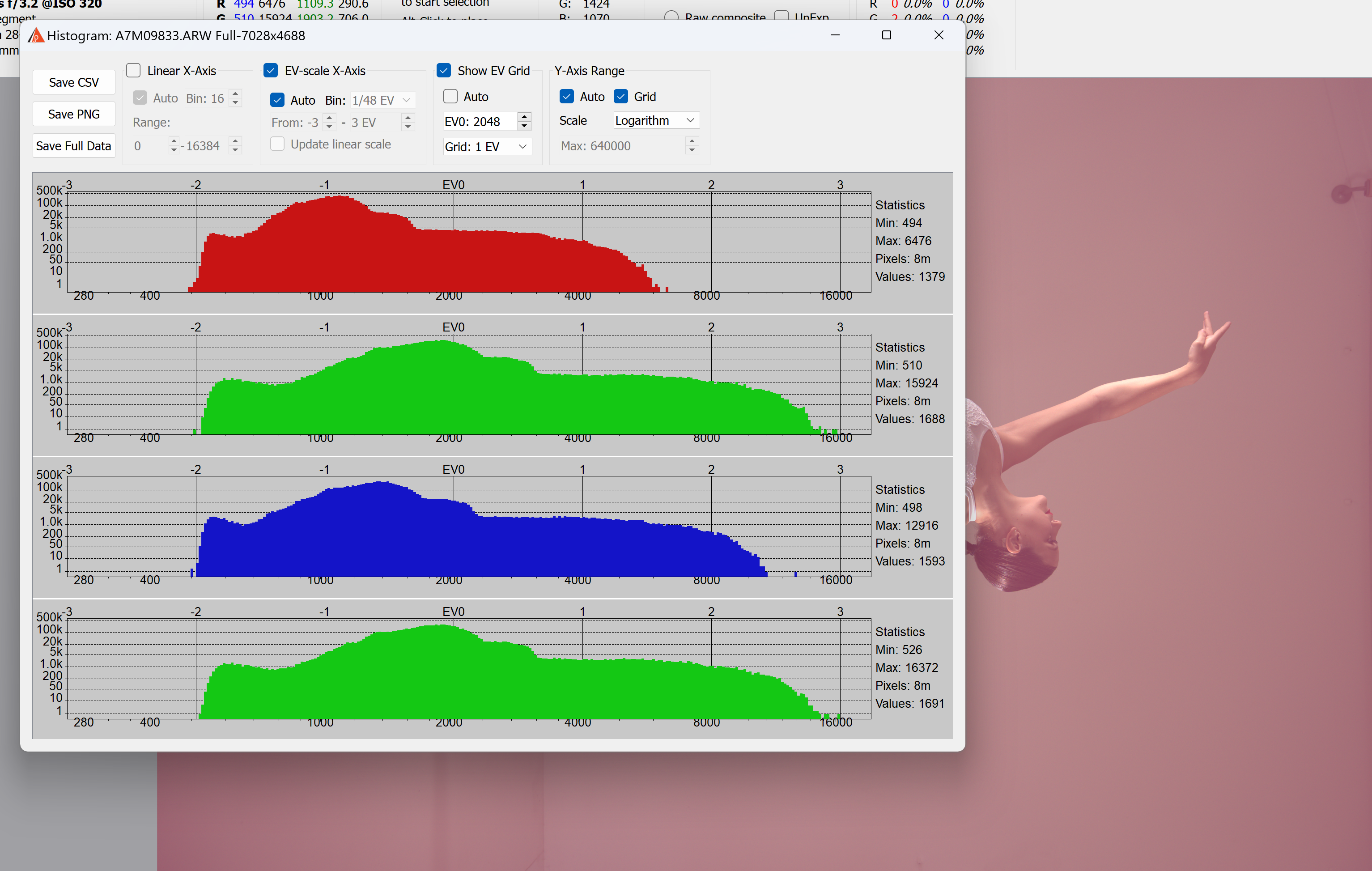

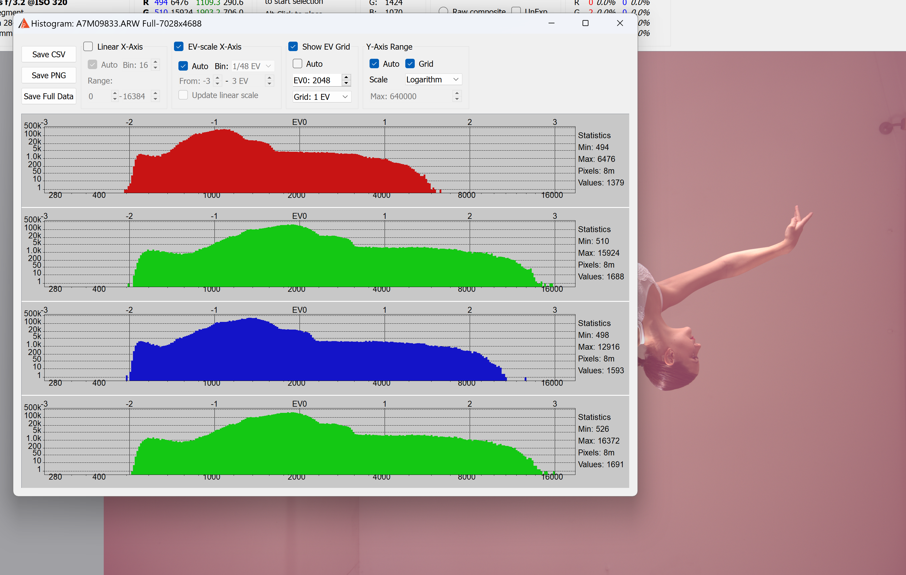

    First off, I didn't say your image could get a 3 stop push. I said that the EV0 marking on the RD x-axis is three stops down from clipping. The question you asked was what the EV0 meant.
    Second, that image is very interesting. When a linear histogram is used, it looks like there is a lot of headroom except for that bright band across the bottom.
    But when you use the logarithmic y-axis, you ca see there is a lot of detail at high x-axis values.
    So it's not underexposed for the ISO used. You want that detail. But in an absolute sense, if you'd shot at ISO 100 and given it 3.2x more light, you'd have been better off from a noise perspective.
    The brightest thing in the image is her underwear. Is that what you wanted?

    "Auto: automatic calculation of grid zero (gray point position) and setting grid step to 1EV. The zero is located at the level that is 3 stops (8 times) lower than the maximum pixel value rounded up (ceiling) to the nearest power of 2. For example, if the maximum value of all pixels in the photo is 3000, then the nearest power of two greater than this value is 4096 and the EV0 value for this photo will be automatically set to level 512."
    This is effectively what JimKasson posted even before Iliah Borg's post.
  • Members 1738 posts
    April 15, 2023, 4:33 a.m.
    You still donโ€™t get it. EV0 is three stops down from the maximum signal level. If we define the maximum signal level as 100%, EV0 is 12.5%. EV0 is not a variable once the raw file is captured. You can decide how much light gets mapped to EV0 by the way you set the camera up before the exposure.

    In the histogram I posted, EV0 is three stops down from 16000, which is about the clipping point for your camera.
