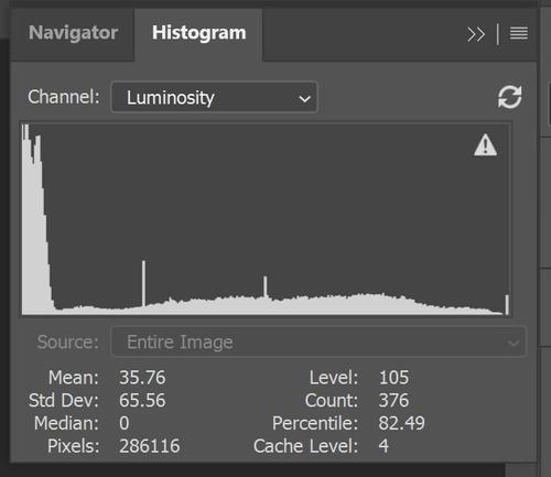

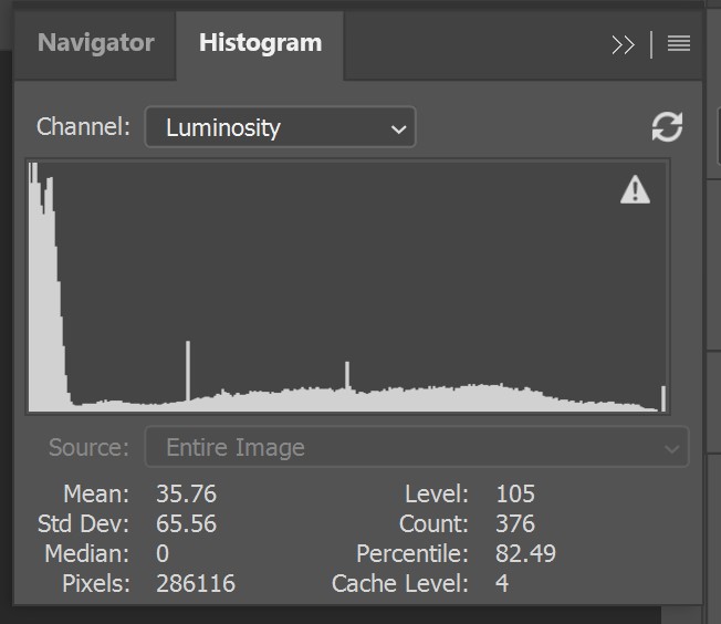

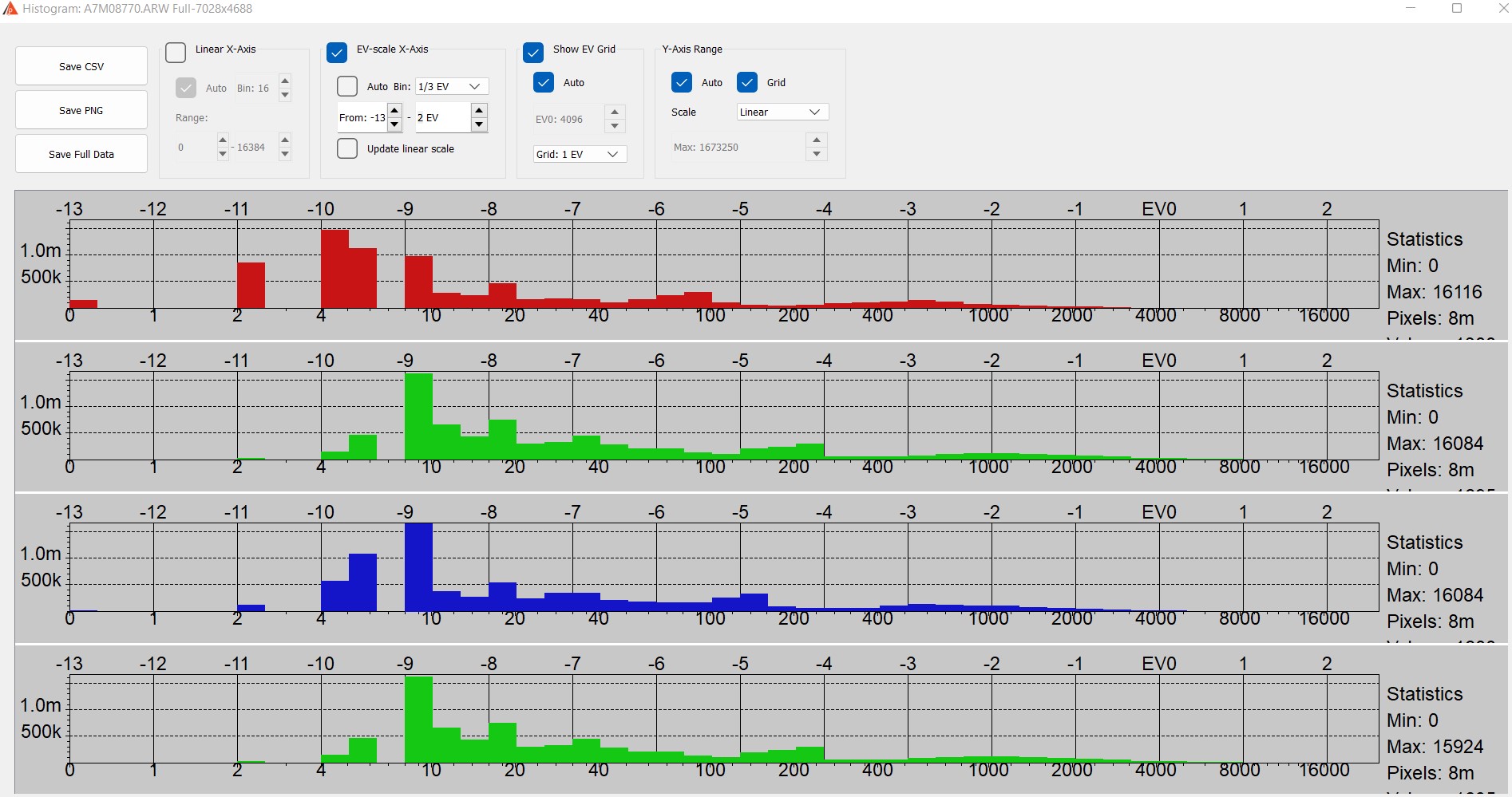

    Anything look familiar. raw digger histogram and Photo Shop histogram
    JPG, 42.7 KB, uploaded by DonaldB on April 15, 2023.
    JPG, 348.9 KB, uploaded by DonaldB on April 15, 2023.
    JPG, 3.4 MB, uploaded by DonaldB on April 15, 2023.

    April 15, 2023, 5:21 a.m.
    The raw histogram shows the reds in the raw data are 2 and a bit stops underexposed. The greens are about 1 stop underexposed and the blues are about 2 stops underexposed.
    This shows you could have potentially added 1 stop of exposure* thus increasing the SNR and then lowering the image brightness in post by 1 stop. This would have resulted in an image with the same image lightness as the image you posted but with less visible noise as per the example explanation in my previous post.
    * exposure - amount of light striking the sensor per unit area while the shutter is open
    ** optimal exposure - the maximum exposure* within dof and motion blur requirements without clipping important highlights.
    *** under exposed - more exposure* could have been added with the DOF and blur constraints still being met without clipping important highlights.

    April 15, 2023, 6:33 a.m.
    Great.
    For the topic name alone:
    Raw histogram is a graph of representative numerical data captured by the camera sensor.
    What data? An amount of saturation levels of individual pixels of the camera sensor. Or vice versa, amount of pixels saturated at each level of possible saturation level. Horizontal plane of the histogram shows you saturation levels, vertical plane shows you amount of pixels saturated at that particular level.
    Therefore left part of the histogram represents dark toned parts in the image, right side shows you bright tones in the image. The fuller the graph is in vertical plane, the more pixels are occupying these saturation levels.
    If the pixel gets more light than what it can capture, it stays fully saturated on it's highest value, and you will see it as a most right value on the histogram, no matter how much more light over the full capacity it received. So if you see a lot of pixels on the most right side, there is high possibility, that the sensor was oversaturated, and the real image information is lost, as it didn't manage to capture this amount of light. RAW histogram gives you means to avoid that for next time, if you take proper action towards that goal.
    It also lets you to saturate the sensor more, if it is less than ideally saturated.
    Most image processing softwares do not show you RAW histogram, they show you either pre-processed image histogram or output result histogram.
    Why does it matter?
    It matters because it allows you to best evaluate and use the data captured. And possibly to capture more data next time. For realistic use, it allows you to best exploit camera sensor resources and capabilities, giving you most image quality to operate with. Using other than RAW data allows for misrepresentation or misuse a lot more, causing you to leave data and image quality unused/ruined.
    For the image posted:
    We have no way of knowing which one is RAW, or if any of these are RAW. There is high possibility that none of these are RAW histograms due to the program used. This program is not a tool showing you RAW histograms. These are the tools to process RAW images, showing you the histogram of the processed output.
    The graph that shows you the peak being cut off significantly, does not allow for all data being presented to you, because the vertical range of the graph is limited. It's the graph display issue, not the captured data issue.
    If anything is unclear, feel free to point that out for further explanation.
