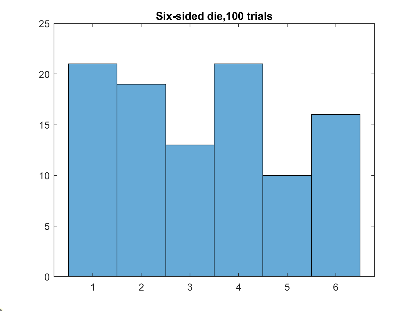

    It is interesting to note that there is no force "trying" to even these out, by looking at previous results. All of the absolute biases of the first 100 rolls remain no matter how many times further you roll the die; they just become a smaller proportion of the total. A "5" is no more likely for roll number 101 than a "4". If you randomly create lottery numbers to play, but forgot to play them and the numbers were picked, there is no rational reason not to play them for the next drawing, but there is also no rational reason to play them again, either.
    When I go into NYC very early in the morning on the first bus, it stops at a Casino, and a lot of people that did an overnight in the Casino get on the bus. I hear some REALLY strange conversation after they get on.
