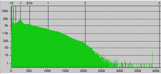

    from P1016721, clipped in all 4 channels, here is one of the greens:
    PNG, 7.8 KB, uploaded by IliahBorg on May 21, 2023.
    May 21, 2023, 1:17 a.m.
    No that is not correct at all.
    If you fill the camera's frame with a near black object containing no whites at all you can still get clipping in the raw data if you leave the shutter open for long enough.
    It is the demosaicing of the raw data and application of white balance plus whatever other number crunching is applied during the raw conversion into an rgb image that sets what is white.
    While the shutter is open, the sensor's pixels are just collecting photons of light from the scene without knowing what the colours in the scene actually are. There could very well be no white in the scene at all and the raw data could still be clipped.

  • May 21, 2023, 2:19 p.m.
    The brief answer is 'everything'. Processed images have little direct automatic relation to raw ones. If you look at processing as a function, the input and output data are completely different data types. The input (raw numbers) essentially represent per-pixel exposure, which is, at least in theory an open ended scale (though the camera sensor and electronics will clip at some point). The output is numbers in a colour space, which is bounded - and represents not how much light there was but how a human observer should see it. So far as lightness (how light or dark it looks) is concerned there is a definite white point, and within the space there can be nothing lighter than that. The white point in default processing is usually quite a way short of the maximum raw number. The spare raw numbers are called 'raw headroom' sometimes, and are what you have in hand if you set the processing parameters yourself and choose a higher white point.
