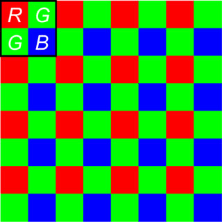

    ok, let's start at the beginning.
    Each pixel on a sensor is covered by either a red, green or blue filter
    source: www.researchgate.net/figure/Color-online-Bayer-filter-array_fig1_311861609 (19 May 2023)
    While the shutter is open each pixel on the sensor collects light photons from the scene. Each pixel will have a maximum number of photons it can collect before becoming full and "overflowing". "Overflowed" photons are not recorded by the sensor pixel, so ideally you don't want to fill up the sensor pixels to full capacity while the shutter is open.
    After the shutter closes the voltage or electrical charge (I always forget which it is) that the photons for each pixel generate is converted to a digital number via whatever internal processing the camera does to output to a raw file for that pixel. For 14 bit raw data that number will be between 0 - 16384 in theory. It will actually be ~16100 for reasons that people like JimKasson, Illiah Borg, Bobn2 will be able to explain.

    in the photocell, a photon may or may not cause an electron to be created. That electron will go into that photocell's capacitance C and thereby increase it's charge Q. This causes the capacitance's voltage V to increase because, as is well-known in Electronics 101, Q=CV .. ergo V=Q/C.
    A bit vague, Danno, not sure that Beginners will get it, sorry.

    So it's the voltage. Thank you 🙂
    I think most beginners will understand what I said. Basically, the voltage from each sensor pixel is eventually converted to a digital number that is allocated to that sensor pixel. It is the collective set of the number allocated to each sensor pixel that is referred to as the raw data.
    For the purposes of the op's query, "I need a definition for Raw Histogram", exactly how the voltage is converted to a digital number is not relevant imo. I am trying to KISS 🙂 since it appears the op is hoping for an easy to understand explanation without too many technicalities.
