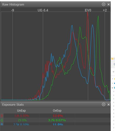

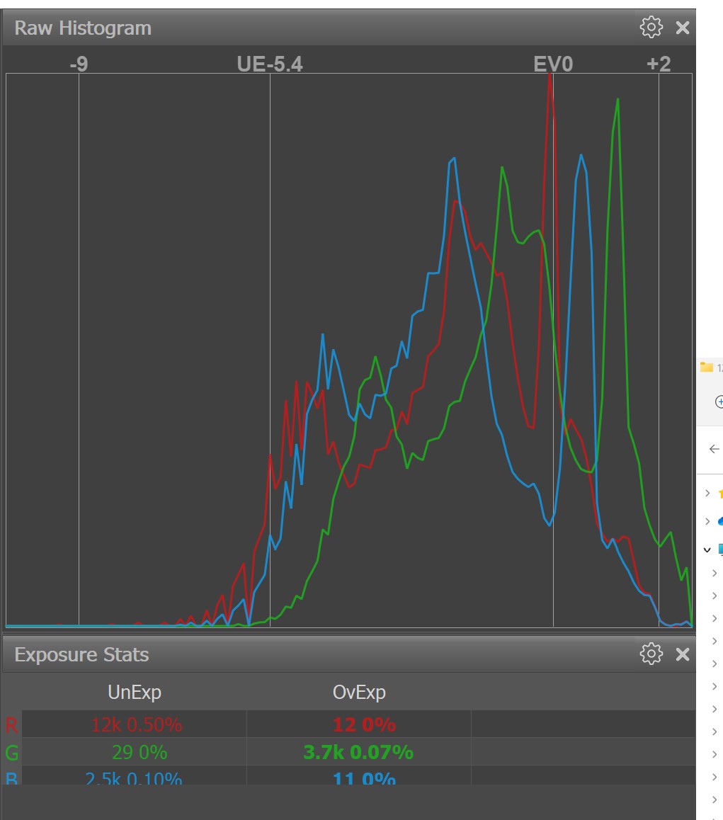

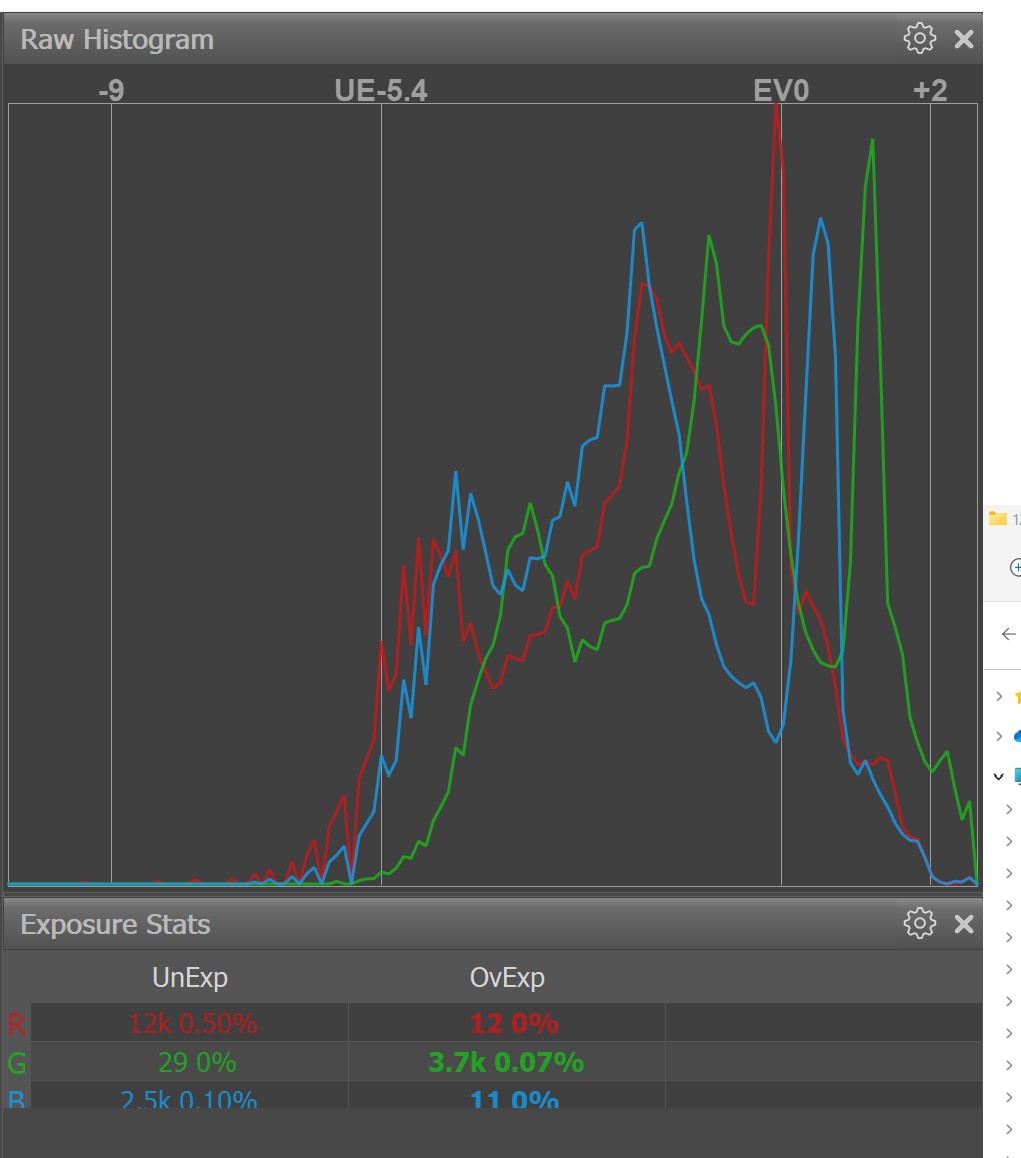

    May 19, 2023, 11:42 p.m.
    I must ask this question. where is everyone getting the idea that incamera histograms are not acurate ? because i just shot some test
    shots with my 12 yold olympus xz1 raw file incamera RGB histogram then took the file into FRV and it again matched the clipping EXACTLY
    so im very suspect that its not true that incamera histograms are not acurate. or maybe its because i buy good quality cameras .
