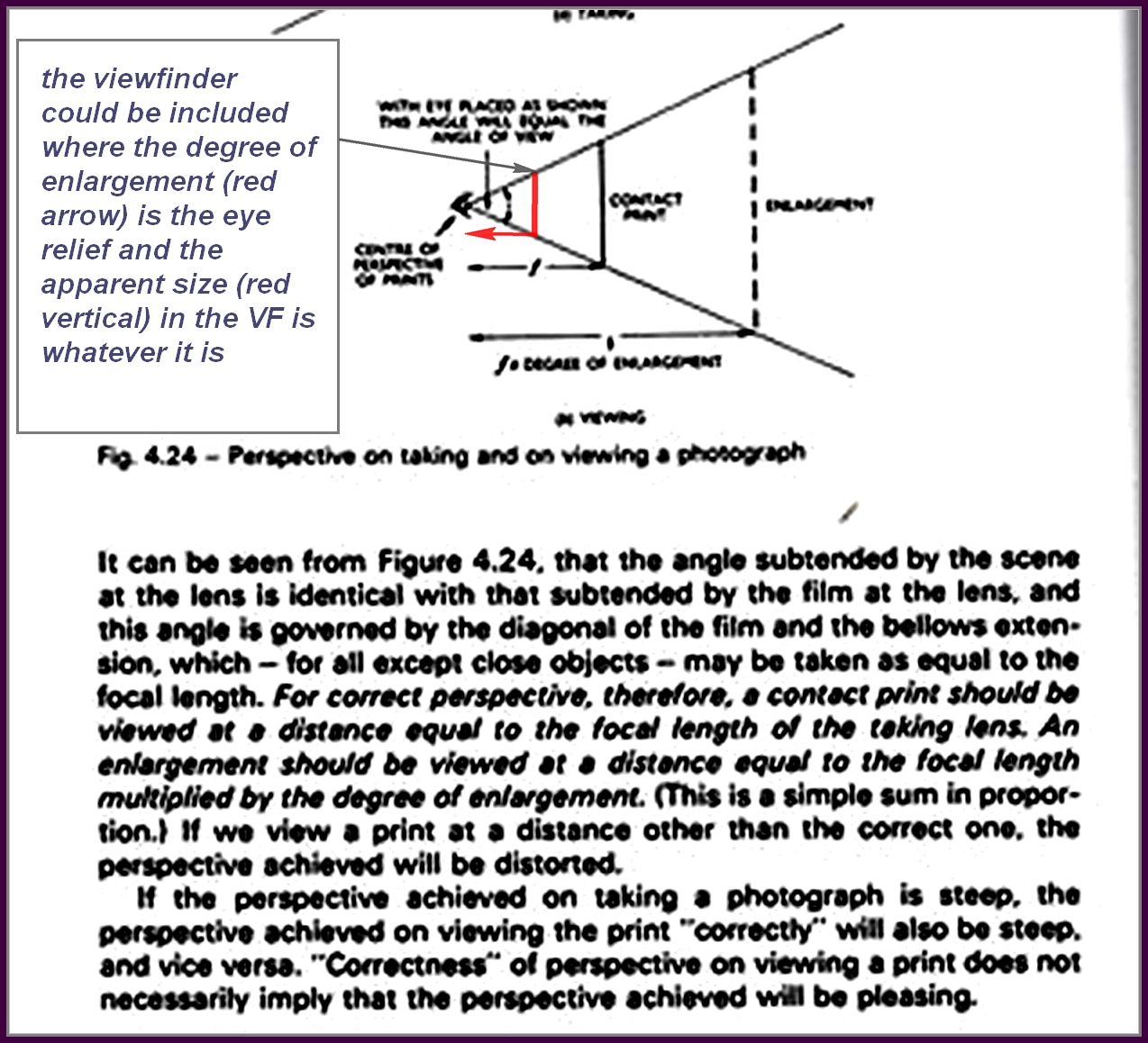

    Thanks for re-posting the above which, to me, clarifies the matter of appearance of a scene in a viewfinder:
    It also covers the case of Sigma's odd-ball "SportsFinder" where what you see is not what all gets captured and also covers a Finder with frame-lines and also covers my Sigma with a viewfinder Magnifier and probably covers Diopter adjustment too.
    A truly Unified Theory !! 😉

    I am not really concerned about the names, along as it is understood that there are two different concepts here and I was talking about both of them. I have understood the difference for decades, it is other people here who may be conflating the two.
    The angle of view of the camera when taking the picture is one thing. It is determined by the size of the sensor and the focal length of the lens.
    The angle of view of the viewer when looking at the picture is an entirely different thing. It is determined by the size of the image being viewed and the distance to the viewer's eye.
    It is a great pity that these things are not taught in photography books and tutorials in the way that they used to be when I started taking an interest in photography in the 1950s.
