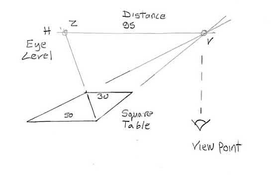

    Out of curiosity, I wanted to track down the mathematics/ geometrical solution to this question.
    This American academics paper explains very simply and clearly the geometrical relationships.
    It is a question of simple similar triangles as I wrote above, which lends itself to a graphical solution on the drawing bord.
    The viewing distance is 95mm in my example off axis at V
    This explains how to make the perspective effect realistic. Now what if we do not want a realistic effect?

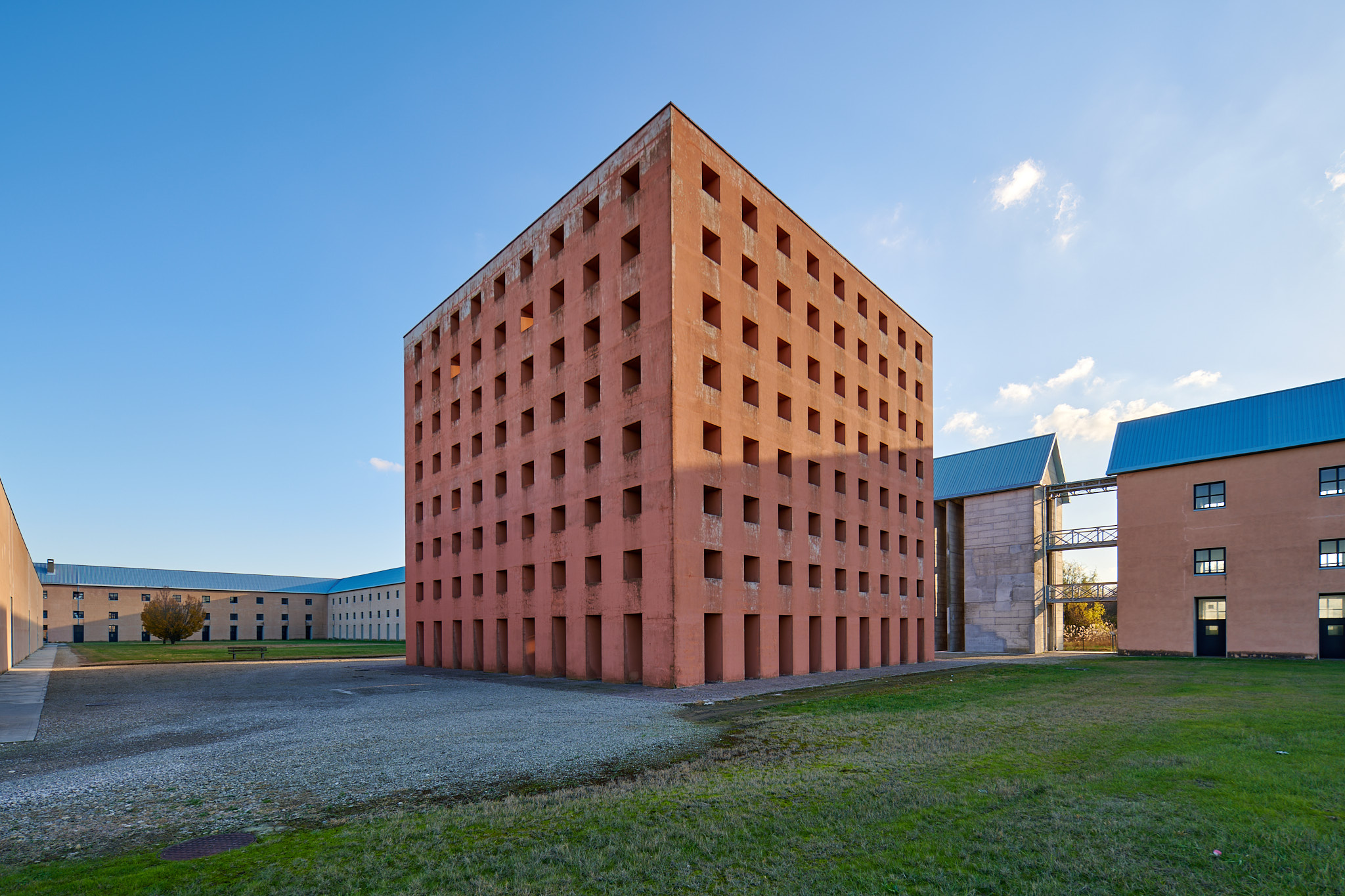

    How do we solve this real life cube?
