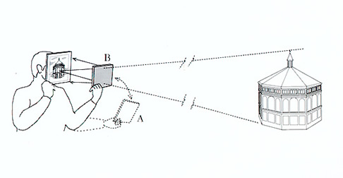

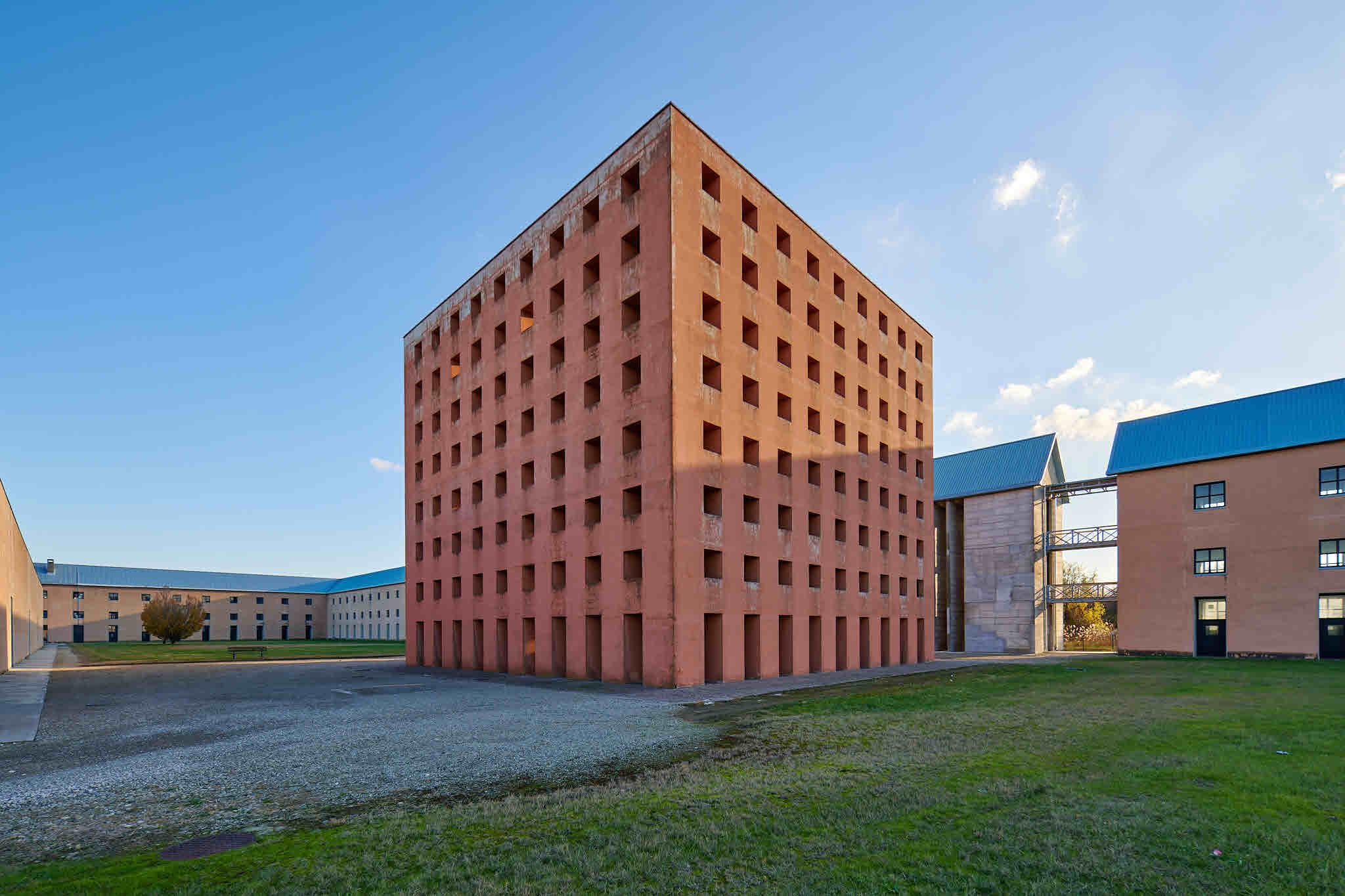

    If I move closer, or further away to the building in the picture below, then the prospective effect on the building ( our subject) will change.
    We can deduce this from Brunelleschi's experiment.

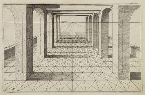

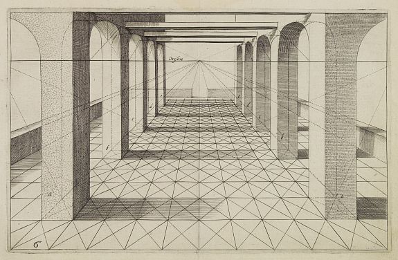

    But for the scene as a whole, in the case below, you tell me. The angle of view of the camera lens remains the same and the perspective effect on the tiled floor remains the same as I move forward.
    JPG, 59.9 KB, uploaded by NCV on April 2, 2024.
    JPG, 20.4 KB, uploaded by NCV on April 2, 2024.
    JPG, 156.6 KB, uploaded by NCV on April 2, 2024.

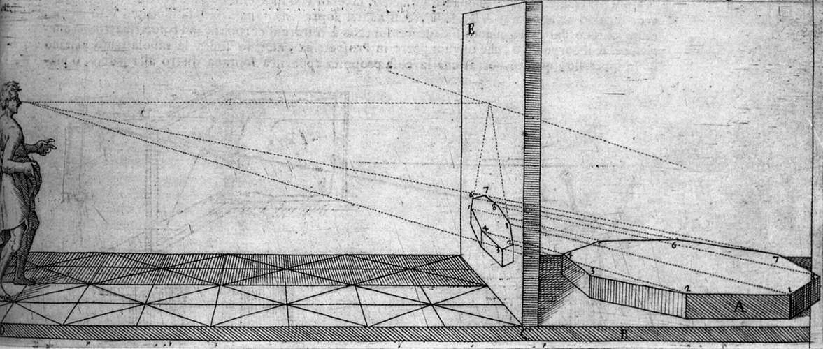

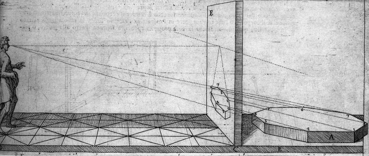

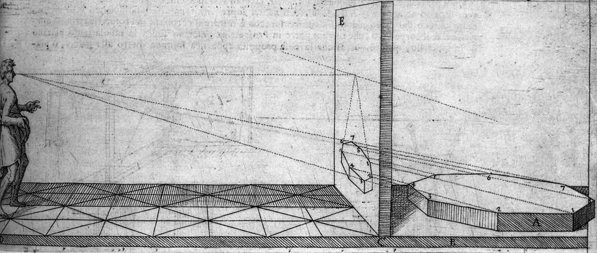

    I rather like the following diagram from Jacopo Barozzi da Vignola (1583) in which a drawing or painting is imagined as transparent and the lines of sight are shown in more detail. When viewed from the centre of perspective, every point in the 2D image lines up exactly with the corresponding point on the 3D object. The position of the viewer's eye is critical.
    It is obvious that if the viewer moves either closer to the image or further away, then the image will be seen with a different perspective in which points on the image cannot all line up with the corresponding points on the object.
    - from Wikimedia
    This diagram works equally well if we imagine that the image is a photograph on a transparent medium. The viewer needs to be at exactly the position of the camera when the photo was taken. It should then be possible to position the image so that everything in the image lines up exactly with the real scene behind it. The viewer's eye is then at the centre of perspective of the photograph.
    JPG, 101.3 KB, uploaded by TomAxford on April 3, 2024.
