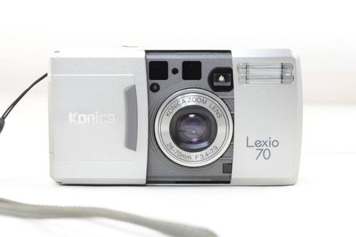

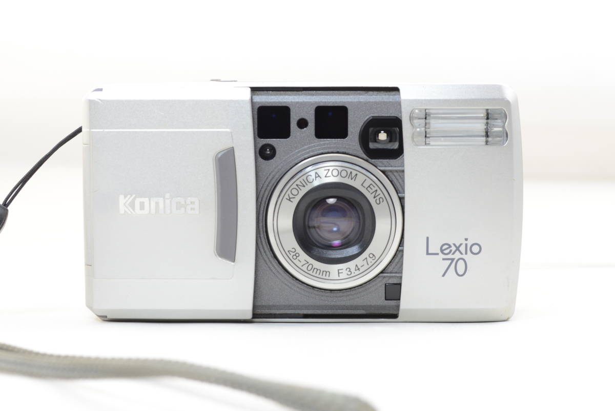

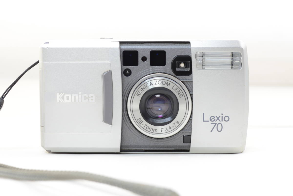

    only relying on the cameras metering atm as she was sick of shooting the full manual 35mm cameras
    where to set the correct exposure you needed to set.
    1: shutter speed
    2: f stop
    3: film speed asa
    4: exposure comp depending on backlighting .which is directly part of asa setting.
    5: if indoors set the flash to all numbers 1,2,3 🙄and distance.
    to her it was a pain in the a.... so i gave my old
    and she loves it. because it is fully automatic including flash. its a quality point and shoot 35mm camera. very sort after buy the young ones. so im interested in her experience with the trip 35 as its not as sophisticated as the konica.
