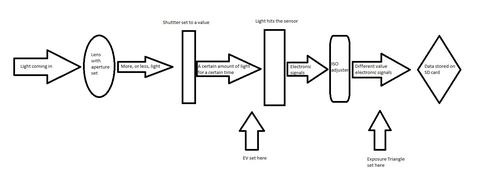

  • April 27, 2023, 9:31 p.m.
    How about this diagram to explain where different camera parameters are used. Feel free to tell me I am wrong (in the nicest possible way 😁)
    JPG, 78.6 KB, uploaded by AlanSh on April 27, 2023.

    Exposure triangle is set before you even take the image not after 😁

    Not really. If the camera was choosing Av or Tv values based on metering, set to ISO 4000, then you have more read noise and more photon noise relative to exposure, than if you had the camera set to ISO 2000. A case where you would have less read noise at ISO 4000 would be where your exposure was standard for ISO 2000, but you had the camera set to ISO 4000.
  • April 27, 2023, 9:41 p.m.
    My diagram is intended to show that the ISO adjustment happens after the light hits the sensor but before it gets stored on the SD card. It cannot happen before the light hits the sensor.

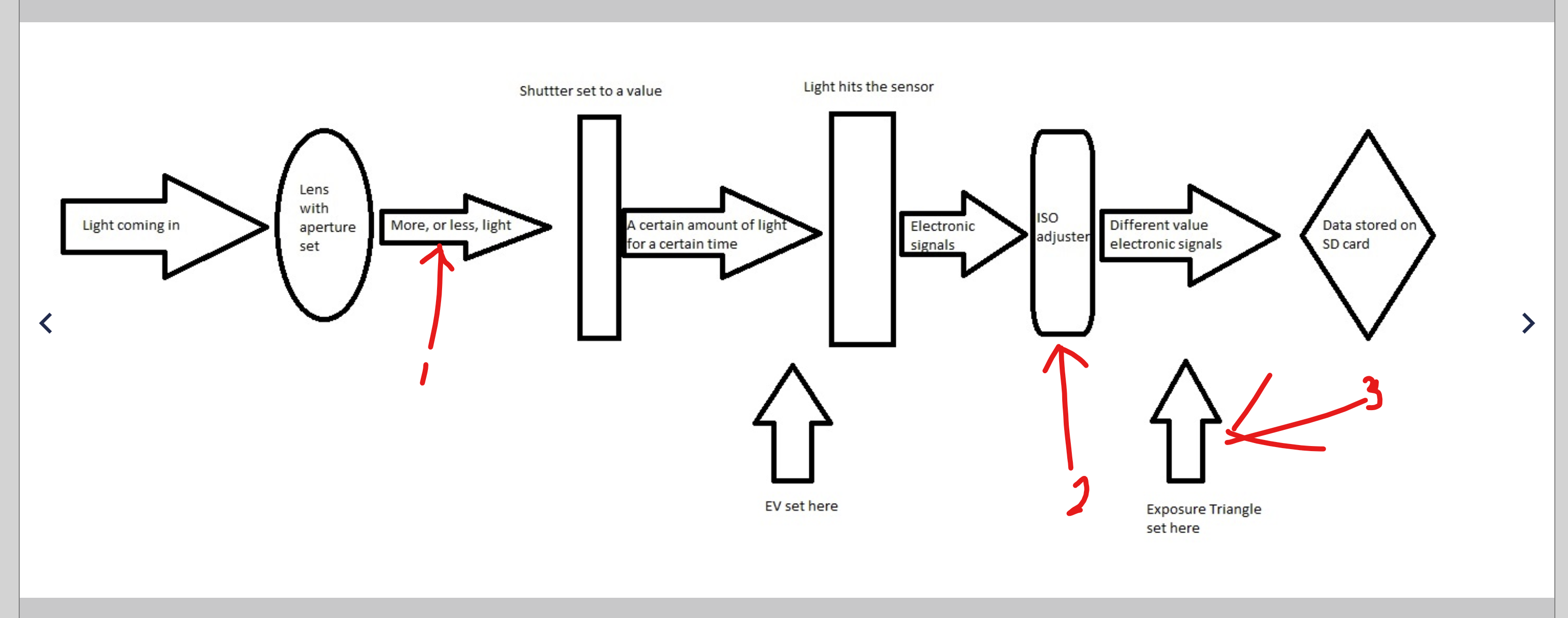

    1) Lens can't put more light on the sensor than came in through the front element. Maybe you mean something else.
    2) Some part of the ISO adjustments can occur before the signals are turned into voltages.
    3) I have no idea what this means.
    It's a pretty diagram. You have elided the conversion to digital. Maybe that was by design.
    Jim
    PNG, 522.0 KB, uploaded by JimKasson on April 27, 2023.

  • April 27, 2023, 9:58 p.m.
    1. I agree. I meant to say 'same or less' - and in reality it must be less as the lens itself will reduce it even at the widest aperture.
    2. But it's always after the light hits the sensor - no matter where after the light hits it. So, I agree with you, but my diagram is meant to show that ISO adjustment doesn't happen before the light hits the sensor and is turned into some sort of electronic signal.
    3. It's meant to show that the "exposure triangle" concept takes place before the data is stored on the SD card - so ISO does have an effect on the end result - bit not on the light itself.
    Does that make sense or have I oversimplified it (or just plan got it wrong)?

    April 27, 2023, 10:02 p.m.
    You are right about after the light hits the sensor, but there are changes that the ISO control causes in dual conversion gain sensors that occur before there's a voltage describing the charge on the capacitor. Maybe you are saying that the charge itself is some kind of electronic signal, but I think that's a stretch.
  • Members 1738 posts
    April 27, 2023, 10:05 p.m.
    If you buy into the ET concept in the first place, the concept influences the photograph before the image is exposed. And not always does the ISO affect the data written to the flash card. Usually, but not always. There are so many different implementations that it's really hard to cover all of them with one diagram.
  • Members 2650 posts
    April 27, 2023, 10:06 p.m.
    the problem occurs if you don't separate photo diode to sensor. the sensor as a whole component integrates amplification circuits, within that iso/gain controls are part of that assembly. eg dual gain circuits. and dare to say even normal iso control.
    I wouldn't call it plain wrong. There are cameras that work the way you've diagrammed, but fewer and fewer of them, these days.
