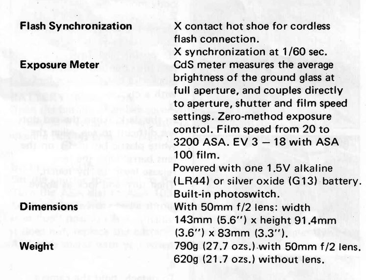

    lets drive the final nail home.
    from the manual of the pentax K1000 the largest selling film camera ever. 3,000,000 sold
    extract from the user manual.

    You haven't driven even the first nail anywhere yet 😂
    And that image proves nothing at all 😄

    The thing about meters in film cameras is that they DID need to know what the ASA film speed was in order to compensate for that when choosing EV. At least they did in the ones I had.

    there's 1 word that describes the whole process . what's the mystery "word" everyone is welcome to guess or do some extensive research.

    Which process do you mean?
    If you mean setting exposure*, I don't care what ISO the camera sets, after setting exposure* as I described earlier, as long as important highlights are not clipped. The image lightness is set in post when maximising the quality of the raw data.
    If your aim is a nice looking jpeg sooc then yes, you should consider setting ISO to output the image lightness you want after setting the exposure*.
    You don't need an 'exposure triangle' to do any of the above, hence the title of this thread "The Exposure Triangle Is Misleading And Unnecessary."

    As I recall the film cassettes were coded to provide this information automatically

    Yes, on later cameras. I certainly remember it on my old Canon 300.
