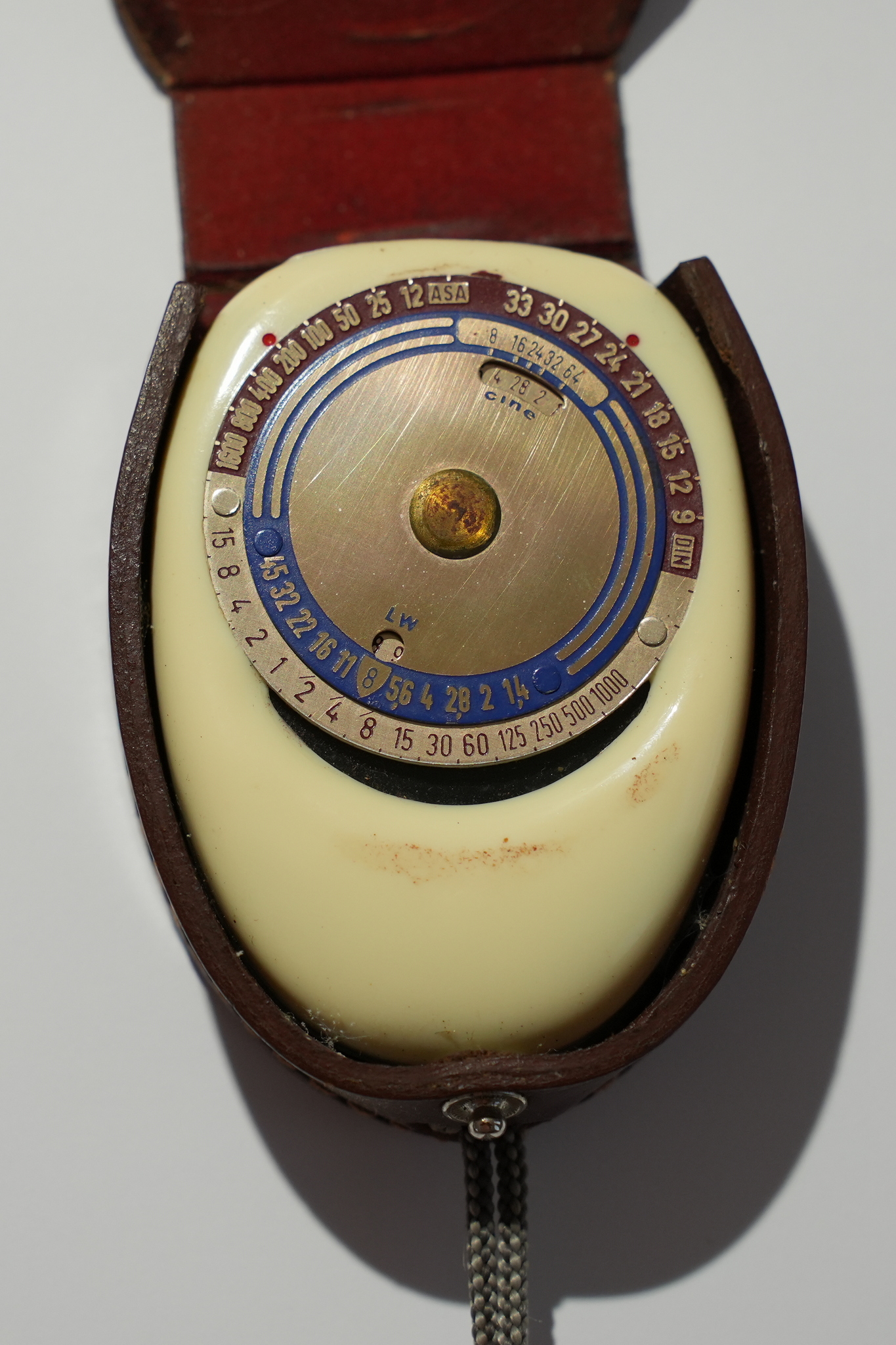

  • Members 2654 posts
    May 12, 2023, 7:10 a.m.
    this is an exposure meter. explain to everyone why its called and exposure meter and not a light meter .
    JPG, 1.1 MB, uploaded by DonaldB on May 12, 2023.
    May 12, 2023, 7:17 a.m.
    But your file name says light meter.
    So even you call it a light meter and not an exposure meter.
  • May 12, 2023, 7:46 a.m.
    It's called both. 'Exposure meter' is a subset of 'light meter'. Specifically a type of light meter designed to help someone set exposure.
    So, how it works:
    ISO is an 'exposure index' - which in layman's terms is a guide to setting exposure. Exposure is light energy density at the focal plane. It is controlled by f-number, shutter speed and scene luminance (how much light is coming from the scene you're photographing). So you set the ISO on the exposure meter to tell it the exposure you're trying to set. It measures the light coming from the scene (hence 'light meter') and tells you the EV (combination of shutter and f-number) that you need to set to get the exposure that ISO says you should set.
