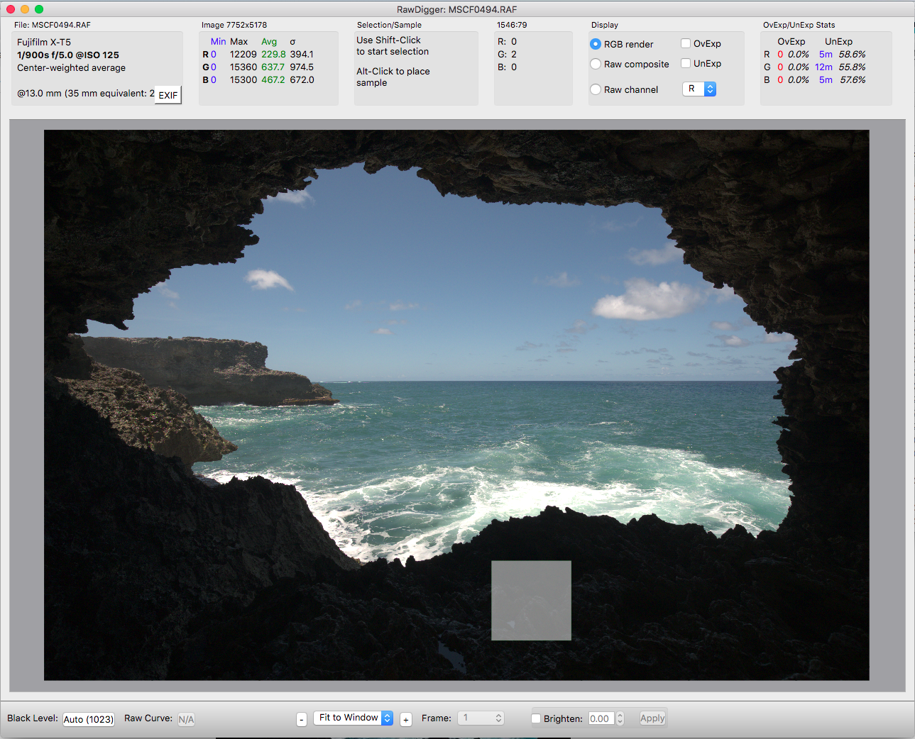

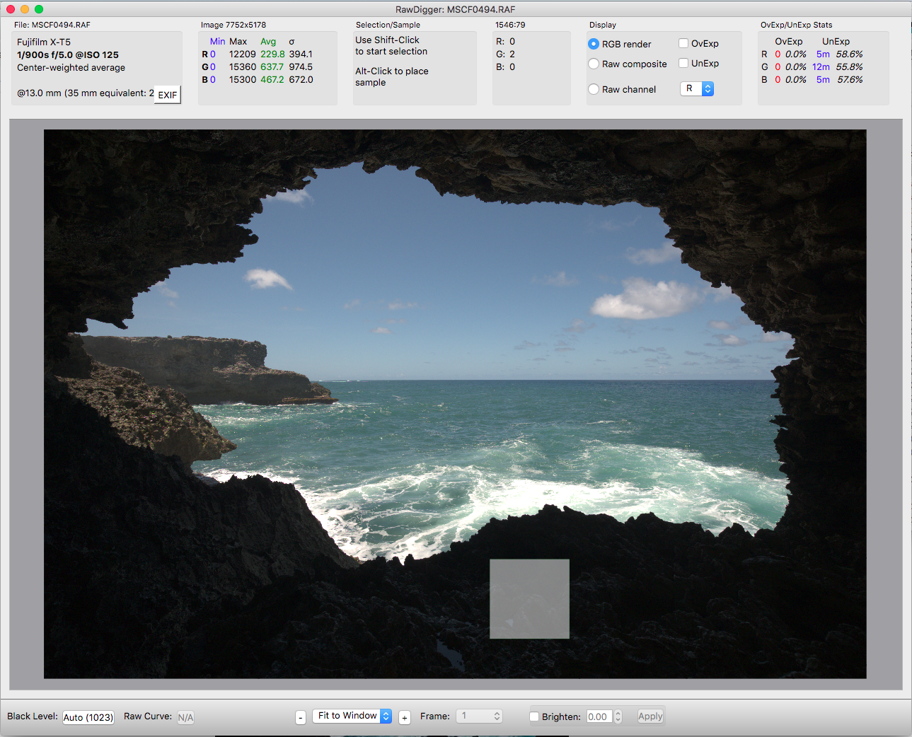

    Yes indeed. On the other hand, you don't need a lot of quality in the deepest shadows in the final photo. Adam's zone system defines Zone I as 'Near black, with slight tonality but no texture' and zone II as 'Textured black; the darkest part of the image in which slight detail is recorded'. So long as you stay within Zone I you can get away with a lot. This image calls for a lift way past Zone II, probably up to zone IV. But in the end, processing your file differently from the default JPEG is what raw is all about.
    I tried downloading, but my raw tools on this computer are too old, so I put it through RawDigger, which shows that there's useful data in those clipped blacks
    Then I exported as a 16 bit TIFF and messed around the the Gimp (I don't use Adobe tools). This is just tweaking the tone curve directly.
    JPG, 11.6 MB, uploaded by bobn2 on March 14, 2024.
    PNG, 2.1 MB, uploaded by bobn2 on March 14, 2024.

    If you did look at the RAW histogram in RawDigger you did see that there's a lot empty at the right end. Alan should have exposed one or one and half stop more and still he did not clip the highlights. Then there was much more details in shadows to lift.

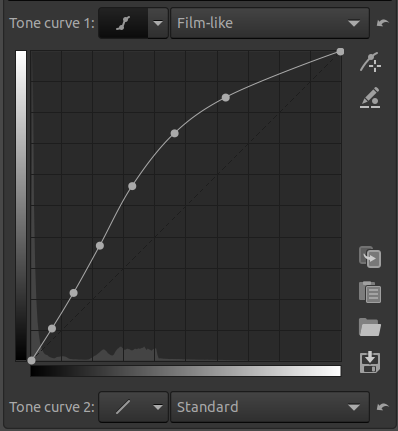

    I agree, it was a quick and dirty effort. Here's one just using RT.
    And this is the tone curve:
    Looked good in RT. Now I see it on the site, I don't like it so much. Hmm.
    PNG, 20.1 KB, uploaded by bobn2 on March 14, 2024.

    Color management problem? Did you set monitor profile in RT's preferences? What is your output color profile in RT?
