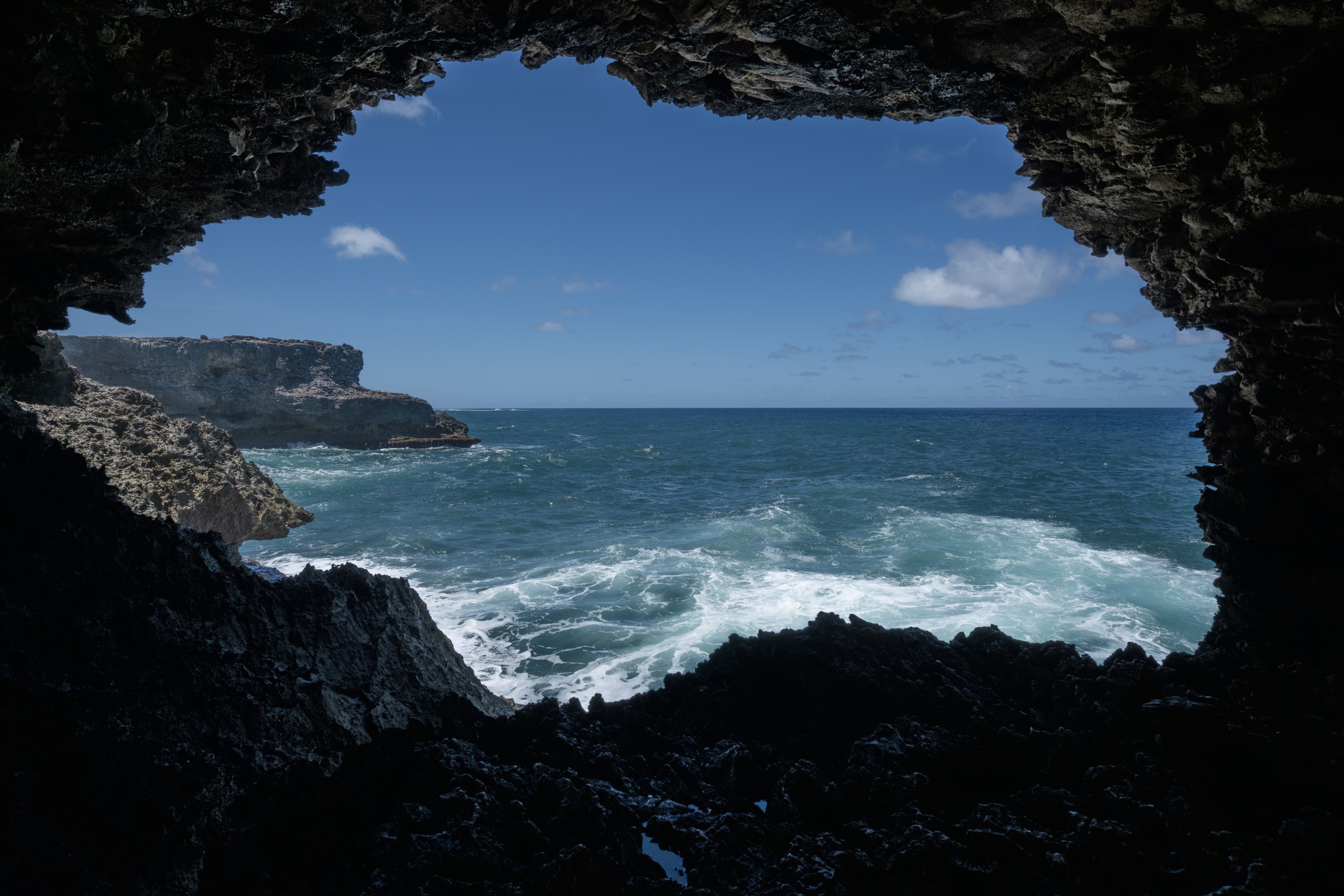

Using Photoshop, how do I get the detail back from the dark areas?

    @TimoK has written:
    Alan should have exposed one or one and half stop more and still he did not clip the highlights. Then there was much more details in shadows to lift.
    It's always wonderful to realise what I "could" have done. But when you are in the middle of a cave, with treacherous rocks underfoot, it's hard to think logically - and not possible to realistically review the image. This is where the picture was taken www.animalflowercave.com/

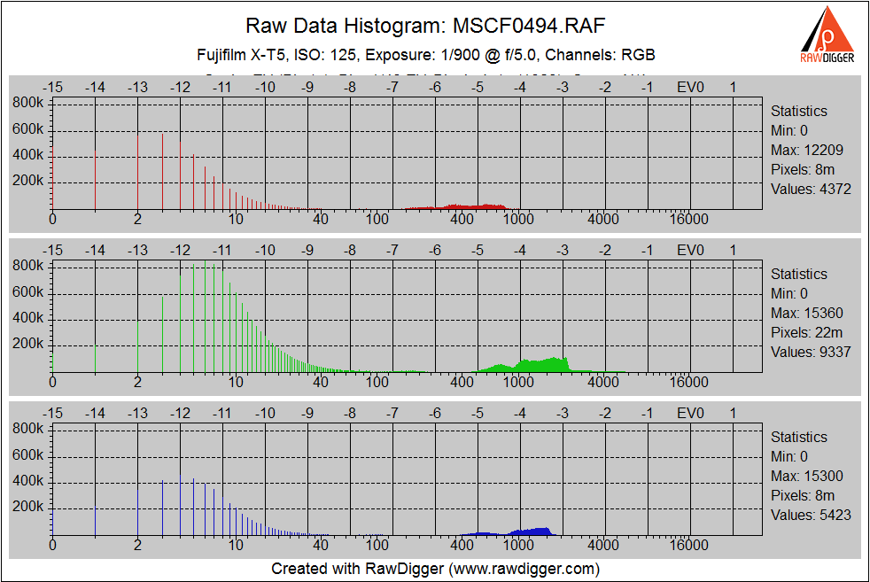

    Edit. I did closer look to the raw histogram of your picture. There is only one stop headroom before clipping. But one stop there is.

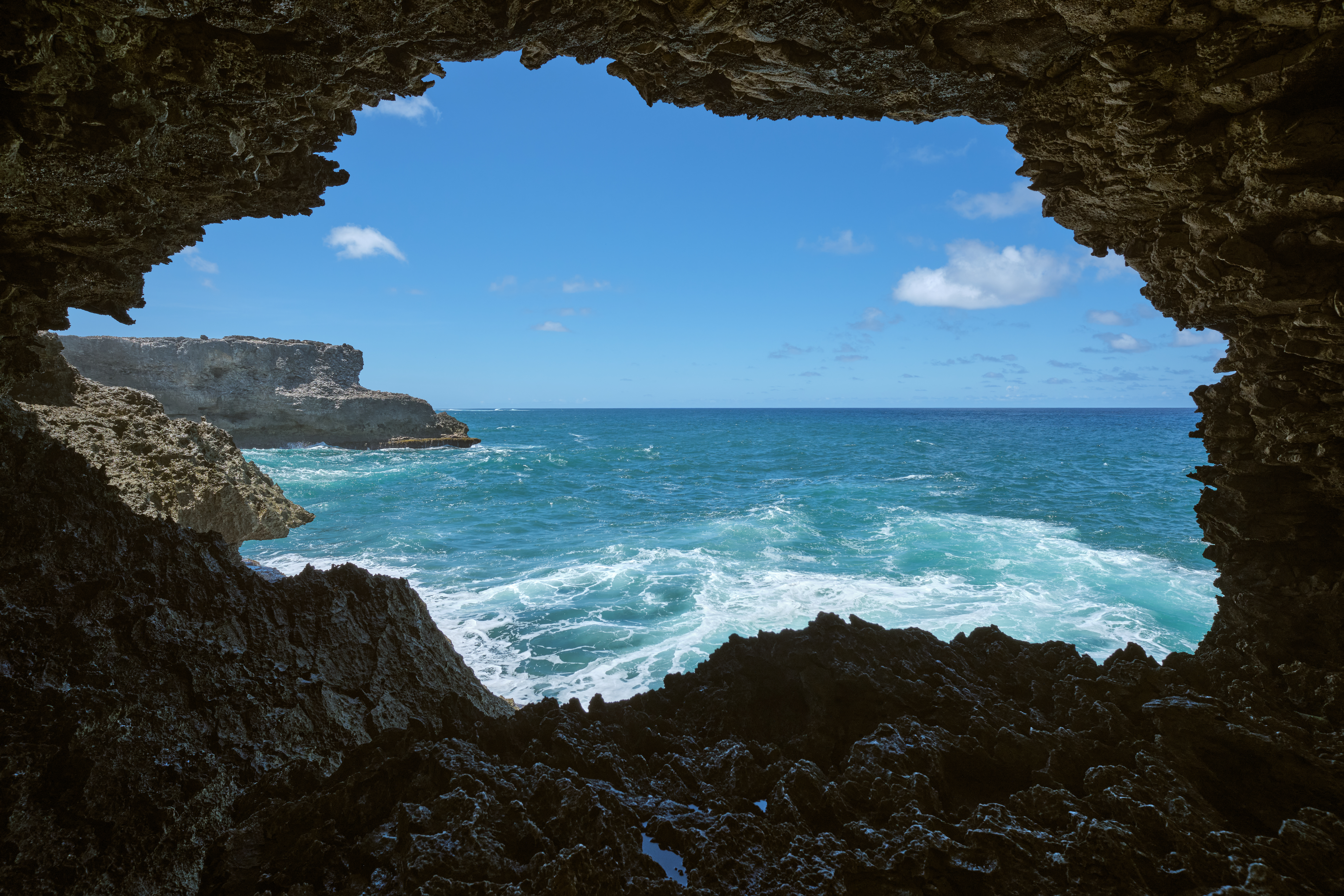

    Here's my take.
    RawDigger raw histogram:
    Exported the RAF file from RawDigger as a 16-bit TIFF.
    Then off to the GIMP using layers and stuff:
    Made a mask for the shadows and it's inverse for the rest. The Threshold function was perfect for that image.
    Edited the shadows with the Exposure function, applied some USM and played with Contrast and Brightness a bit.
    The sky/water had a bunch of dots - something to do with auto-focus, I guess. Toned them down with 1.5px Gaussian blur. Sky color was nowhere near the posted blue, so cranked the Chroma and adjusted the Hue to taste.
    et voila:

    @AlanSh has written:
    I have the photo below (full size if you want to play). I know there is rock detail in the black area but how do i get the detail out without lightening the rest of the picture?
    Thanks for any advice
    I don't have Photoshop but basically I recommend layers and masks to separately adjust the shadows and sky/water, see my quick shot in this thread. Messing around with global whole-image adjustments is likely a waste of time, IMHO.

    @xpatUSA has written:
    Here's my take.

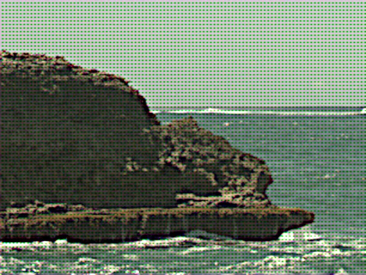

    Why are the distant cliffs chopped up into little squares, with green patches?

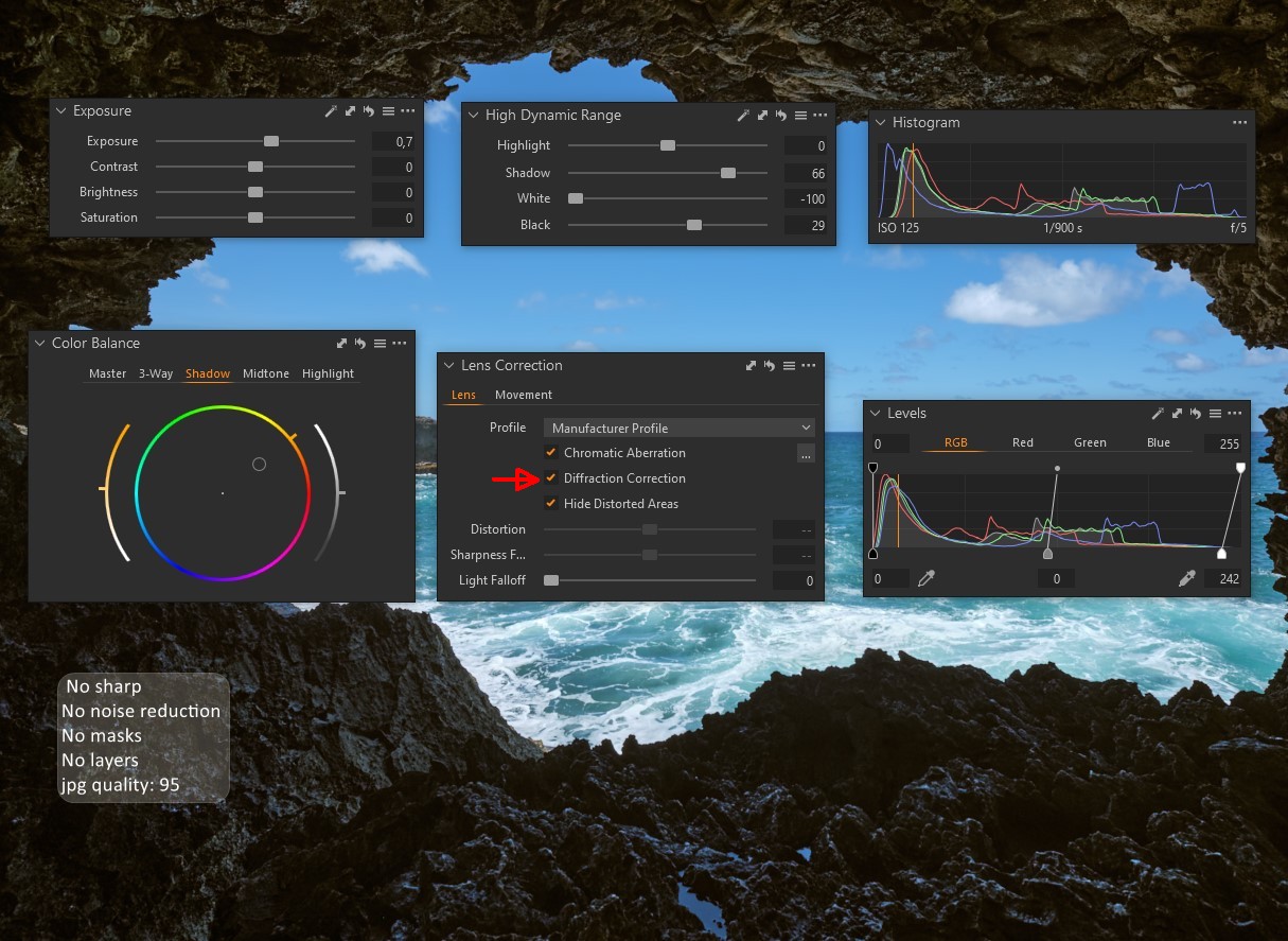

    So, this is my edition with capture one.
    I have no idea without further investigation. Fortunately, the subject of this thread is recovery of the shadow detail and my response was to Alan's "how do I get the detail back from the dark areas?".
    It's LibRaw's conversion of the RAF file to TIFF RGB:
    MSCF0494cropX4.jpgCamera: X-T5/FUJIFILM ISO125 13mm (35mm eq. 20mm) 1/900s 𝑓/5.0
    Somewhat unfair to LibRaw. LibRaw can be used to make conversions as good as you like. It's a matter of the options that you chose when you convert. This camera has the somewhat unusual XTrans CFA, which needs somewhat specialist demosaicking. I'm guessing the RawDigger, which isn't really meant to be a raw processing tool, hasn't gone so far into the XTrans weeds, and hence not made such a good job of it.
    oes anyone have a comment about my shadow restoration?
    Yes, I think the sea is the wrong colour.
    This was my quick attempt in PS - I can do more, but I think it's OK as it is.
