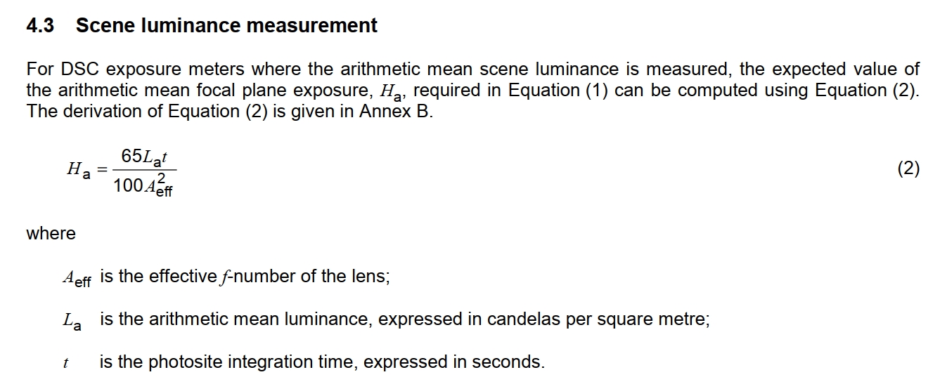

    July 27, 2024, 4:30 p.m.
    ISO 12232 defines exposure, not "different people".
    JPG, 199.6 KB, uploaded by TexasTed on July 27, 2024.
