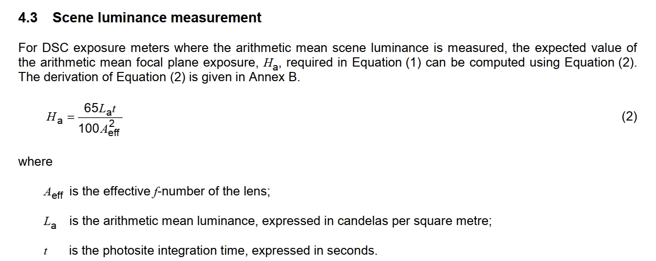

    July 27, 2024, 5:43 p.m.
    In layman's terms exposure is the amount of light that strikes the sensor per unit area during a shutter actuation.
    Some people incorrectly define exposure as being how light or dark an image looks.
    Exposure and image lightness are two different things because for a given scene the image lightness can be altered in camera without changing the exposure at all.

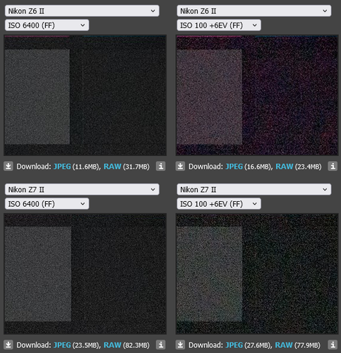

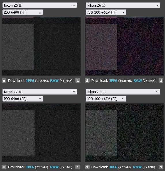

    It makes no photographic sense to compare noise or DR pixel-for-pixel two photos made with different numbers of pixels. We would compare the same proportion of the photo. For example, in the case of 48 MP vs 12 MP, this means we would compare the total noise/DR of 4 pixels from the 48 MP sensor to 1 pixels from the 12 MP sensor (or any multiple thereof).
    So, if a 12 MP downsampled photo/frame from a 48 MP sensor is the same or less noisy (has the same or more DR) as the whole photo/frame from a 12 MP sensor, with all else more or less equal, then, no, more smaller pixels are absolutely NOT at a noise/DR disadvantage to fewer larger pixels.

    Aug. 3, 2024, 11:49 p.m.
    I don't know, Don. How about you quote the portion that states that fewer larger pixels result in a photo with more DR than more smaller pixels, and we'll go from there and/or explain why the Z6.2 isn't mopping the floor with the Z7.2:

    1) How do you know Nikon is manipulating their RAW files?
    2) If true, then why is Nikon doing a better job manipulating the RAW files for their Z7.2 than for their Z6.2?
    Should have led with that. 😉
    Well there you go: crop mode on the A7.4 vs the whole photo of the A6700 uses the same sensor area, thus records the same amount of light for a given exposure, yet the A6700 puts a lot more pixels on the subject.
    My money is on the A7.4, unless you're cropping. For the same number of stacked exposures using the whole of the photo, the A7.4 photo will have the advantage. The A6700 will be able to match the A7.4 by stacking more exposures, but then you could have just used more exposures with the A7.4, so using more exposures on the A6700 is artificially putting the A7.4 at a disadvantage.
