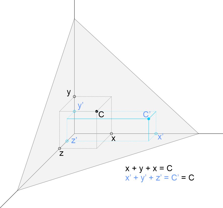

  • April 4, 2026, 10:08 p.m.
    JPG, 46.7 KB, uploaded by ArvoJ on April 4, 2026.
  • Members 1498 posts
    April 4, 2026, 10:42 p.m.
    typo? x+y+x?
  • April 5, 2026, 10:30 a.m.
    Typo of course, sorry.

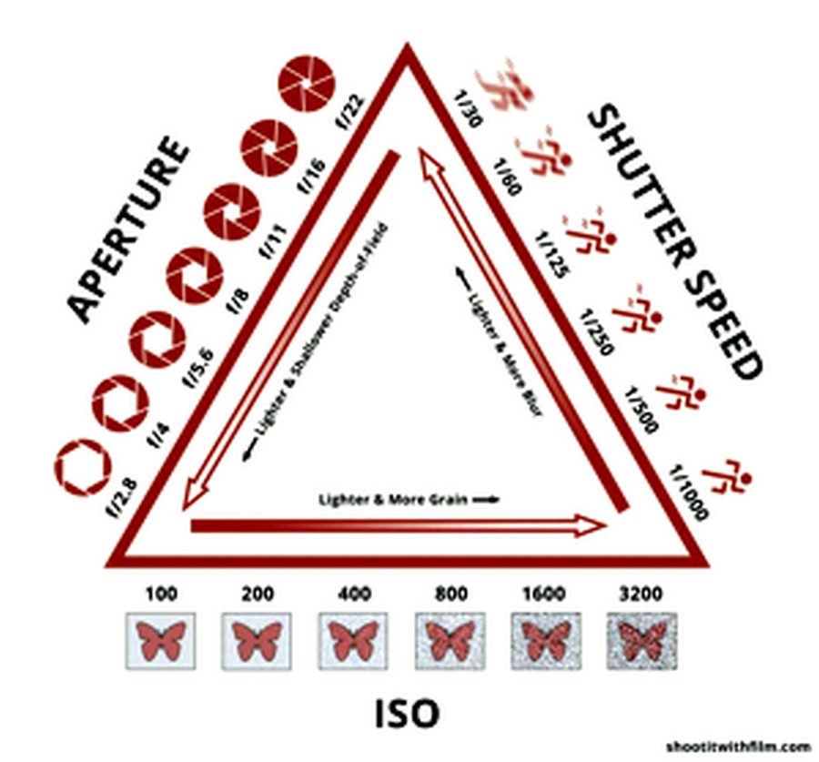

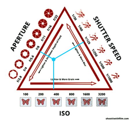

  • April 5, 2026, 7:57 p.m.
    Please, this goes off of even current topic. Assume just anything 'normally exposed', looking good on screen, OK?
    As we here attempt to (re)invent some mathematics of exposure triangle, then the most important thing is to establish relation between input parameters, keeping output (brightness) unchanged.
    Now back to your first triangle, I thought about it a bit more.
    Apparently such triangle is usable for constant brightness (or constant overall system gain, whatever definition suits you better). In graphical form - if you read any point "coordinates" as I draw on next image (blue lines, perpendicular to corresponding sides), then they give three parameter values, giving same brightness for the same scene (1).
    If you need to change brightness (gain) or scene illumination), then you need to shift at least one of the scales (like shift ISO to left or right). In resulting triangle again every point corresponds to same result. (Of course depth of field, movement effects and noise will be different - but brightness remains constant).
    (1) Actually not on current image - you need exactly similar logarithmic scales on every side; this means that they must cover exactly same amount of steps. On your triangle apertures spans over 7 steps, other parameters over 6 - this way relations do not hold.

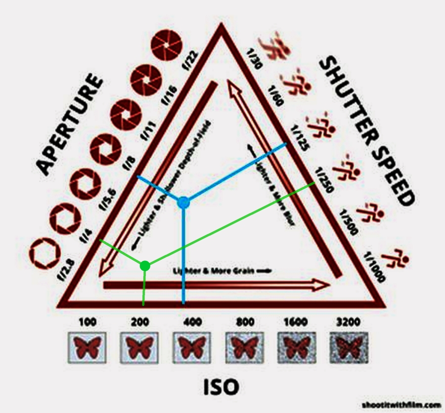

    April 6, 2026, 9:14 p.m.
    So, in this one, the two points blue and green are the same brightness as all the other points inside the triangle, ignoring for now the different stop scaling of the sides?
    JPG, 333.9 KB, uploaded by xpatUSA on April 6, 2026.
  • April 7, 2026, 6:15 a.m.
    Yes.
    On your image (approximately), blue gives f/8, 1/125, ISO 400 and green f/4 (+2 stops), 1/250 (-1), ISO 200 (-1) - result is same.
  • Members 958 posts
    April 7, 2026, 10:50 a.m.
    If green and blue dots represent the same brightness shouldn't they be in the same position on the diagram?
  • Members 2124 posts
    April 7, 2026, 11:33 a.m.
    The combination of these 3 settings for each of these 2 dots gives the same brightness.
    e.g. if you start with one dot anywhere within the triangle and change the shutter speed by +1 stop to make the image 1 stop brighter , and at the same time change the aperture by -1 stop you'll get the same brightness, but the two dots will have different positions. So you'll end up with 2 dots in different places, but with the same brightness.
    In fact all dots within that triangle will have the same defined brightness
    Please note I'm (also) ignoring the "typo" error (already pointed out), that the aperture side on this particular triangle picture has 7 stops, but should really only show 6 stops like the other 2 sides of the triangle)
