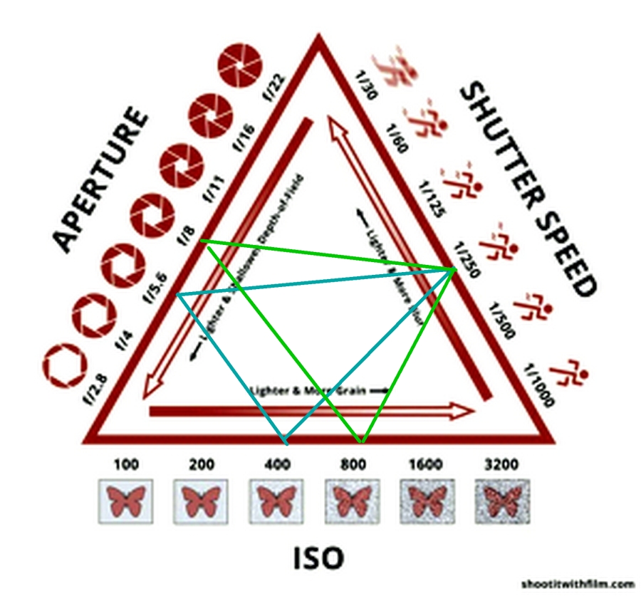

    Indeed it ain't ... here's an illustration with inner triangles added for two "balanced" settings but something doesn't seem quite right ...
    Comments invited ... I really would like to get to the technical basis of the Triangle because it is so easily understood by others and because I still don't quite get it, grump.
    JPG, 270.8 KB, uploaded by xpatUSA on April 2, 2026.

    because your lines are OFF 😊try drawing them more accurate.

    if you draw the lines accurately they will all meet at the centre point of all the triangles.

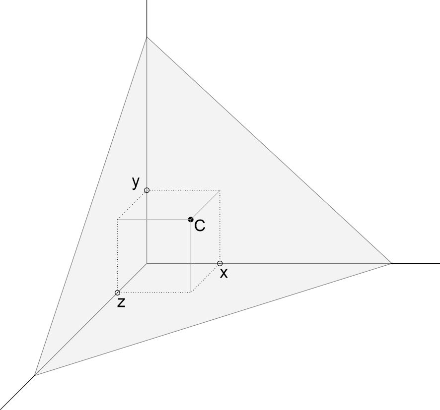

    It is a plane of constant (resulting) brightness, every point coordinates are combination of three values (corresponding to logarithms of S, A and ISO), which give identical result. Intersection of plane and coordinates octant gives us a triangle.
    I marked some point C on the triangle and draw its coordinates x, y, z. These correspond to my previous post variables.
    JPG, 38.6 KB, uploaded by ArvoJ on April 3, 2026.

    Ahhhh, thanks.
    The "constant brightness" was what I was missing. I couldn't see how the plane covered varying lightness. It doesn't. Different lightness, different plane.
    Having said that, my line idea was no better - didn't allow for varying lightness...

  • April 3, 2026, 5:12 p.m.
    Entire idea is not limited to positive octant, it just makes nice triangle there :) Of course plane continues to negative values, logarithms of positive values span range from -∞ to +∞ - no problems with that.
    It is same for your 'normal' exposure triangle - if you choose some parameter outside of range, written there on the sides, then results are also located outside of it.

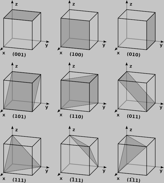

    Miller Indices ... pick one ... 🤔
    JPG, 53.5 KB, uploaded by xpatUSA on April 4, 2026.
  • April 4, 2026, 4:04 p.m.
    Just simple aid to draw coordinates of the point.

    For an exposure triangle, is the point C always at the center of the plane as drawn and as is implied here:
    d2u1z1lopyfwlx.cloudfront.net/thumbnails/c428120c-016e-5b42-a266-07ef5adbf956/fd076613-3660-5025-9227-9b30d41ad718.jpg

    If you are talking about my plane model, then no, entire plane is of constant brightness and we can set point C anywhere - its coordinates (converted to real S/A/ISO values) give always same result. For different brightness you have to shift the plane.
    If you are talking about your linked triangle, then I can't find correct mathematical way to describe relationship of parameters. You can fix one parameter - shutter speed, draw perpendicular (vertical) line from that parameter value, take any point of it, draw two lines, perpendicular to other sides and you get three values, giving you identical result. Unfortunately starting from other sides (A or ISO) does not work this way.
    I would say that your triangle does not give us any mathematically usable basis.
