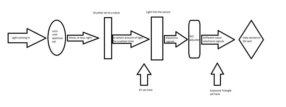

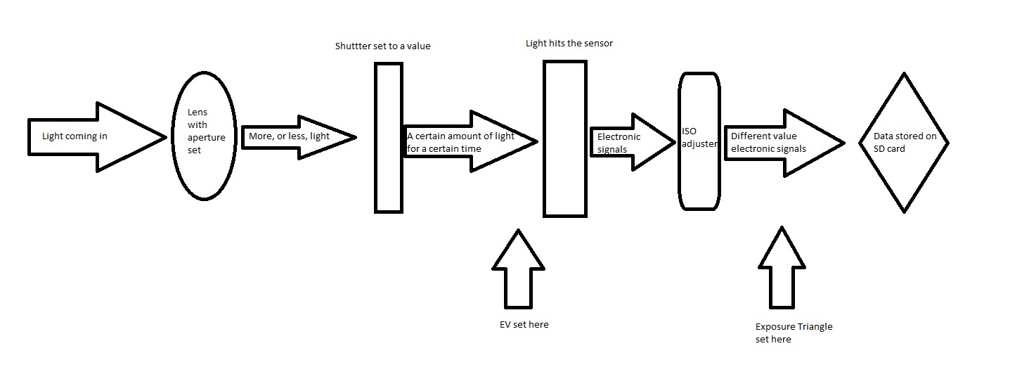

    I think where you show exposure triangle actually amplification happens.
    IMO exposure triangle happens when you set a camera to take a shot. You set three parameters (beside WB) - shutter speed, aperture and ISO values. You can see how changing any of three values is changing brightness of the image by looking at the live view or at the meter. ISO does not change exposure (amount of light hitting sensor) directly, but you have to change SS and/or aperture to achieve appropriate image brightness. Thus when shooting actions you need to use faster SS and in order to do that you have to increase ISO.

    Nice diagram. Does not apply to all digital cameras, e.g. some Sigma/Foveon cameras have no "ISO adjuster", therefore no triangle.
  • March 30, 2026, 3:09 p.m.
    OK, but the live view or the meter are taking the data from the sensor. Yes, you SET the parameters before you take a shot, but they take effect at different places in the light flow. Which is what I was trying to show in the diagram.

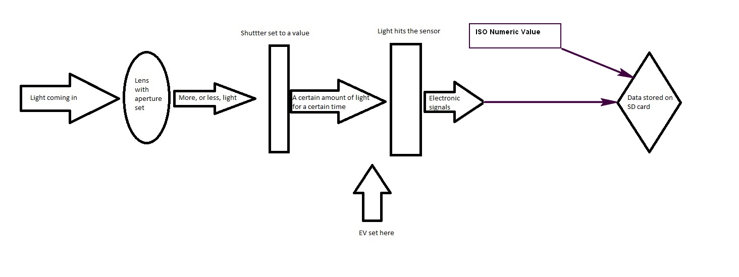

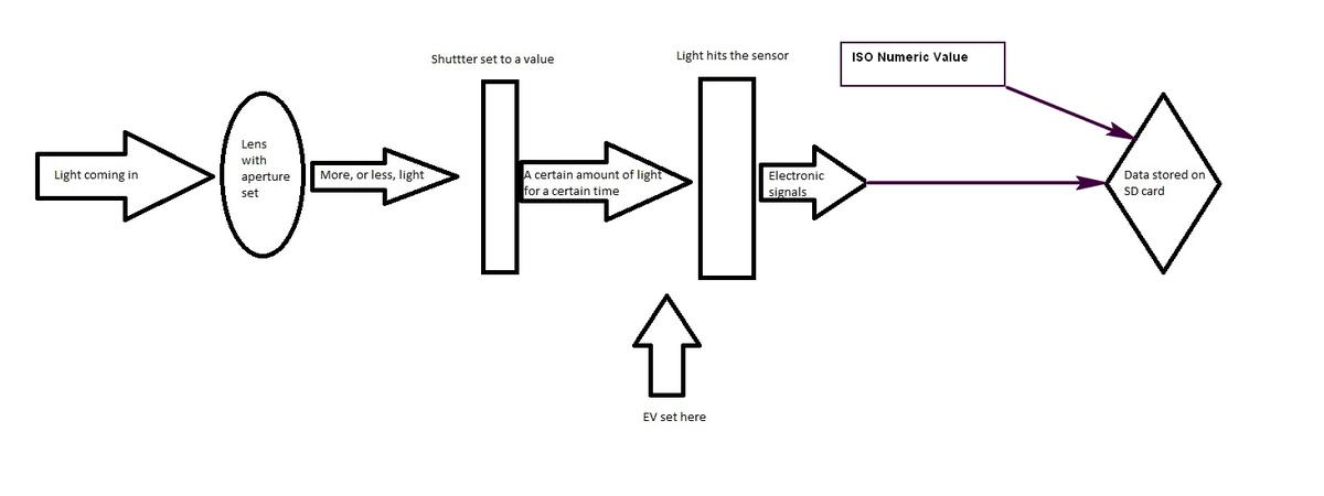

    So you can't adjust the ISO on Foveon cameras? I didn't know that.
  • March 30, 2026, 4:41 p.m.
    Of course you can, but in earlier cameras it was just a tag in image metadata and processing software used data accordingly. Camera internal preview used that too.
    Starting from SD15 ISO value was used to change gain in "Analog Frontend", which is analog amplifier after the readout and before digitizing.
  • Members 1461 posts
    March 30, 2026, 6:01 p.m.
    Per edit below
    Also DP1x, DP2x and all Quattro models.
    JPG, 79.8 KB, uploaded by xpatUSA on March 31, 2026.

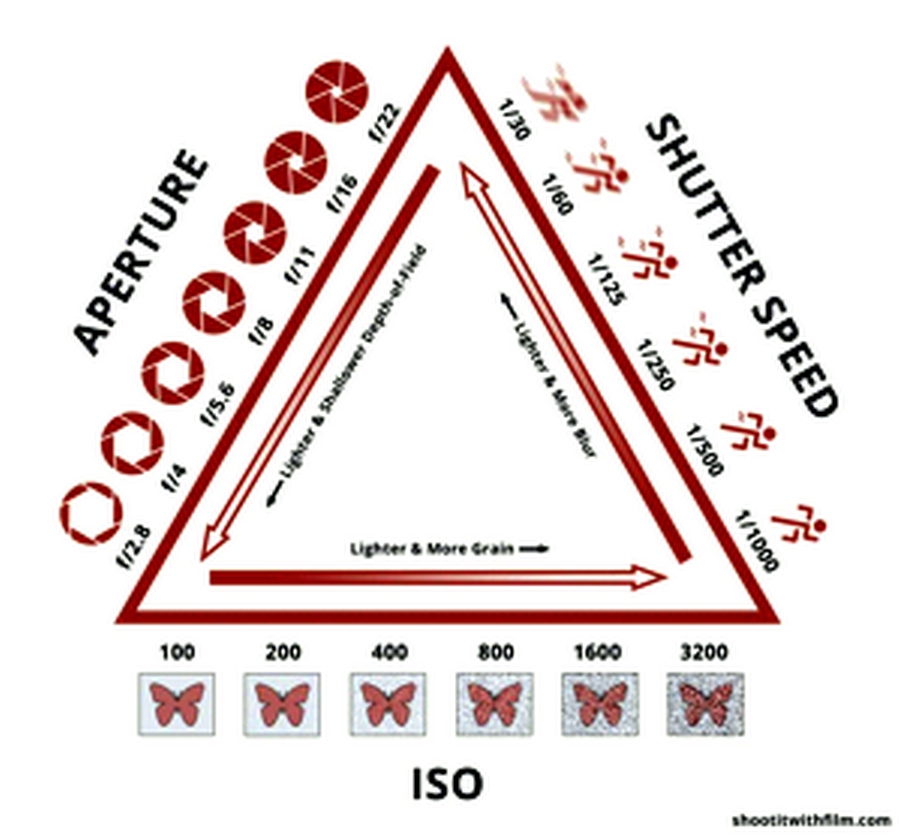

    you dont need to be able to adjust iso to form an exposure triangle eg : 1/30 sec, f2.8, base iso.
    March 31, 2026, 12:58 p.m.
    Trying to find a relationship between side values and inner points of the triangle where lines from the vertices to the sides cross over ...
    Hmmm ... is the triangle "balanced" if the three lines from one set intersect in the same location as another set?
    JPG, 243.0 KB, uploaded by xpatUSA on March 31, 2026.
  • Members 924 posts
    March 31, 2026, 1:19 p.m.
    Why sides? There is one constant thing in triangle - total of all three angles (image brightness). Changing one angle forces change in one or two others.
    March 31, 2026, 1:43 p.m.
    Because the sides are scaled - keeping it vague 😉
    Explains why nomograms are more understandable to the technical mind rather than the vague...

    Say three lines intersect in the middle ,,, approx f/7, 1/200 sec, 500 ISO = about 11 Ev. Say I move the f/# and shutter speed upward "to balance", while keeping the same ISO, say f/16 and 1/60 sec = about 11.6 Ev, so a similar exposure value but a totally different location within the triangle,so that ain't it ...
  • Members 924 posts
    March 31, 2026, 2:34 p.m.
    Make one angle ISO, second angle SS and third angle f stop. Now try to change (decrease) one angle let's say ISO. You will have to increase one other angle by the same amount or other two angles by half of that amount to keep total at 180°.
    March 31, 2026, 3:28 p.m.
    Sorry, not sure what is meant by "angle" in this context - the exposure triangle being equilateral therefore each included angle being 60 deg. Any chance of an illustration or two to help my tired 86-yr old brain?
  • Members 924 posts
    March 31, 2026, 3:45 p.m.
    This is to illustrate the relationship between these three parameters. By changing one angle (parameter) one has to change one other or two others to keep total which is always the same 180°
    March 31, 2026, 3:52 p.m.
    No illustration ... so unable to visualize your "parameters" ... I fold.
    I've yet to find a triangle whose inside angles don't add up to180 deg, so obviously I don't get it.
  • March 31, 2026, 5:08 p.m.
    Can you let your ChatGPT friend to visualise it?
    Google search AI gives strong hint: The equation x+y+z=C represents a plane in three-dimensional (3D) space.
    Visually it is tilted plane through three points (C,0,0), (0,C,0), (0,0,C), in positive octant (x, y, z ≥ 0) it looks like triangle. Exposure triangle, if you want :)
    Why this equation?
    In short and wihtout constants, S * A * ISO = B, where S is 1/shutter speed, A is relative aperture (F/aperture), ISO is ISO value and B is resulting brightness.
    Taking logrithm (as all components are actually exponential in nature), we get
    log(S) + log(A) + log(ISO) = log(B)
    Assuming we strive for constant brightness and substituting logarithms with x, y, z and C correspondingly, we get
    x + y + z = C
    You may draw it out now :)
