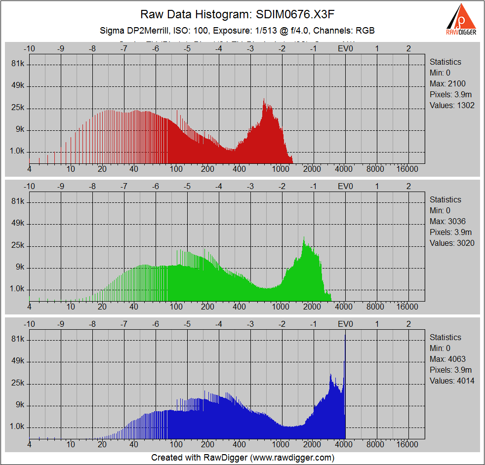

    Perhaps mfgs fear that raw histos would lead to bad images by the average punter. Faced with this ...
    yes, it's log-log
    ... many would go "eek the blue is badly blown - must seriously reduce exposure" and end up with an image way too dark, followed by whine, whine, whine and the camera returned quickly to the store.
    On the other hand, an average punter would likely produce this with the "normal" histogram and be delighted
    Embedded JPEG from the same raw as above:
    To certain members: please excuse the inclusion of a graph and mention of logarithms.: feel free to comment of course, but don't expect a response from me ...
    JPG, 678.8 KB, uploaded by xpatUSA on May 18, 2023.
    PNG, 45.0 KB, uploaded by xpatUSA on May 18, 2023.
