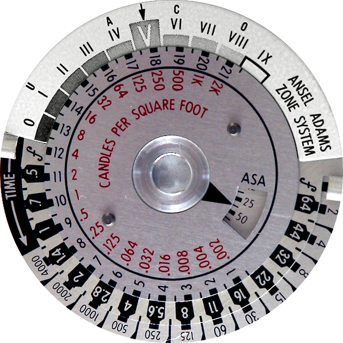

    Sorry, I didn't quite get that - unless the previous dial image is included and it's 37.5 ASA setting is accounted for.
    Maybe I missed something ...

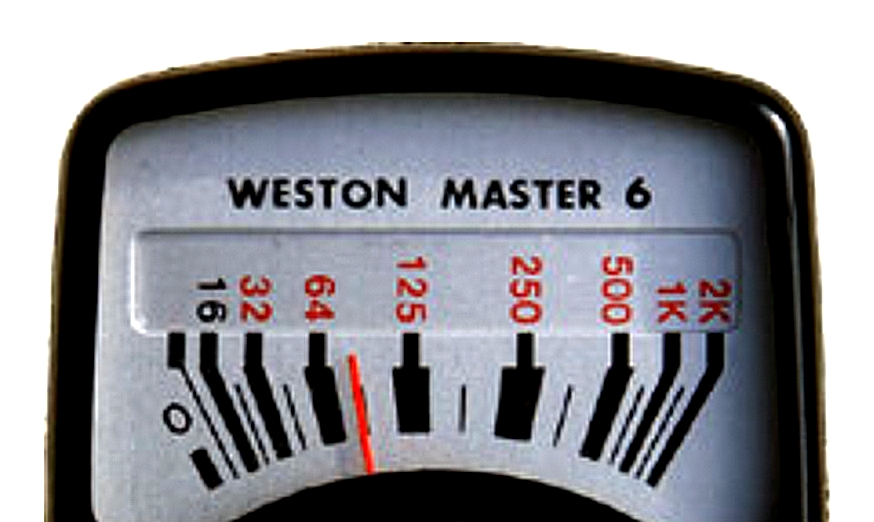

    I am duly saddened that my post makes no sense and I am confused by the sudden introduction of your spotmeter, the which my Weston Master 6 is not. Also I would like us not to refer to various values on the 1-21 scale thereby cutting down on obfuscation.
    So, starting over with the palm of your hand on a 7200 fc sunny day, let's say the meter reads 800 candles/sq-ft.
    So then, if you just align Zone VI with the 800 candles/sq-ft needle value, all should be well, should it not?
    I'm not trying to do a "Danno" on you. May I ask if the above in bold is technically correct or not? If not, why not?

    Out of interest as regards selenium sensor aging, I just compared the Weston with a Sekonic L-398M ... 250 fc versus 160 fc respectively - almost 2/3 EV difference.
    Didn't bother to put the flat thing on the Sekonic, it wasn't handy, so the difference might have been more or less.
