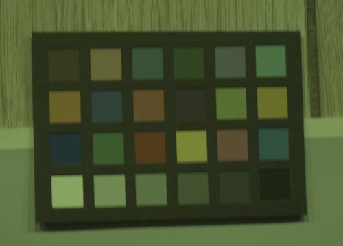

    The posted image was converted from a TIFF which looked no different on my computer. The TIFF was a raw composite with no conversion whatsoever. Therefore, I fail to see your point, sorry.

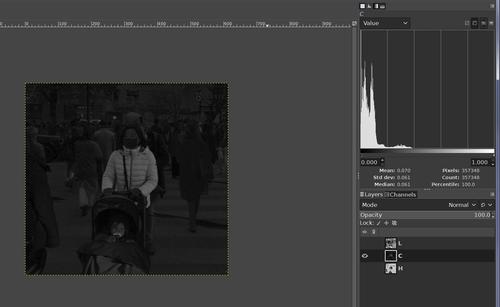

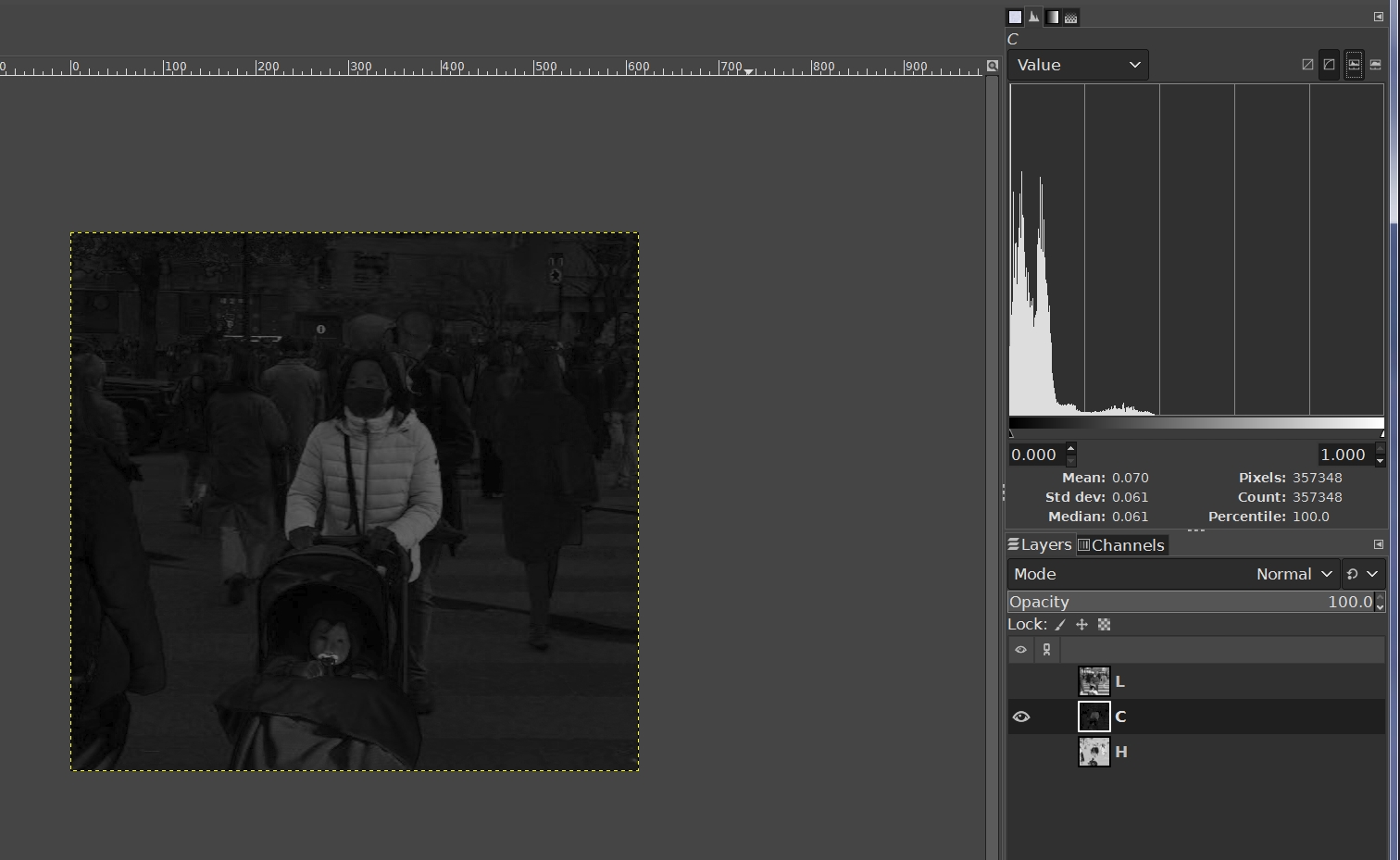

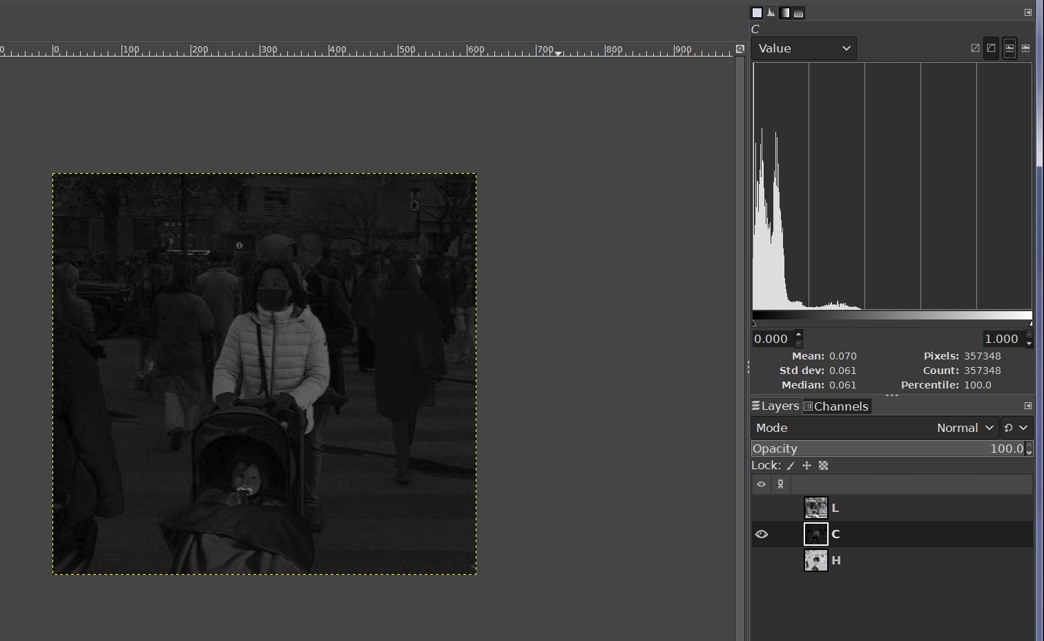

    For what it's worth, here is the chroma level extracted from the above:
    Certainly the red red jacket got rendered with lots more saturation than it's surroundings, whether true to the scene or not ...
    JPG, 291.3 KB, uploaded by xpatUSA on March 20, 2024.
