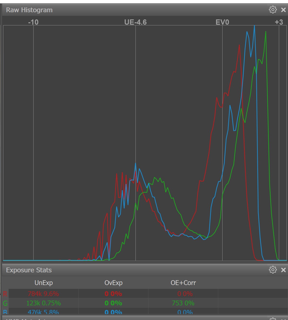

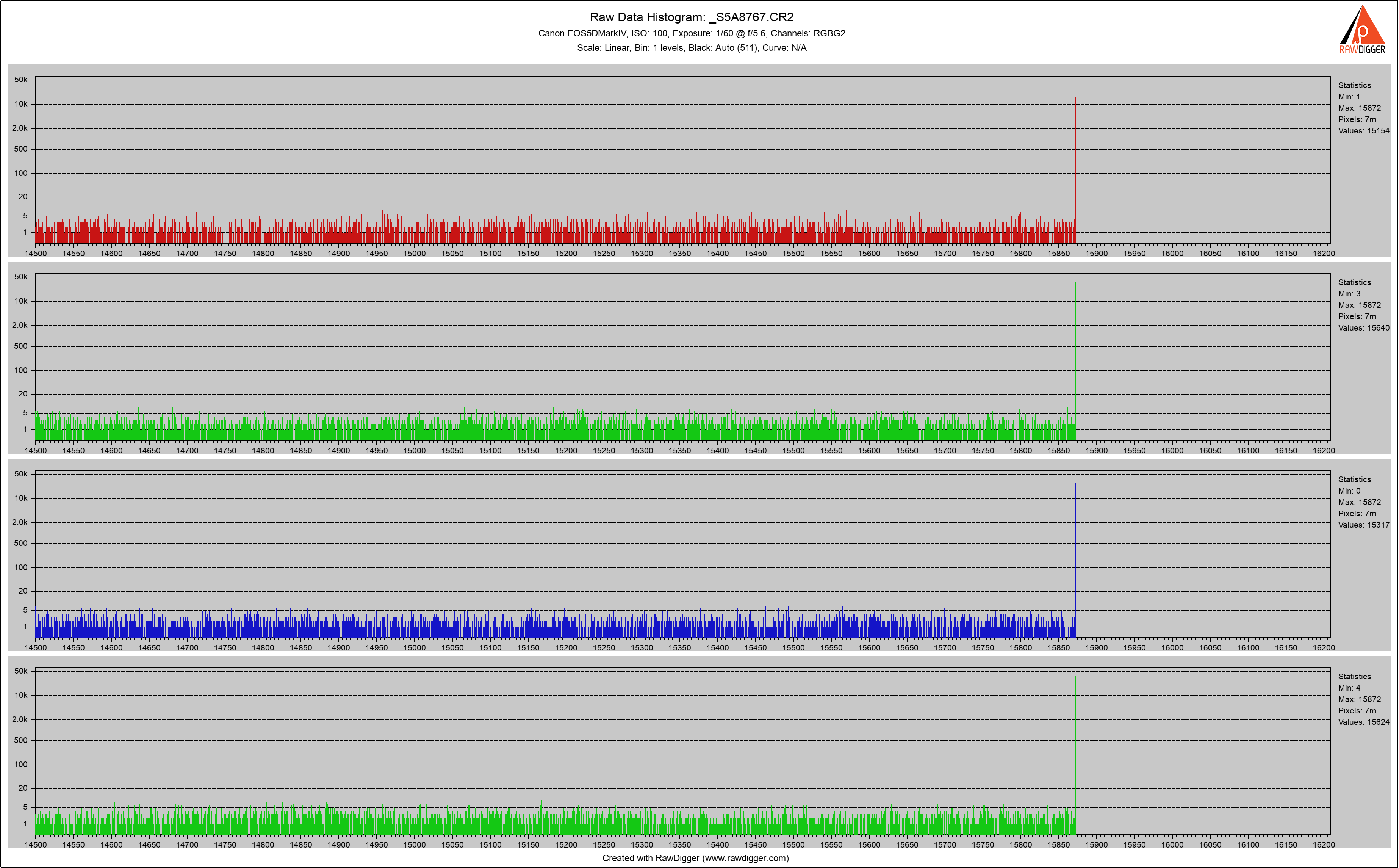

    Here is how clipping looks like on a raw histogram:
    PNG, 182.9 KB, uploaded by IliahBorg on May 10, 2023.

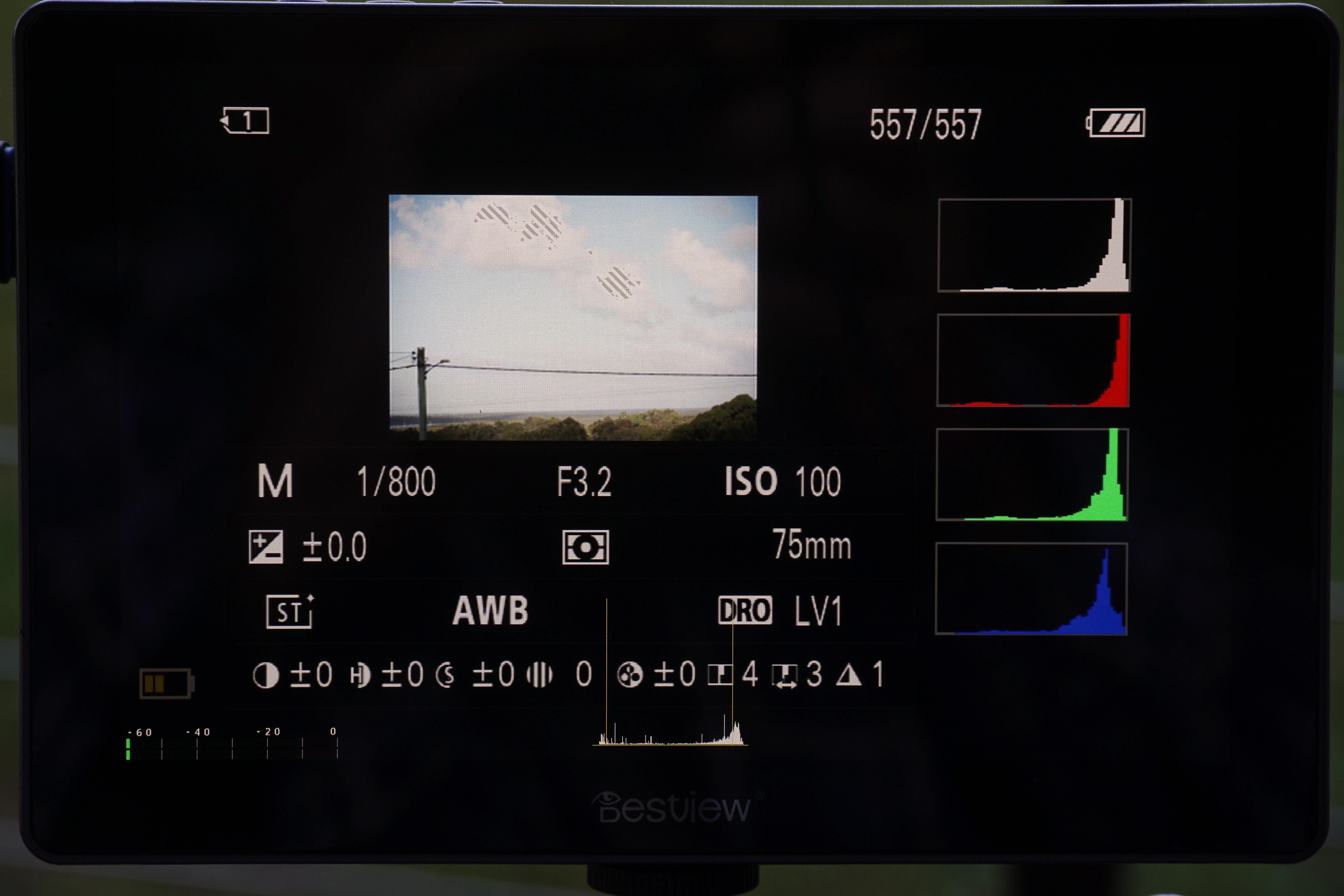

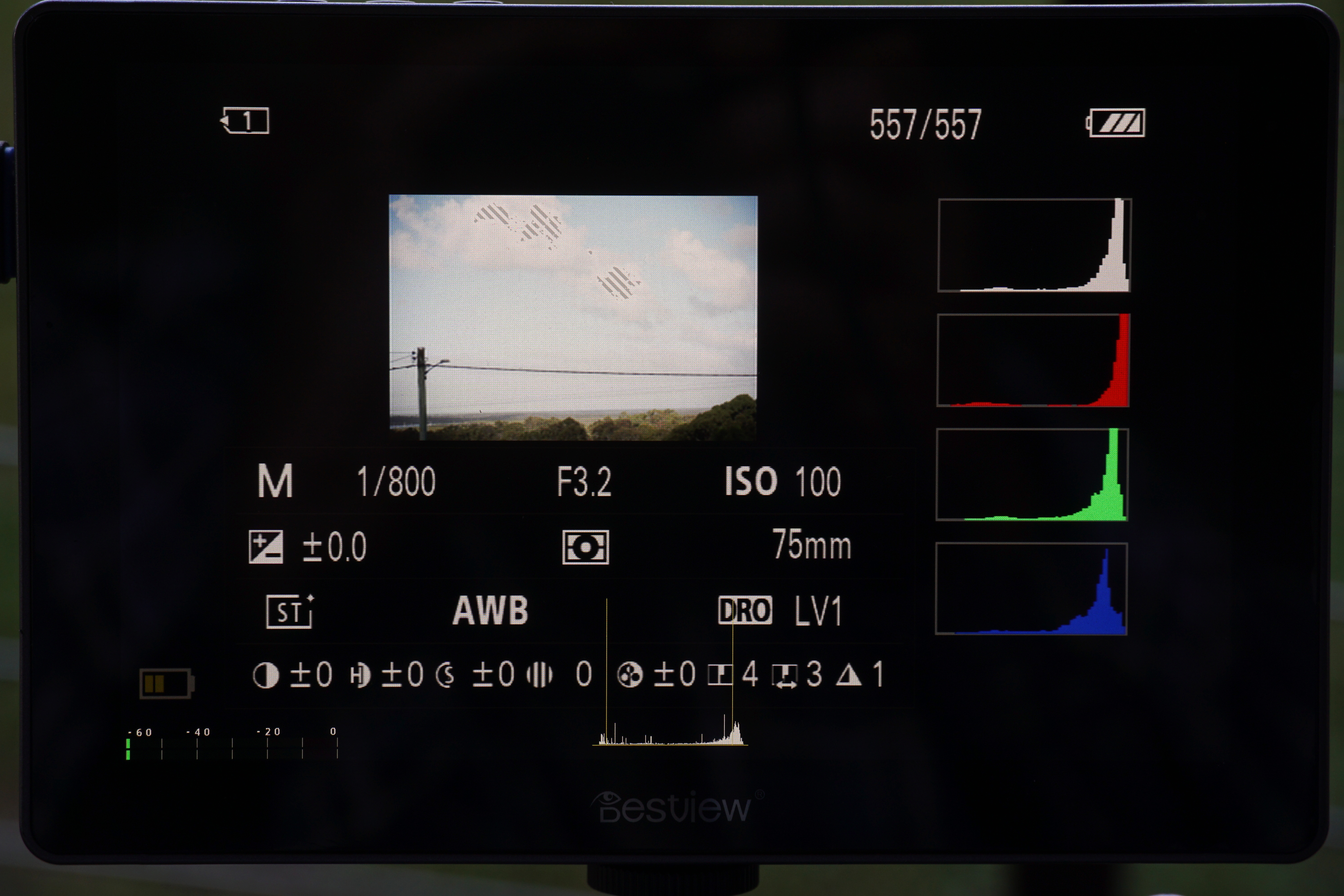

  • Members 2634 posts
    May 10, 2023, 9:31 p.m.
    JPG, 127.8 KB, uploaded by DonaldB on May 10, 2023.

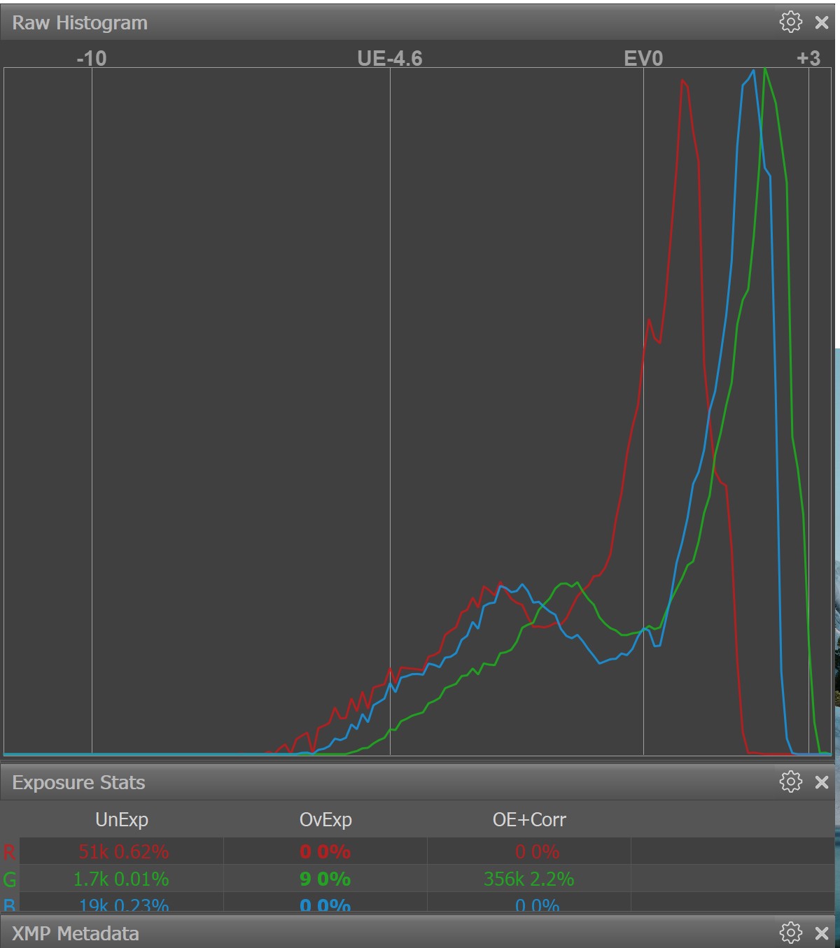

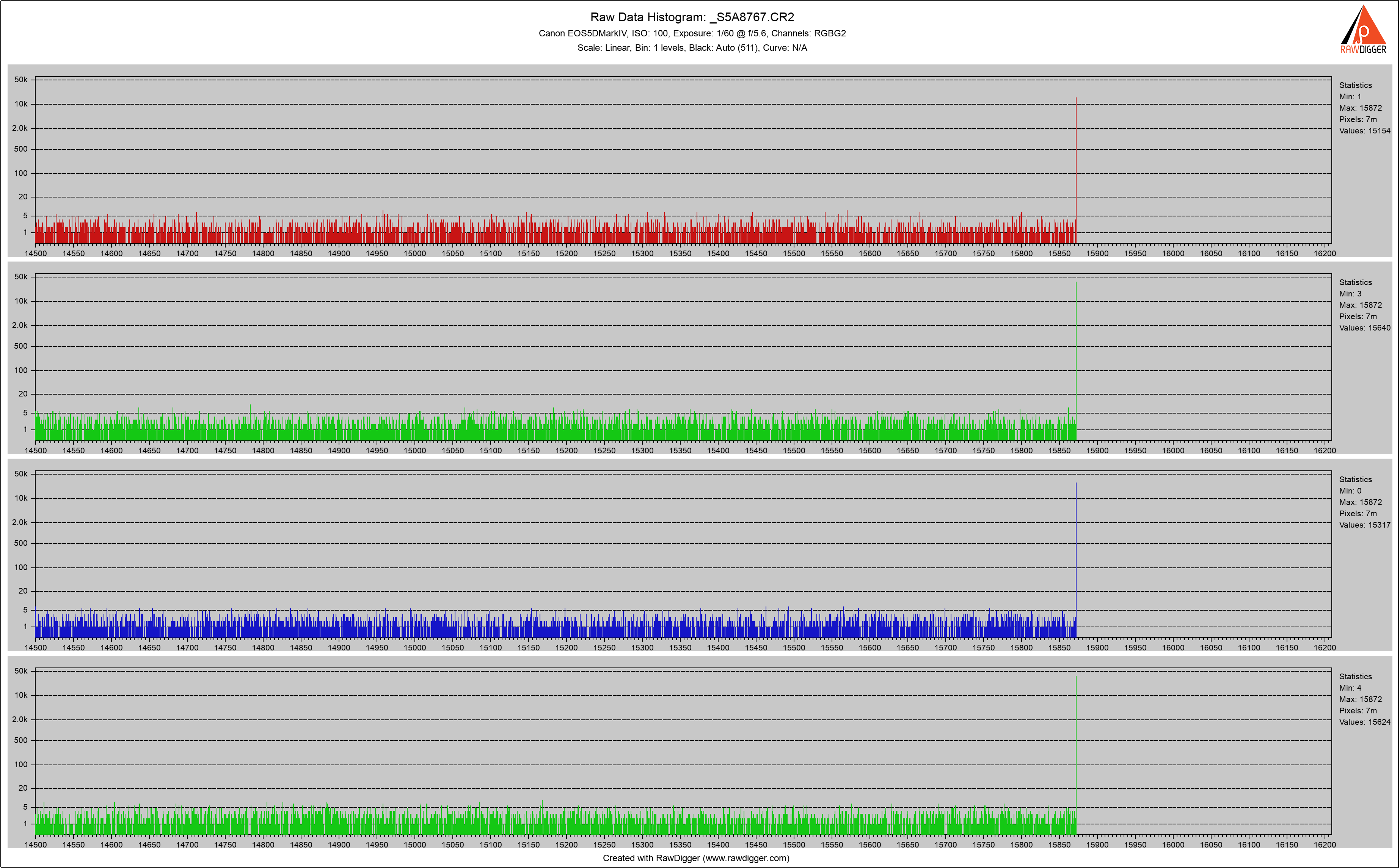

    May 10, 2023, 10:05 p.m.
    JPG, 3.8 MB, uploaded by DonaldB on May 10, 2023.
    JPG, 122.3 KB, uploaded by DonaldB on May 10, 2023.
