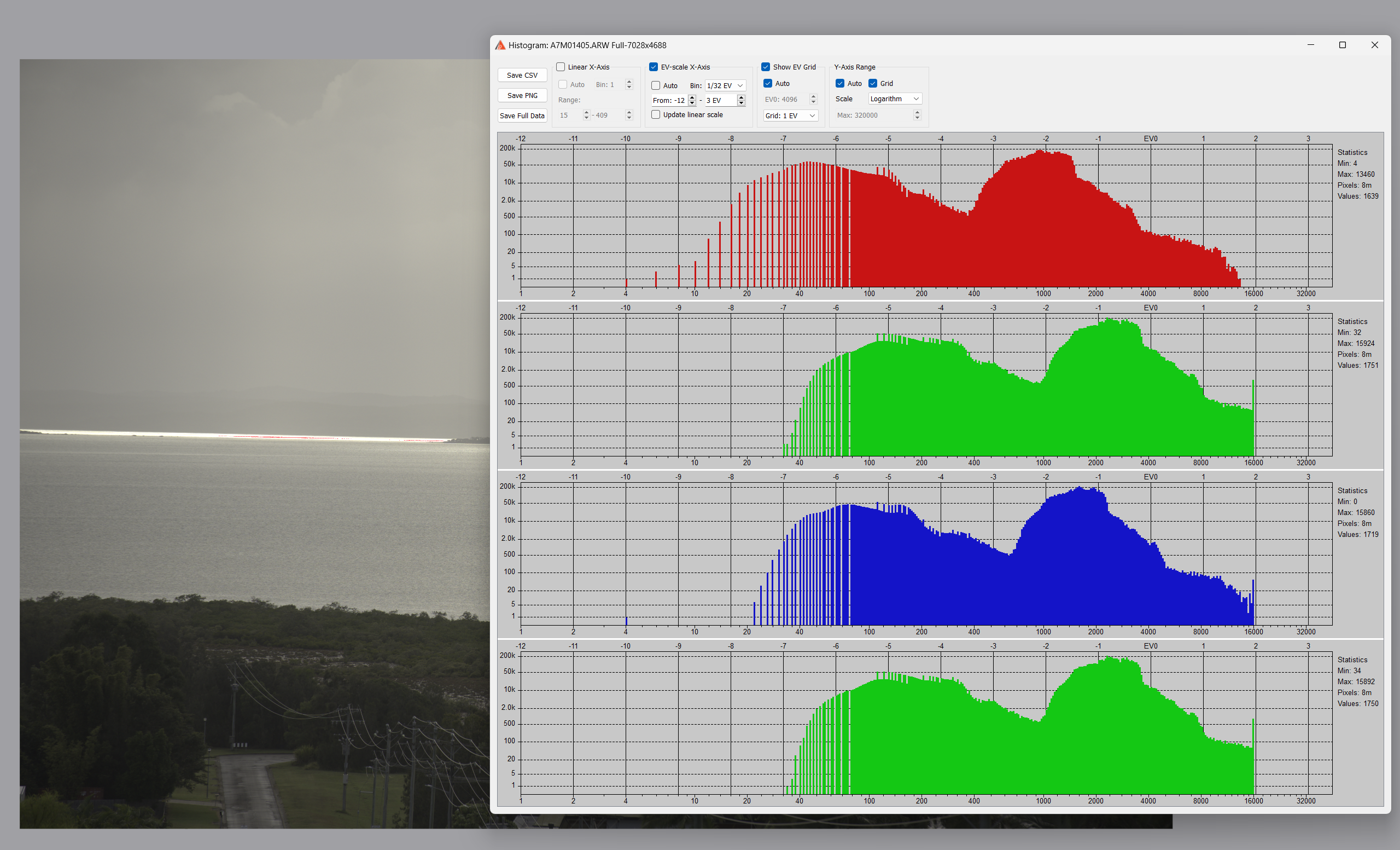

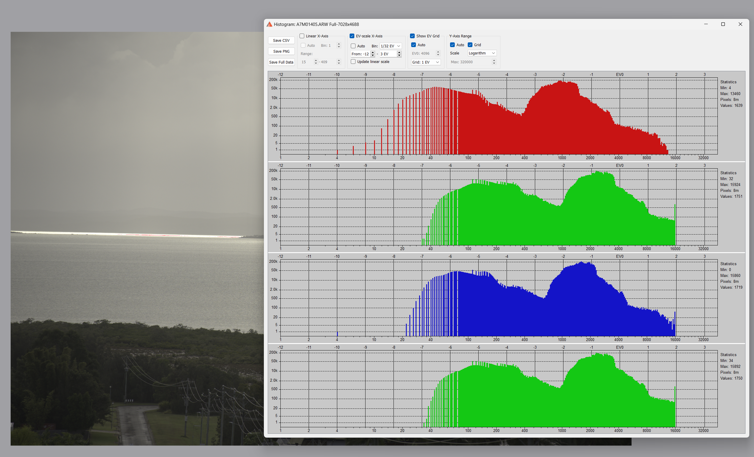

    There are blown pixels in that bright specular line near the horizon, but the clouds are not blown. Note the histogram below has logarithmic scale on Y-axis. So there's just a few hundred pixels blown. I don't know whether it's satisfactory or not and where exactly the zerbas were flashing when you were shooting.

    It can be a good approximation but unfortunately this headroom is not constant , it may depend on the white balance and scene light/contrast. Generally, if in-camera blinkies or RGB histogram don't clip, you don't get clipping in raw either, so you're in the safe zone, but at a cost of underexposing against an 'ideal' ETTR exposure.
    Things get a bit more complicated if you're fine with blowing some unimportant highlights.

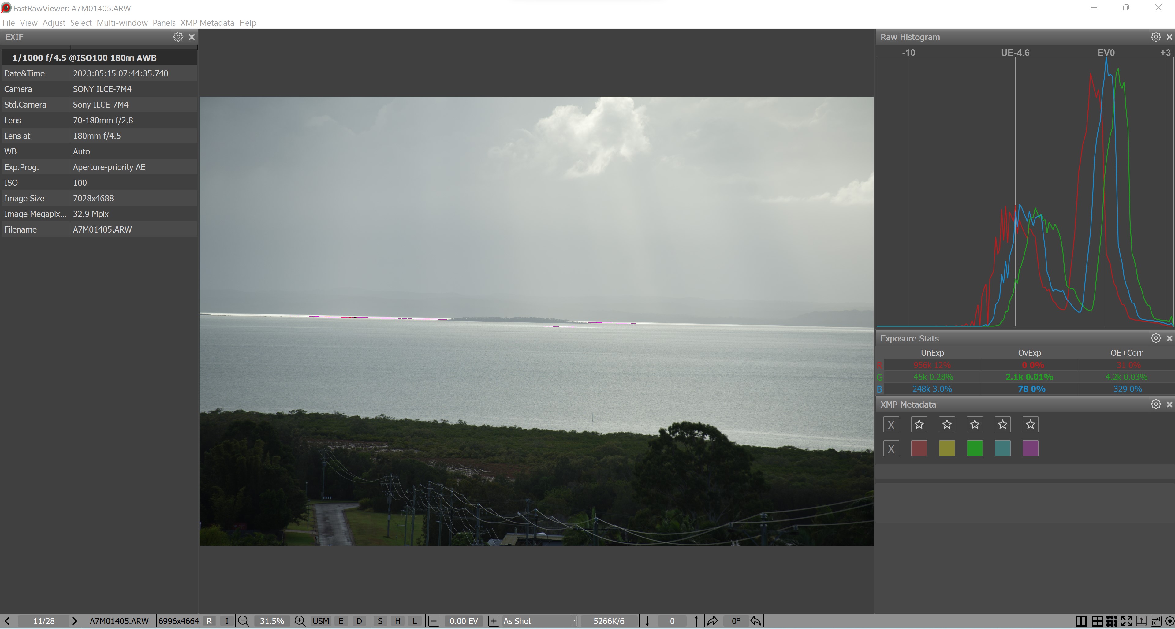

  • Members 2665 posts
    May 15, 2023, 3:54 a.m.

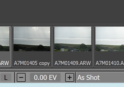

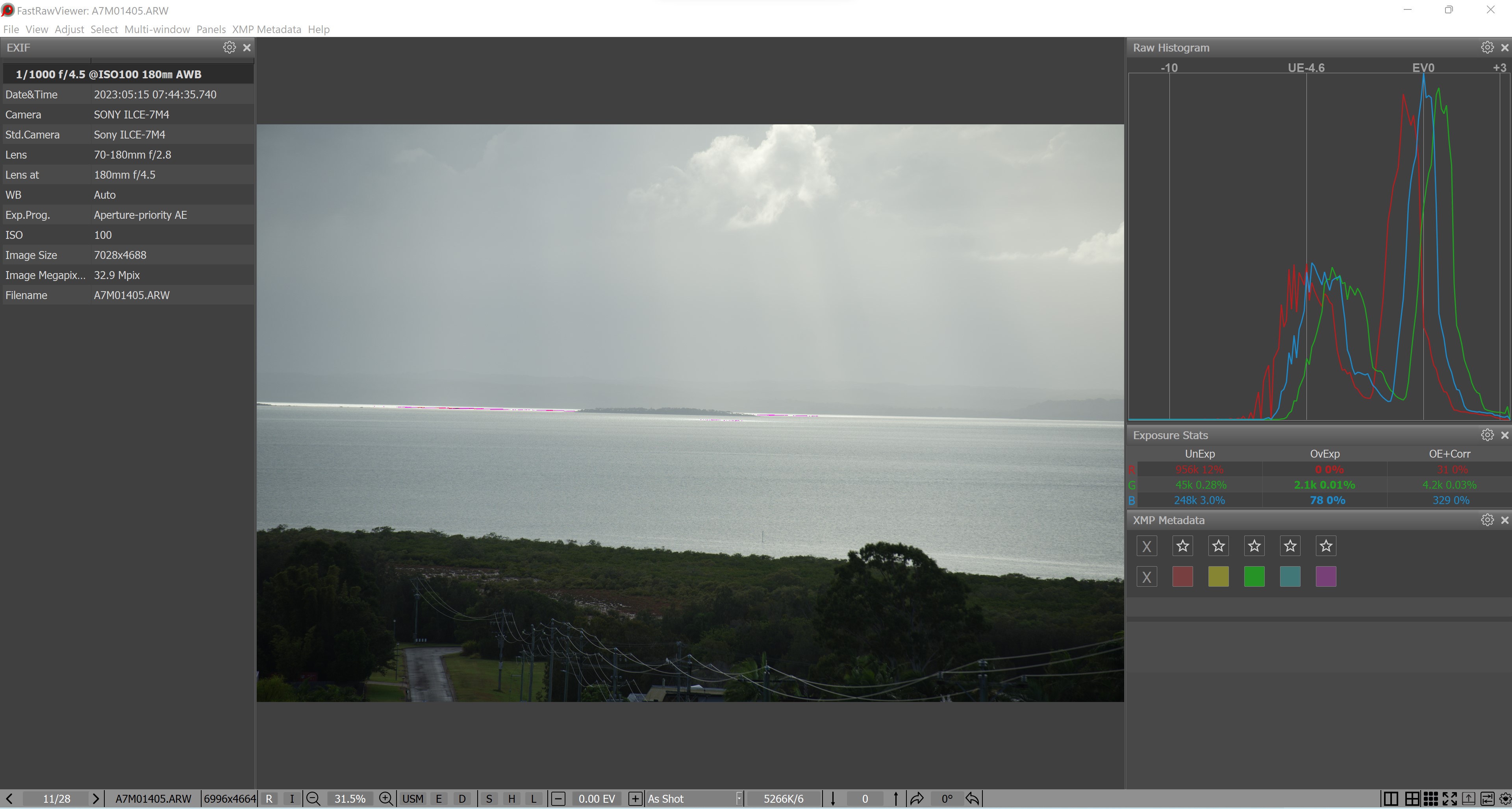

    Thanks for posting the raw digger. i just cant get my head around to use it properly. my zebras were just a very fine line following the magenta line in the image i posted from Fast Raw Viewer.
  • Members 229 posts
    May 15, 2023, 4 a.m.
    Well if the zebras on the camera showed the same fine line on the horizon as shown on the FRV ( the FRV had + 0.67 added to the histogram ) than your cameras zebras are off by at least 0.67

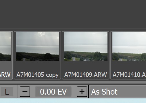

    May 15, 2023, 4:13 a.m.
    it had nothing added

  • Members 229 posts
    May 15, 2023, 4:26 a.m.
    Sure you did to show the clipping in FRV as you have shown you needed to add +0.67
    This can be confirmed with the Exposure stats
    May 15, 2023, 4:37 a.m.
    i dont understand what your refering to. its a strait raw image thats it. i have no idea where you got .67 from
  • Members 229 posts
    May 15, 2023, 4:38 a.m.
    photos.smugmug.com/Temp/Temp/i-jfDM6Bh/0/259a7803/O/1405-frv%20%282%29.jpg
    Here is what you posted
    Working back I see that you have added +0.67 to get to the same stats
    photos.smugmug.com/Temp/Temp/i-w3826Rq/0/9e194483/O/rrrr.jpg
    Heck you can manipulate data to your hearts content
    photos.smugmug.com/Temp/Temp/i-dZpcLPW/0/73b23c92/O/htyht.jpg

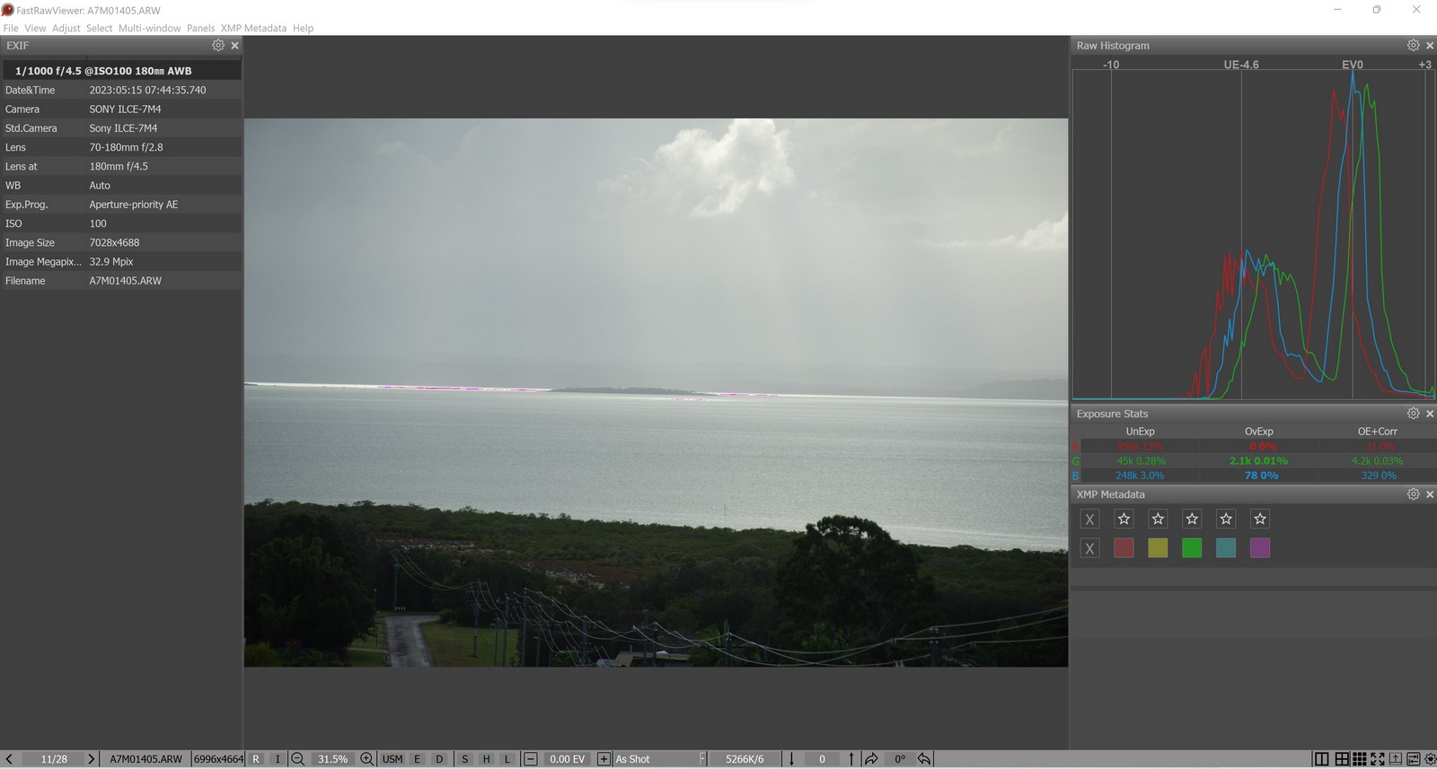

    May 15, 2023, 4:44 a.m.
    I havnt done anything post the screen grab i posted.
    JPG, 108.7 KB, uploaded by DonaldB on May 15, 2023.
    May 15, 2023, 5:01 a.m.
    i think you need to learn to drive the software 😁 and i thought i was bad.

    May 15, 2023, 9:02 a.m.
    What are you waffling on about?
    He isn't questioning what you might have done post screenshot.
    He is telling you what you did pre-screenshot, and how, to create an image to push your agenda.

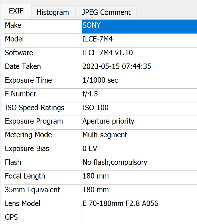

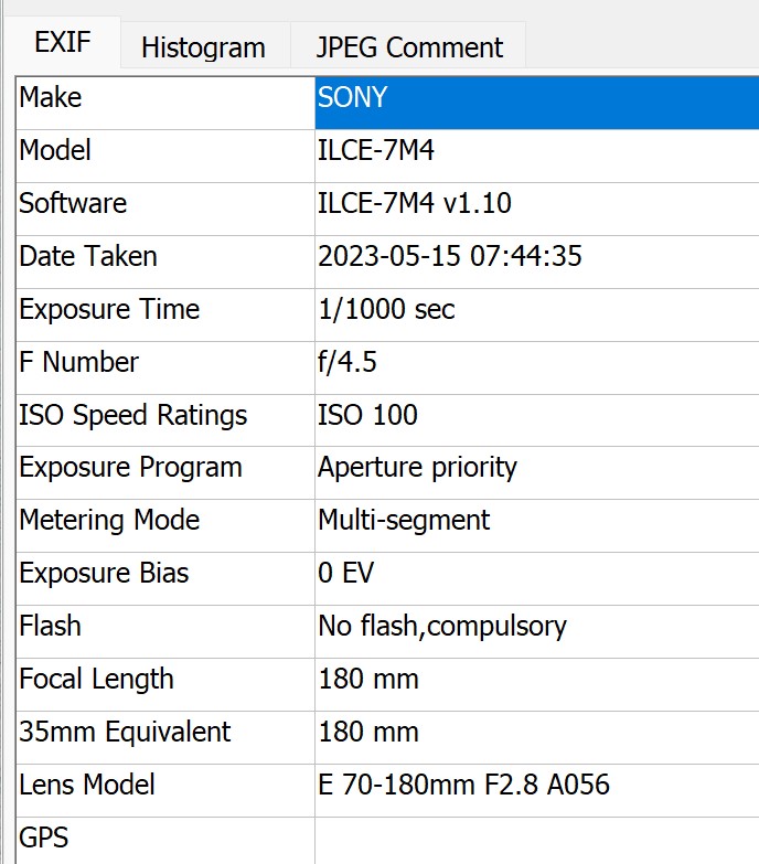

    May 15, 2023, 9:11 a.m.
    That is just the exif that could have come from any image. So what.
    Ian has red circled an 0.67EV in the screenshot you posted.
    He is questioning what caused that 0.67EV?
