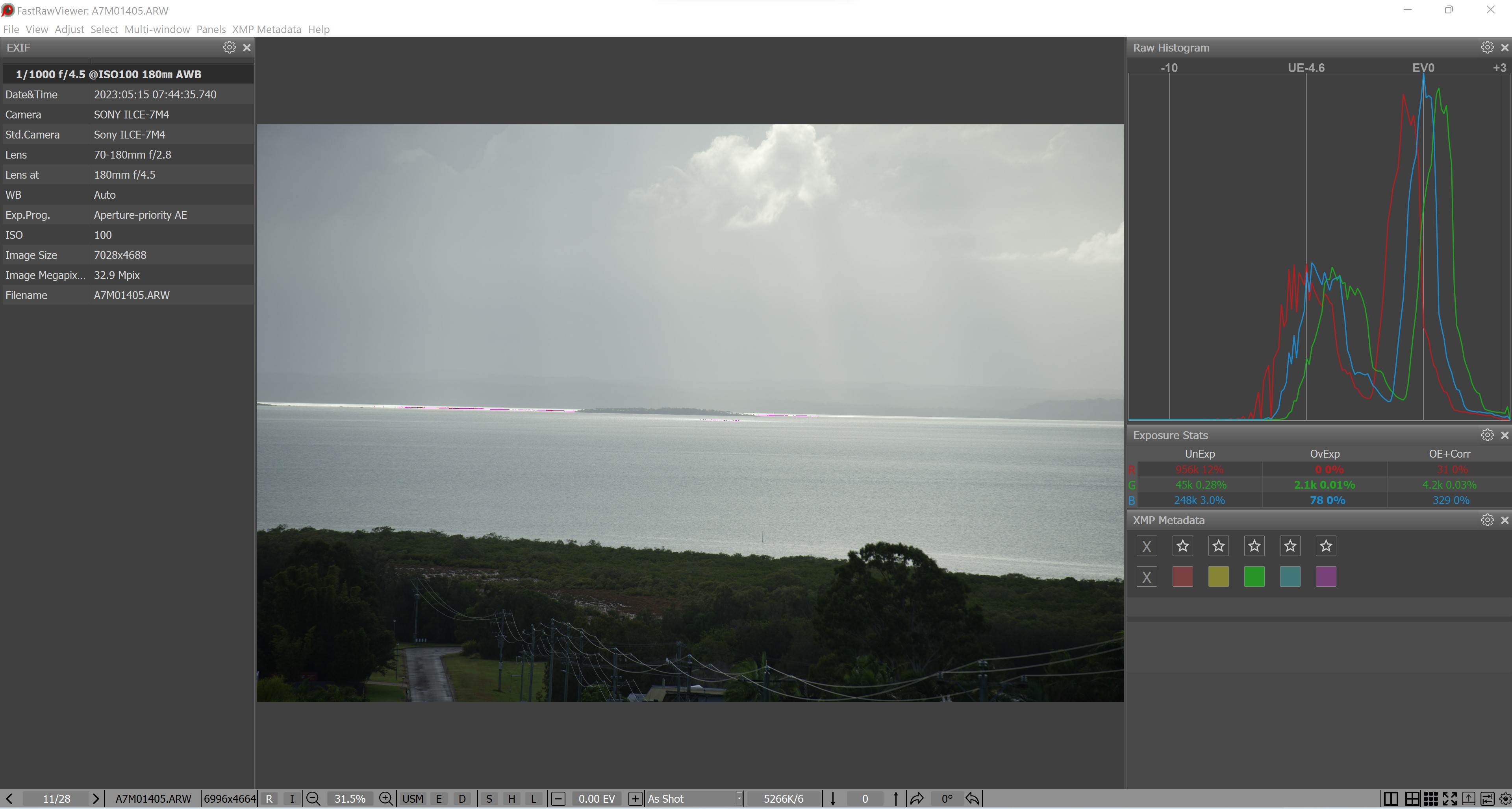

    May 15, 2023, 9:15 a.m.
    prove i posted that image
    PNG, 2.5 MB, uploaded by DonaldB on May 15, 2023.
  • Members 2665 posts
    May 15, 2023, 9:21 a.m.
    your mentally disturbed.
    May 15, 2023, 9:27 a.m.

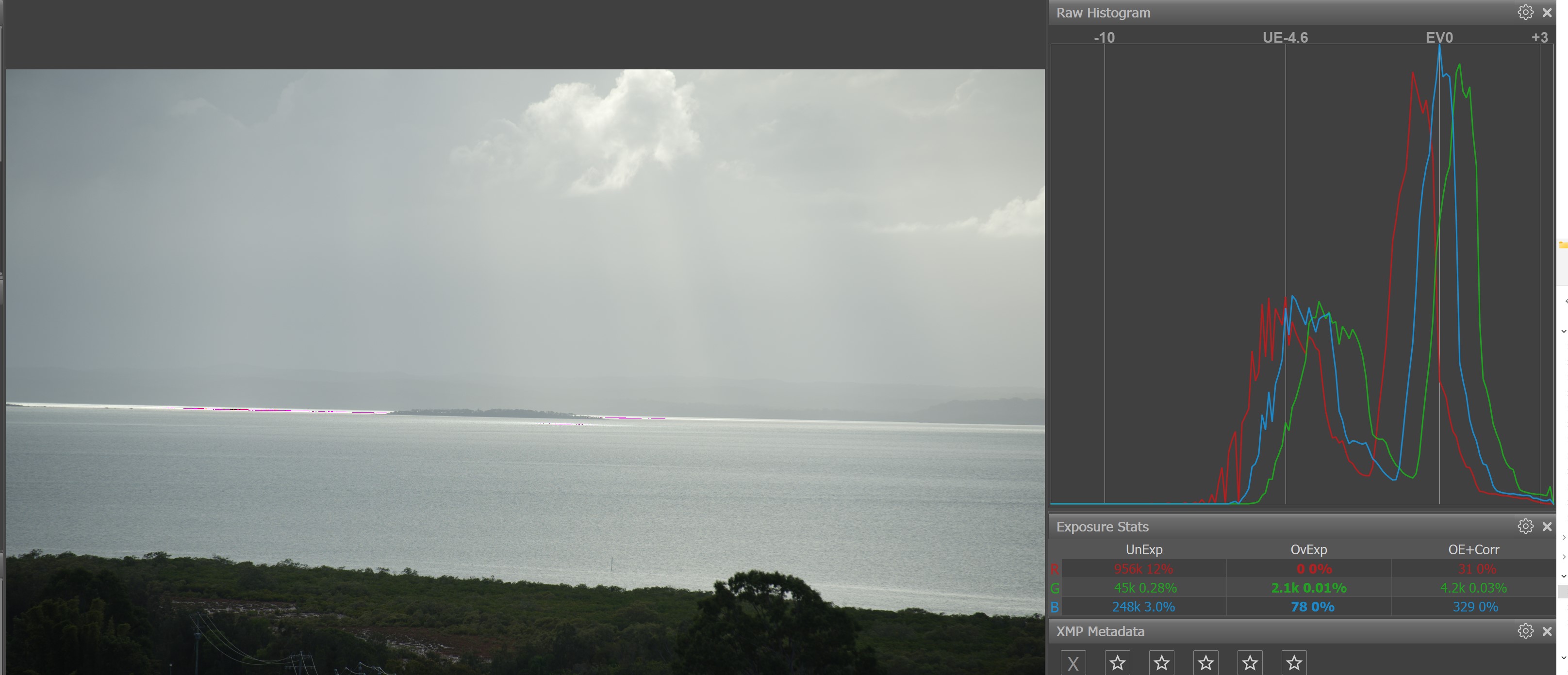

    I will take that as you denying any knowledge of where the red circled 0.67EV in the image Ian says you posted came from.
    May 15, 2023, 9:34 a.m.
    i posted the raw file link for everyone to play with, i have no idea where and what he is doing and couldnt care less to be honest.
    May 15, 2023, 10:16 a.m.
    quarkcharmed posts a raw digger stats and you still think you know what your talking about. ive just revisited FRV and still cant stop laughing how ridiculous some members posts are and there assumptions. i will wait till you have figured it out yourself before telling you ,you are wrong 😎☺

    Raw files often use a "signed" number space because even though electron charges from light and dark current are always "positive", read noise can make values higher or lower, and for signals close to black, this means negative pixel values, less than black. So, a camera could have black at raw level 2048, and a max raw value of 16383, but "16383" is actually 14,335.
    Even with cameras that have black at raw value zero (not an ideal situation if you really need to make the most of very weak exposures), the original raw digitization had a black offset, and they just subtracted it before writing out the raw file, and in some cases, the firmware may stretch the values with scaling to go back up to 16383 again.

    May 15, 2023, 12:28 p.m.
    What I am saying is that if you alter the gamma of that JPEG image to pull values down, the clouds at the top do not have large contiguous areas of clipping. What looks like clipping is actually steps of 255, 254, 253, 252, etcetera representing a much larger range of scene brightness.

    Perhaps some are reading too much into what I wrote and why I wrote it. My point was only that this image, as given, doesn't actually clip the clouds over any large areas, and doesn't have enough noise to avoid posterization. Obviously, if the conversion was in a 16-bit space instead of an 8-bit, the noise could be sufficient and the highlight compression could be reversed without posterization.

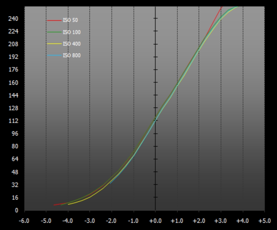

  • Removed user
    May 15, 2023, 1:09 p.m.
    Quite so.

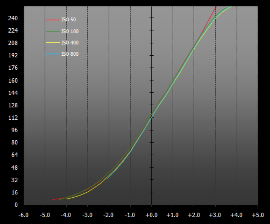

    Neither cloud contrast nor shadow detail are helped by the 'S' curve given by many cameras going from scene luminance to RGB.
    For example, a Sigma DP2:
    or a Sigma SD15:
    kronometric.org/phot/camera/SD15/SD15%20linearity%20II.png
    JPG, 156.5 KB, uploaded by xpatUSA on May 15, 2023.

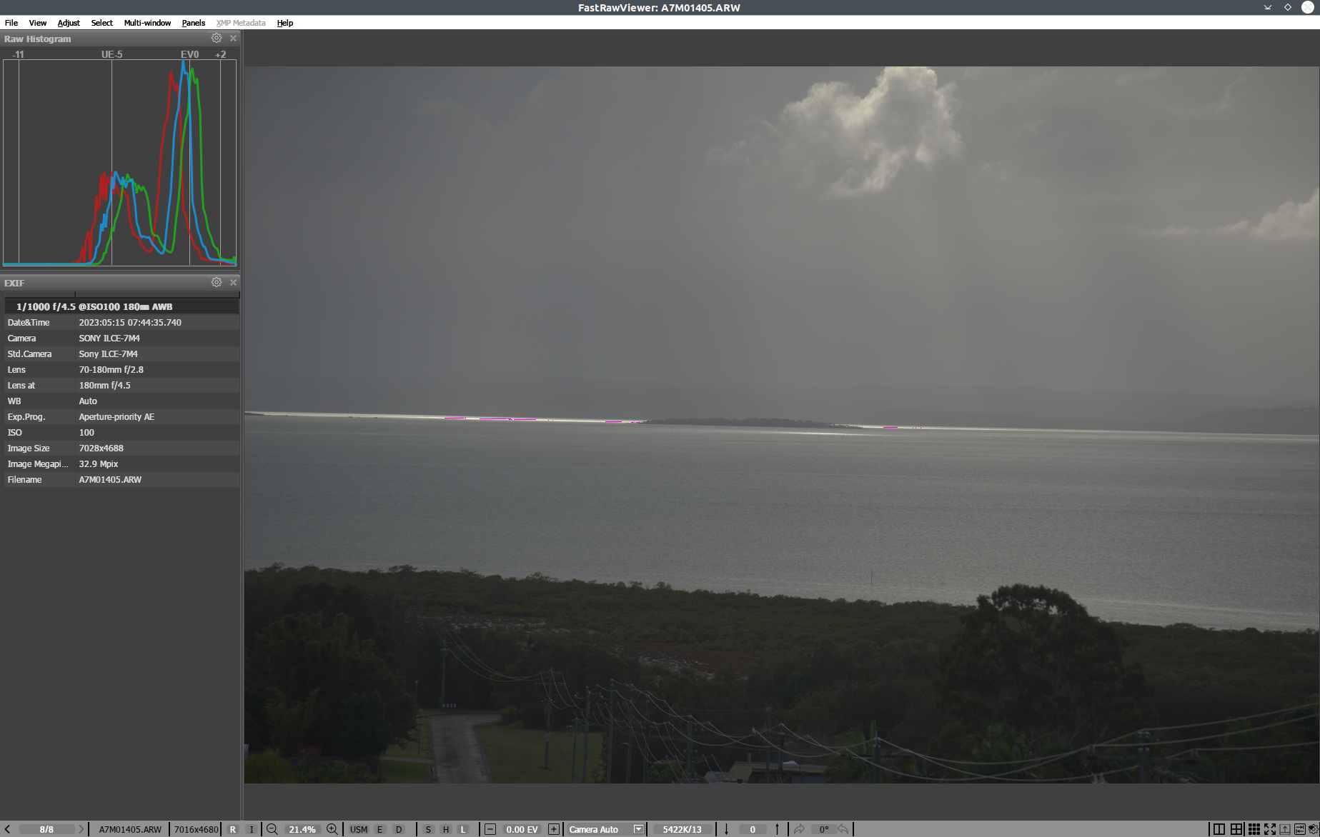

  • Members 976 posts
    May 15, 2023, 2:31 p.m.

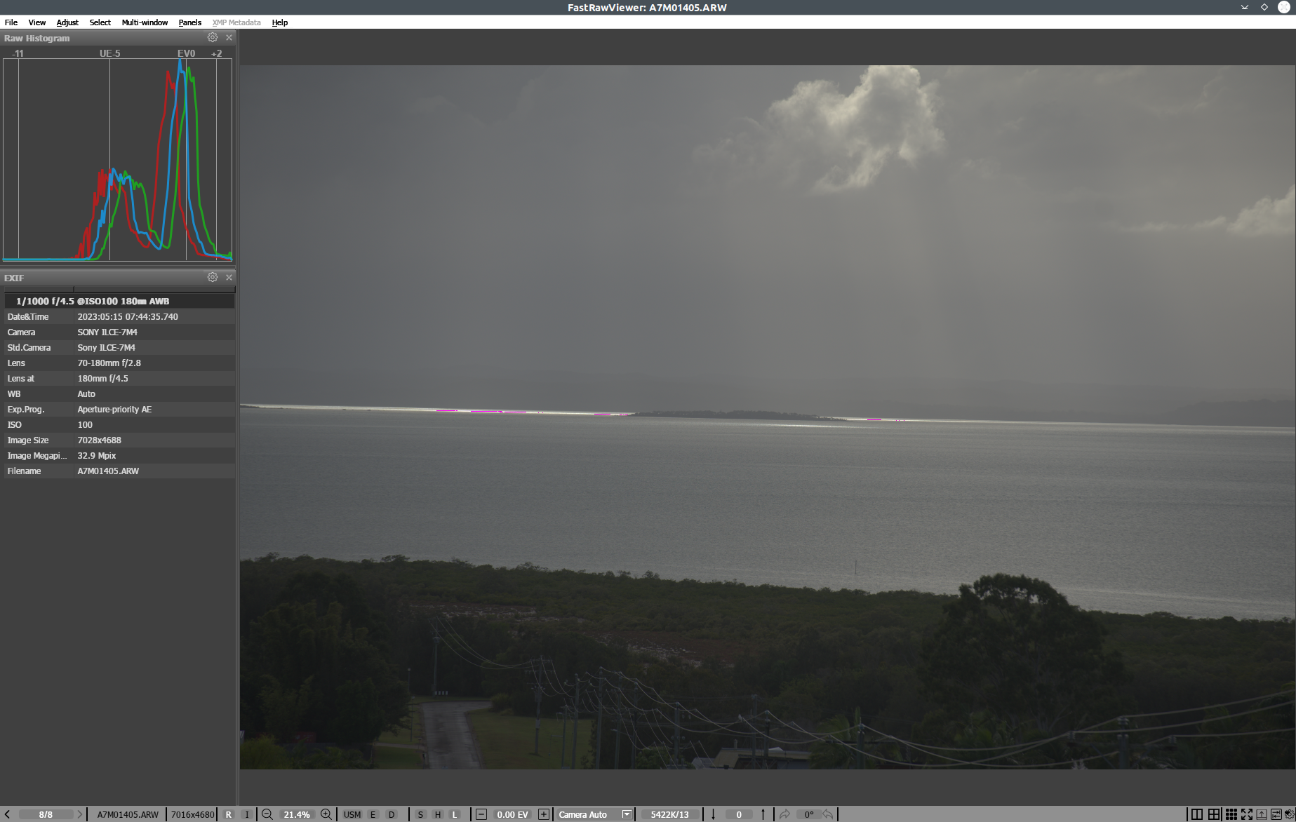

    FastRawViewer Preferences -> "Image Display" -> "Ignore exposure correction/baseline exposure in linear mode" - check.
    FastRawViewer Preferences -> "Exposure" -> "Exposure adjustments affect OverExposure display" - uncheck.
    Display the image and press Shift-L. This will help to assess what is truly clipped in raw data and what a raw converter will deal with as the source data.
    The result:
    More on this here:
    www.fastrawviewer.com/blog/fastrawviewer1-7-new-view-mode
    PNG, 1.8 MB, uploaded by IliahBorg on May 15, 2023.
