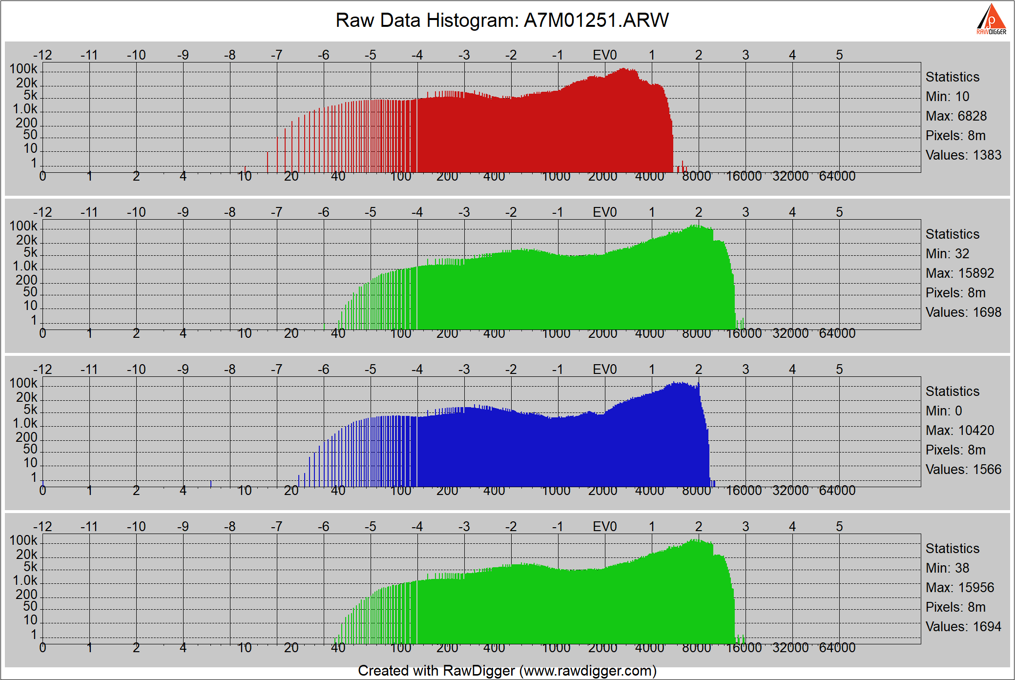

    Yes, if your in-camera WB is set fairly green you'll have an in-camera histogram that better approximates the raw histogram. This is called UniWB, and Iliah was the first to publicize it, and maybe the first to do it, almost 20 years ago.
    PNG, 99.1 KB, uploaded by JimKasson on May 10, 2023.

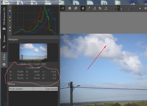

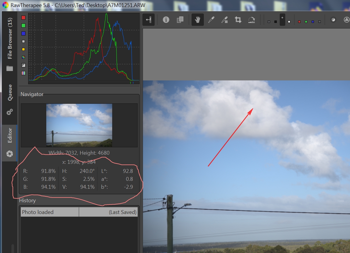

    And here's what RawTherapee thinks, FWIW ...
    Those zebras need to be let out of the corral so they stop misleading people ...
    The image now under discussion:
    However, looking at the vignetting, I'd sell the camera or lens or both ... yes, Straw Man, I know!
    JPG, 344.2 KB, uploaded by xpatUSA on May 10, 2023.
