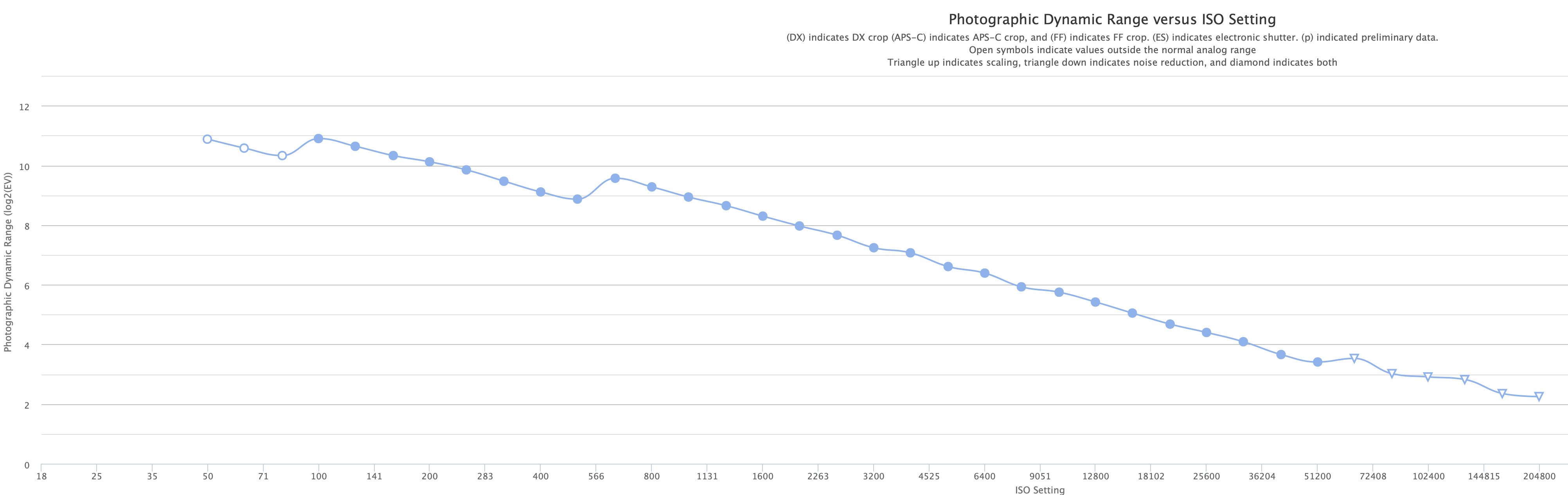

    No it doesn't have huge implications for those genres whatsoever. Folks in those genres can:
    1. Know the theory and ignore it as they need to setup for nailing the shot.
      or
    2. Not know the theory and don't care anyway, as they need to setup for nailing the shot.
    Both 1 and 2 lead to the same end result.
    That said, you've further piqued my interest now.
    If ETTR isn't useful at higher ISO's what is the point of Bill Claff's PhotonstoPhotos DR charts?
    I've always been under the impression that things like his DR charts allow you to determine how much your DR falls away as ISO climbs.
    But you're saying that's all irrelevant for ETTR at higher ISO's?
    I was under the impression that one could use these charts to gain an understanding of how ETTR to lower ISO might eek some more DR to play with.
    Maybe I'm wrong (rendering such charts pointless).
    I'm happy to learn something new, but it won't change how folks such as us work, as we HAVE to work the way we do.
    Here's the chart for my camera:
    Credit Bill Claff:
    www.photonstophotos.net/Charts/PDR.htm
    PNG, 227.3 KB, uploaded by BurnImage on May 11, 2023.

    Because Bill Claff has an entire website full of charts for hundreds of cameras that all show the same behaviour.
    If he is wrong and you are right I'm happy to be enlightened?
    To be very specific, his chart for my specific camera tells me I have 10.9 stops of DR at base ISO100.
    But that falls to 6.9 stops of DR at ISO 6400 and further still to 5.4 stops of DR at ISO12800.
    Maybe I've been wrong all these years and these charts are useless?
    Shooting low light events and living at ISO6400 to 12800 habitually I was under the impression that auto ISO with 1 stop ETTR exposure would buy me an extra 1.5 stops of DR to play with in post, by reducing my ISO from 12800 to 6400. Given that my aperture and shutter speed are already chosen and are non-negotiable to get the shots I need.
    But, of course, if these charts are wrong and should actually be a flat horizontal line from base ISO to infinity I'm happy to learn something new?
