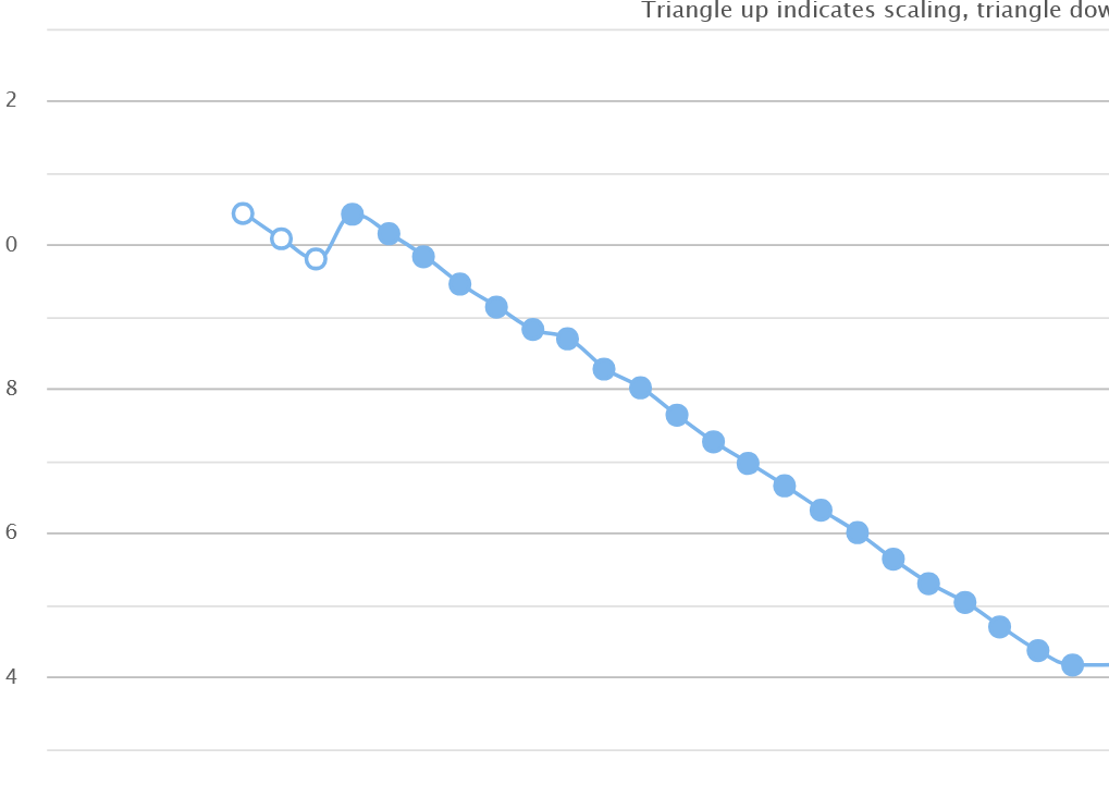

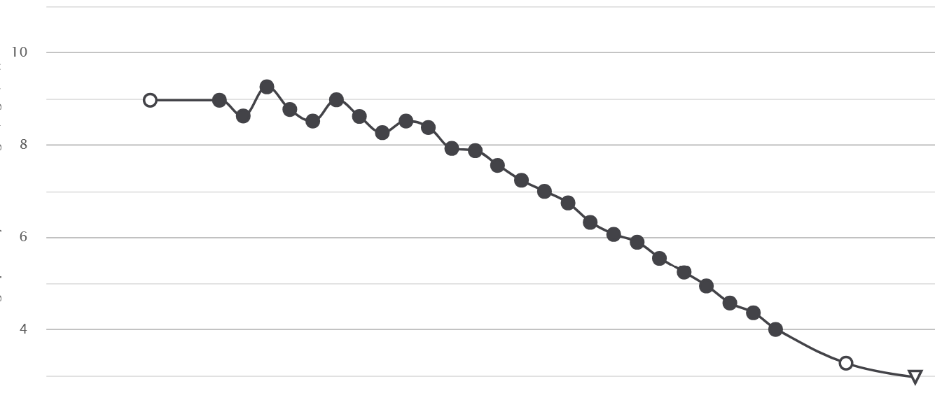

    A member of my club posted "I found out the other day that if I increase my ISO from 100 to 160 the dynamic range goes up and the noise goes down." and referenced the site photonstophotos.net/. When I looked at his camera, (Canon 5D Mk3), I saw this:

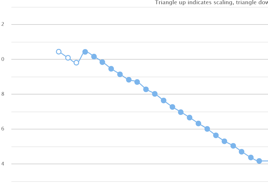

    Which, as you can see has better dynamic range at 160 and 320 ISO. But why does it do that?
    My Fuji X-T5 doesn't (native ISO starts at 125).

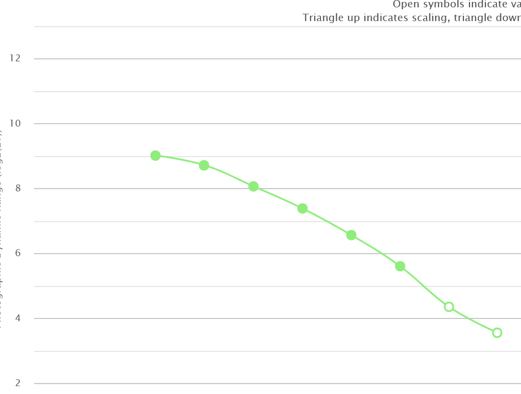

    A Canon 90D doesn't.

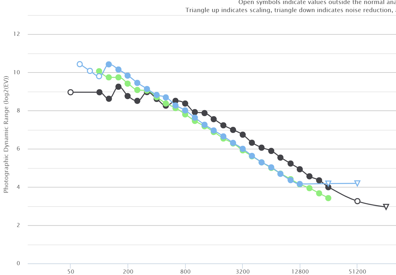

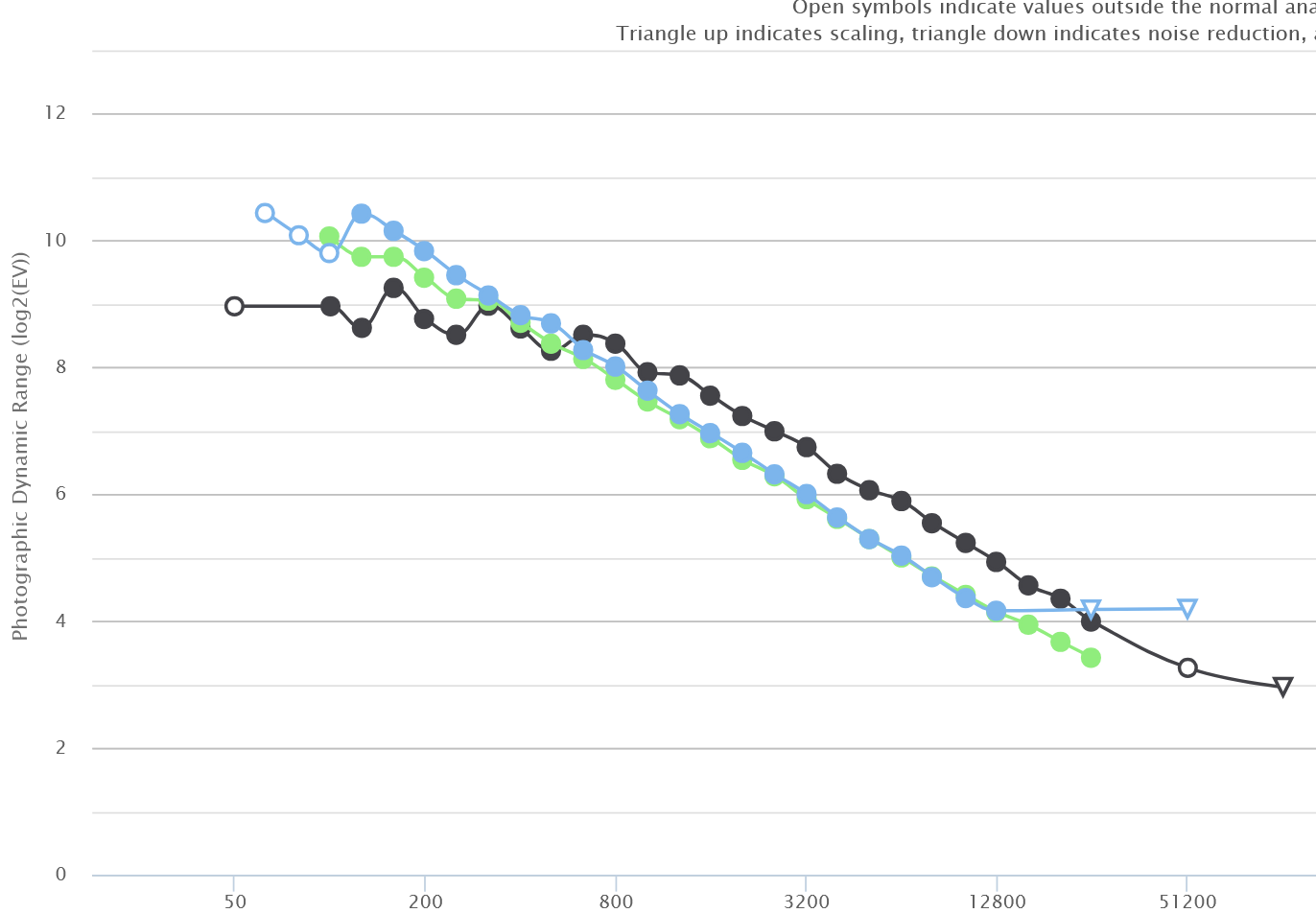

    Here's all 3 overlaid (with scales left & bottom):
    Can someone explain this in layman's terms?

    In a camera, the ISO setting normally affects the gain between the sensor output and the raw written data. In some cameras, that gain is fixed and the ISO gain is applied in the conversion software. In the green curve, the gain is proportional to the ISO value; in the other curves, it is not. The blue curve (your Fuji) looks to me like it has "extended" low ISO and high ISO; and the black curve has some trickery in addition to that.
    "Extended" means that, for example, that the camera aperture and shutter values are not changed by the ISO setting below "native", say 100 and some high value..

    It is possible that for some low ISO values camera changes some sensor parameters (like decreases well capacity), also some processing parameters, which both affect noise and thereby DR as well.
    Then your camera (X-T5) has dual-gain sensor - changing ISO again changes sensor parameters and creates two distinct regions with different DR behavior.
