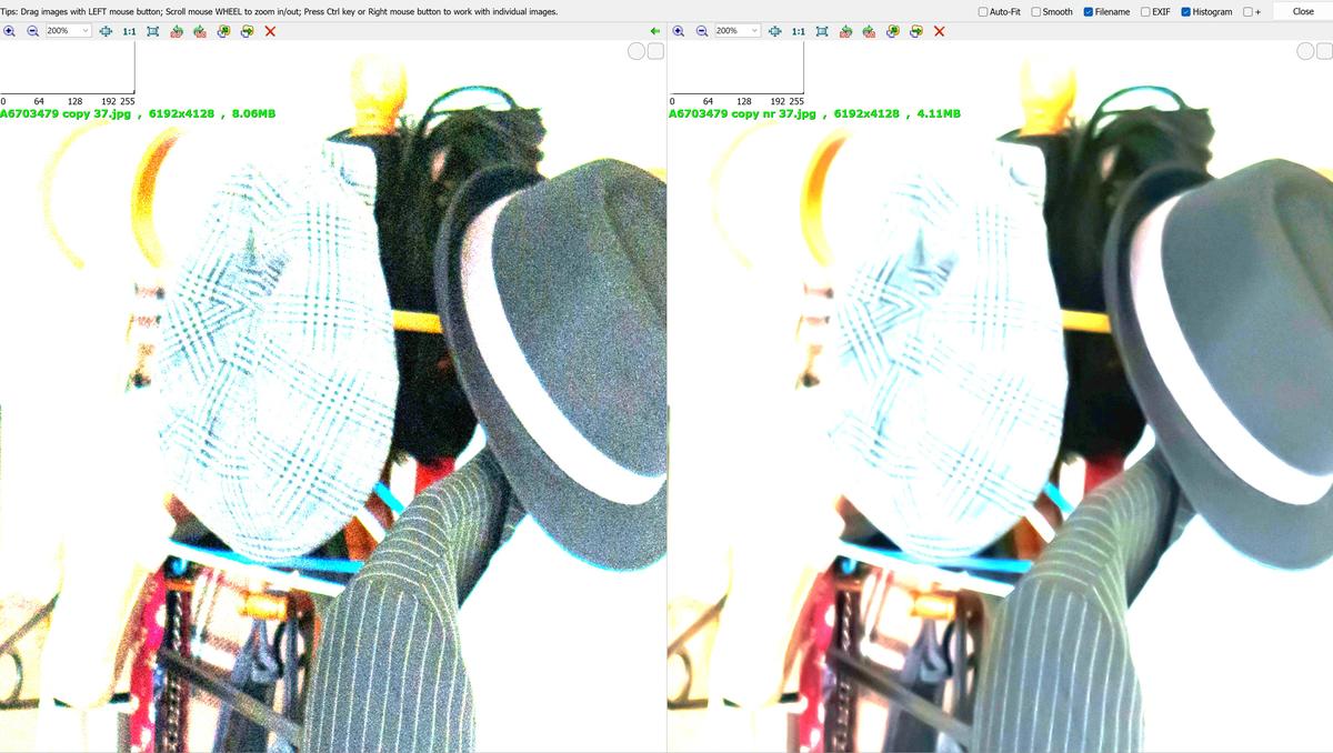

    the NR was applied in PP photoshop and topaz. as i keep saying noise reduction does not increase DR period. the cap clearly shows this.

    We (I mean most technical people here) use DR in meaning "maximum signal / noise floor in recorded data"; noise floor is often taken as signal value, where SNR (signal to noise ratio) = 1. As sensors [usually¹] are linear devices, then this roughly corresponds to ability record scene DR without too much noise.
    You are mostly concerned about clipping highlights - at least your examples show that. In old film times this was important property, esp because film is not linear media - you could record wide scene DR (say 14 stops) into much narrower film DR (say 8 stops) and I think most talk about DR concerned particular film ability to record some dynamics both in higlights and shadows at the same time.
    Those definitions are not exactly compatible - both characterize some range of recordable information, but are based on totally different ideas.
    For first meaning (technical definition) it is clear that noise removal (NR) lowers noise floor and thereby increases DR.
    For second meaning (visual definition) noise is almost not important and NR does not change almost anything - higlights will not be recovered, (deep) shadows are not lifted and so on.

    But the Exposure slider doesn't alter exposure, it's just named "Exposure" and only adjusts the brightness, modifies the way the data is displayed. How do you know that it doesn't weight the adjustment or add a perceptual intent?
    Also, again you're looking at an RGB computer screen post conversion to your chosen colour profile. The DR of the screen if fixed. So it's not possible to observe a higher DR in any file directly. All you're doing (paradoxically) is compressing the DR in the RAW until it fits within the fixed DR of the screen. That's basically what the basic sliders do, stretch and compress the data so you can make it fit into the fixed DR of your output device with pleasing colour and contrast.
    I'm not quite sure what it is you think you're doing.

    July 8, 2025, 9:11 a.m.
    noise reduction is no different than veiling glare, veiling glare reduces DR period, you have the equipment do the test to back your claims.

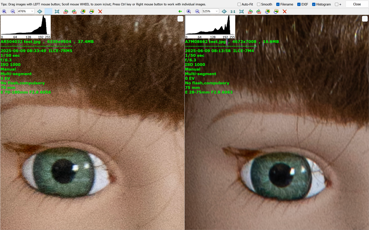

    Why the different lenses and focal lengths, for the same lens mount? The right-side image has color fringes (red and blue) in the specular lights on the cornea, and the left-side image does not. Obviously the lenses and/or different processing are playing roles here; not just different pixel densities. Also, you lose the guarantee of equal exposure when you use different optics, especially at low f-numbers like 2.8, where the actual transmission varies wildly with different lenses. Also, at f/2.8, most zoom lenses have much more aberration than diffraction, and so total blur will be different. The focal lengths are different; did you adjust distance, accordingly, for the doll's eye to be the same size in mm on the sensors?
    Again, Nearest Neighbor upsampling gives predictable results with the same scene and optics; the larger the pixels, the higher the maximum contrast between neighboring pixelated pixels. If you use a sharper lens with the bigger pixels, then you're going to have even more high-contrast between the pixelation neighbors (horizontal and vertical, only). This is what the primitive levels of our brains look for to feel like we have successfully focused on an object, which can fool us into mistaking this acuity for actual image information.
    So, there are just too many wild cards here for your test to have any meaning.

    July 12, 2025, 2:37 a.m.
    The 2 tamron lens are both equally as sharp as each other i just framed the doll to the correct composition. lens breathing is most likely playing a part in the different focal lengths, its only 5mm 😏, as a guy over in the sony forums has also noticed his a7iv images appeal more over his a7r5, at least he being honest with him self. i just shot identical images from 2 tripod set ups at different iso readings to see when noise started to decreases detail . it starts at iso 320.
