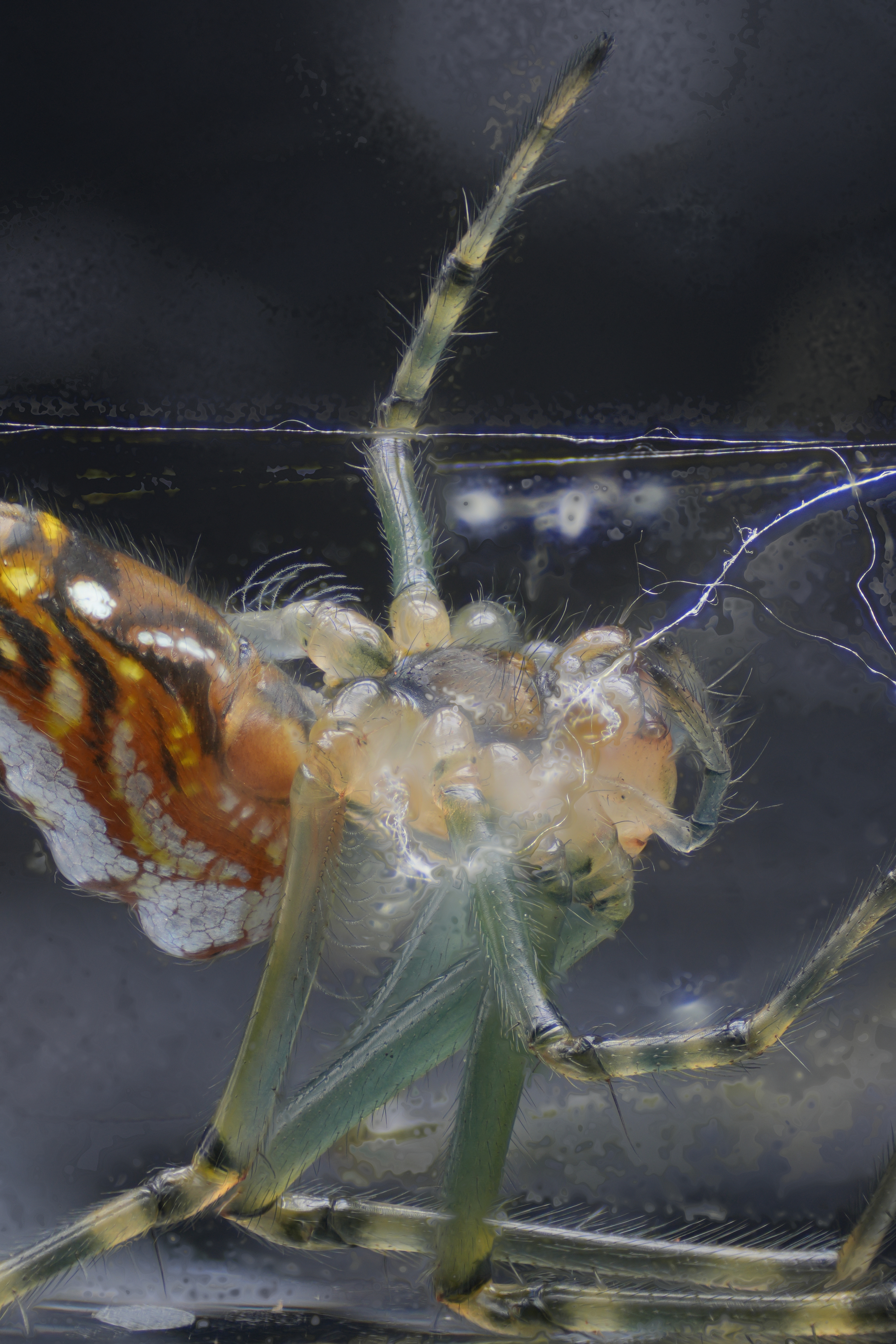

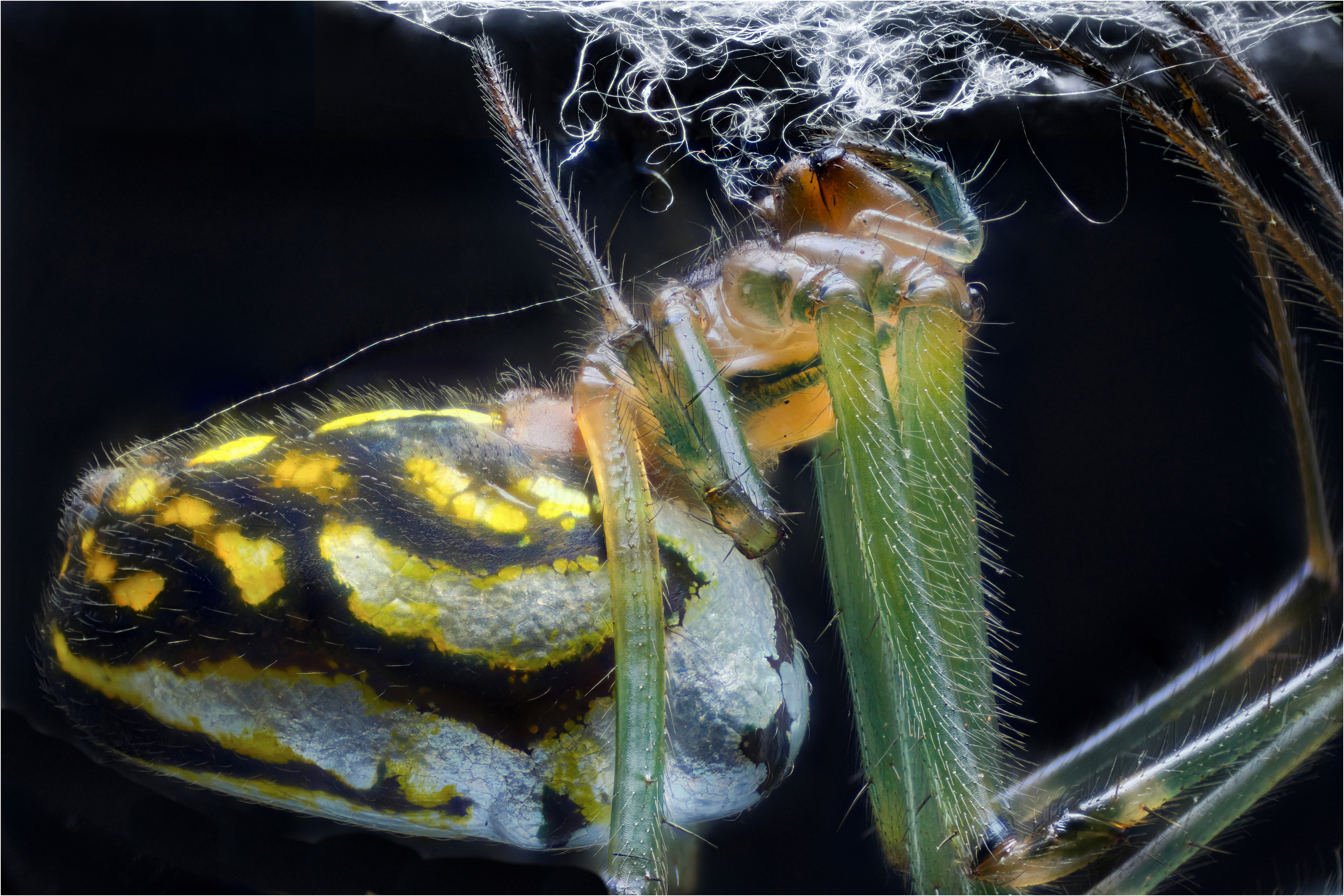

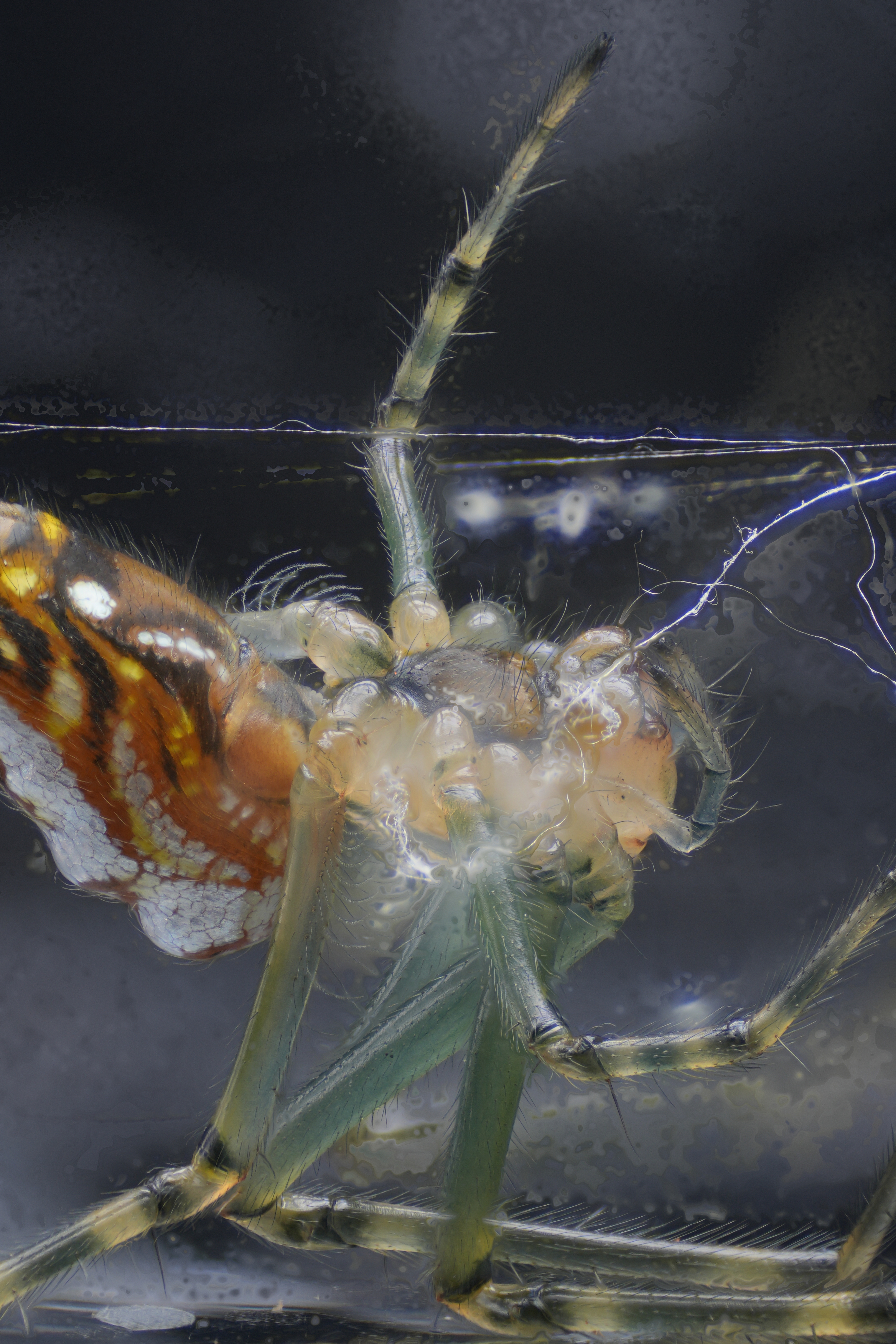

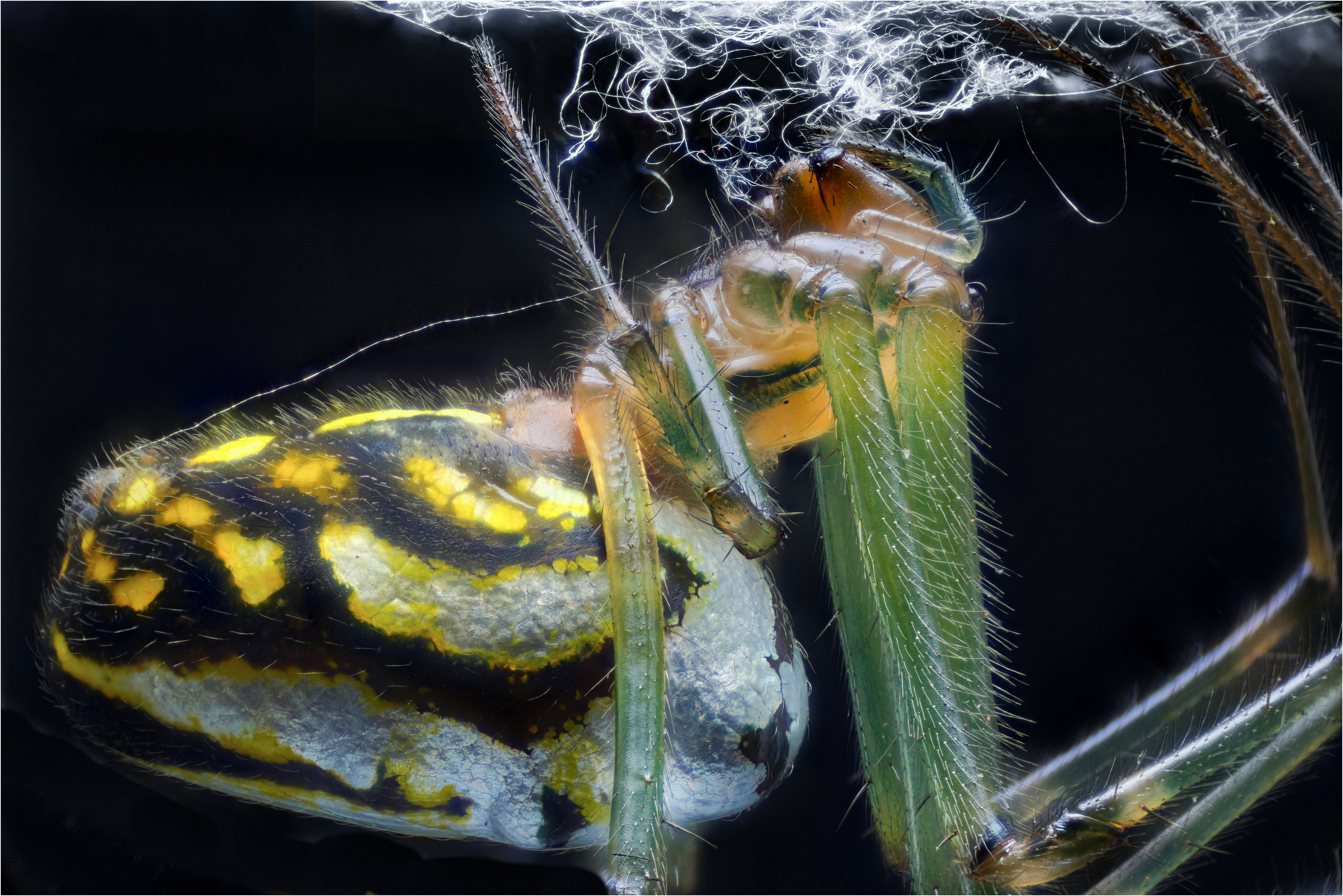

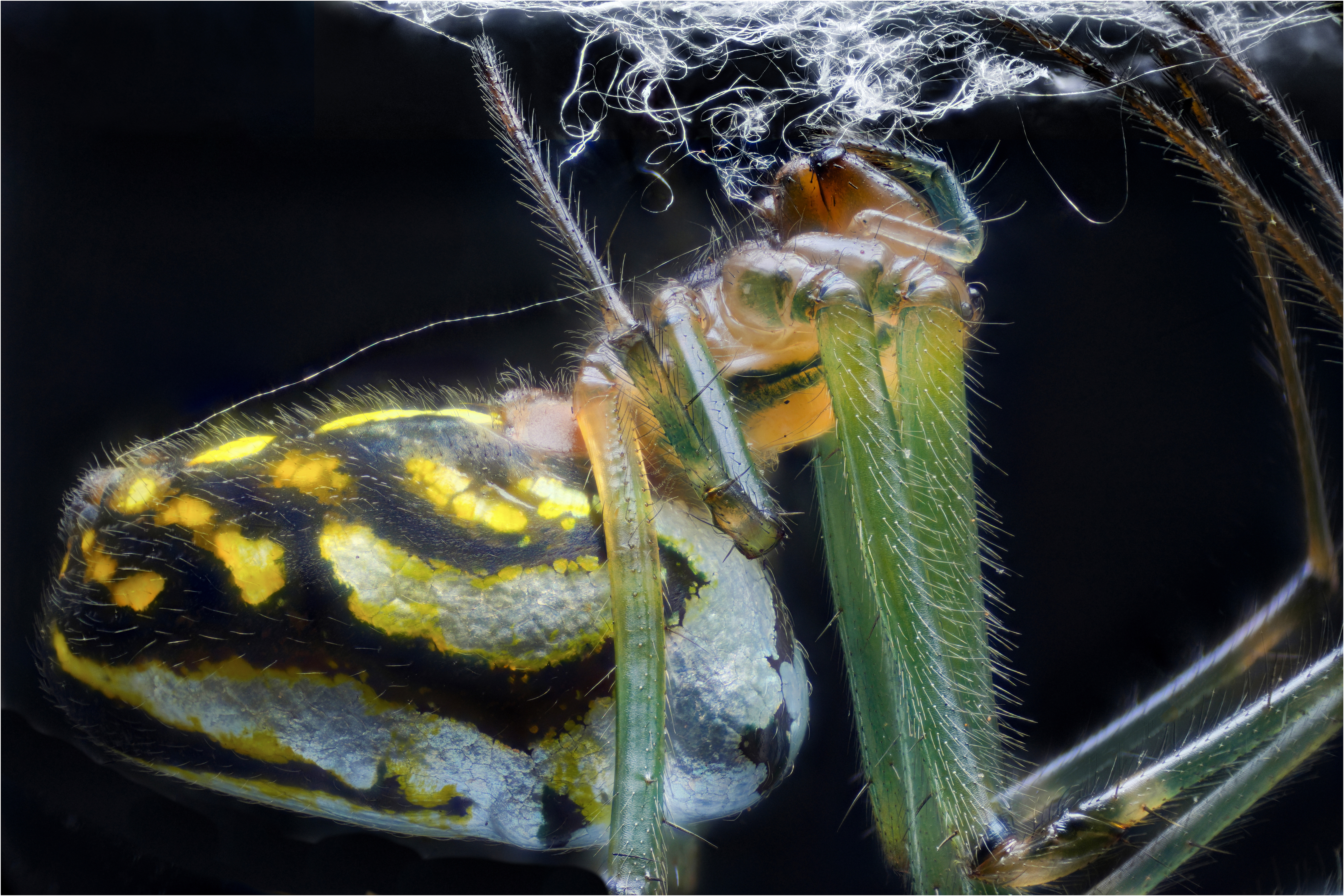

    Dmap better 🤨it cant even stack my complex spiders, please explain what you call better 🤔if you cant post a comparrision for us to see what your stacking.
    i think i will use what ive been doing for 8 years. thanks for sharing your experiences.
    JPG, 13.3 MB, uploaded by DonaldB on July 6, 2025.
    JPG, 14.1 MB, uploaded by DonaldB on July 6, 2025.

    You should look at using Zerene stacker to its fullest potential, Zerene is not a one trick pony that you use either one or the other, the software was designed around using both at the same time, one for detail and the other for maintaining color and contrast
  • Members 2650 posts
    July 6, 2025, 8:49 a.m.
    the image i posted is from both at the same time. its a 1 trick pony

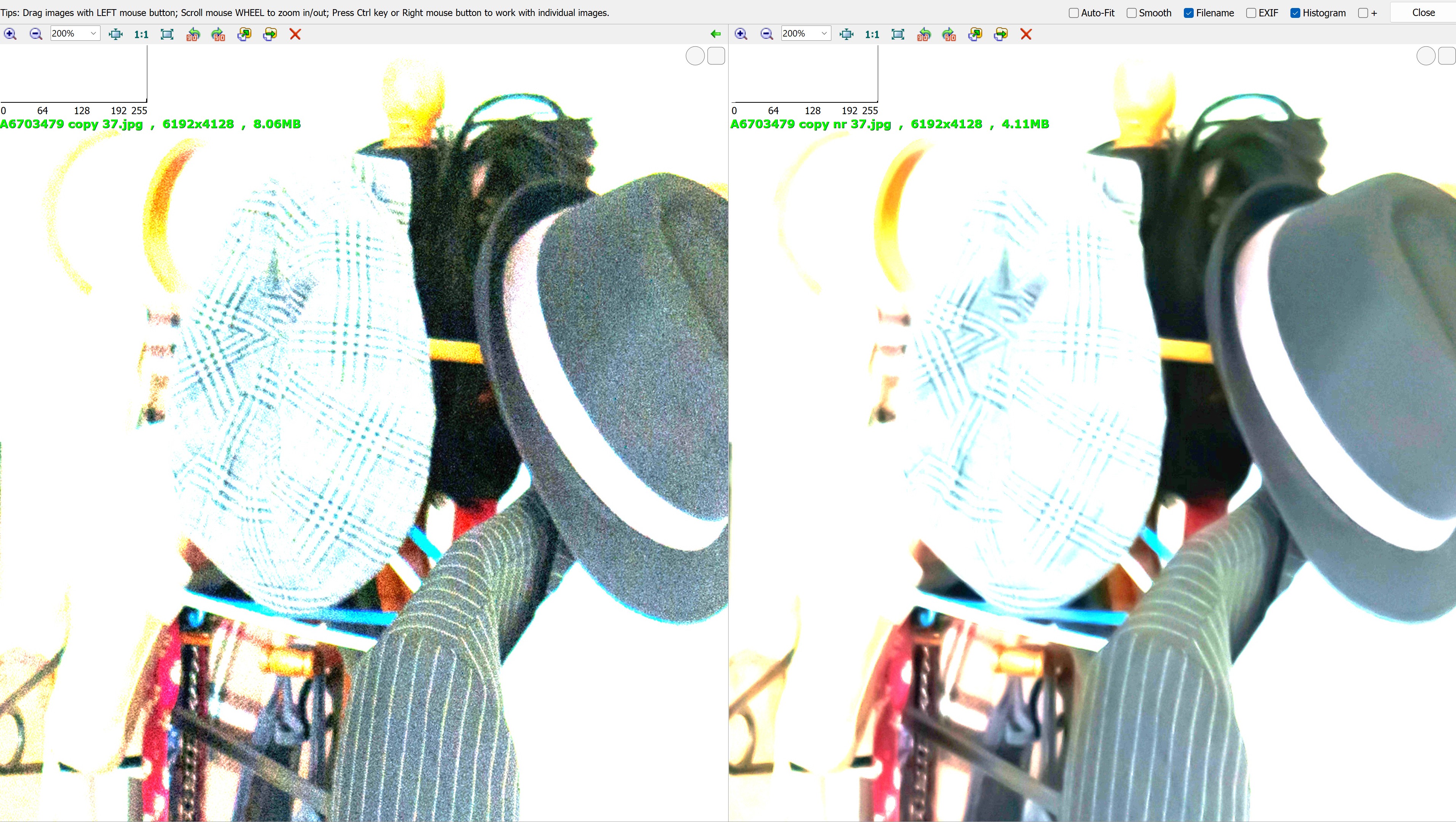

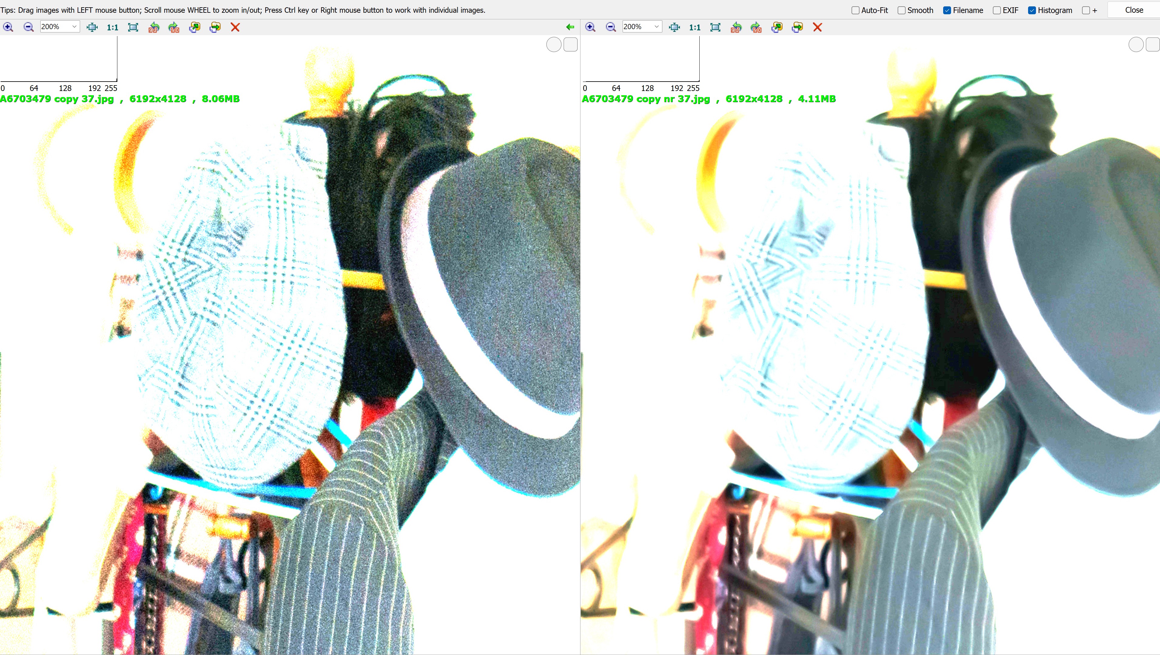

    JPG, 1.4 MB, uploaded by DonaldB on July 7, 2025.
  • July 7, 2025, 9:02 p.m.
    This kind of noise removal (like you displayed) is pure c**p. If it is your camera NR, then turn it off and use proper NR in postprocessing.
    But even processes in this way DR is increased - if DR is calculated as maximum signal / noise floor - because noise is much less.
    I think you are talking about some different, much more subjective definiton of DR - ability to record [overexposed] highlights and deep shadows into same image, independently of noise level.
