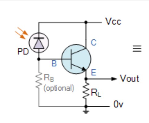

    a transistor has 3 pins base collector emitter, the collector is the input/supply voltage the emitter is the output voltage the base is the controller between the collector and emitter. so if the base is connected to a pixel and collector is supplied with 5 volts or 7 volts with a switch this would be the same as dual gain.

    With dual gain, your analogy requires two transistors, one biased with 5 and the other with 7. Otherwise, using a switch, we would be diving the light captured in some fraction.

    Alan: this description does not apply in any way to MOS transistors as used in digital image sensors.

    Your answer to his question shows how much you know about semiconductor electronics, to be blunt.
    Telling Alan that "a transistor has 3 pins base collector emitter" has absolutely nothing to do with digital image sensor transistors whose connections are called gate drain source and do not operate anywhere near the same as pnp transistors.

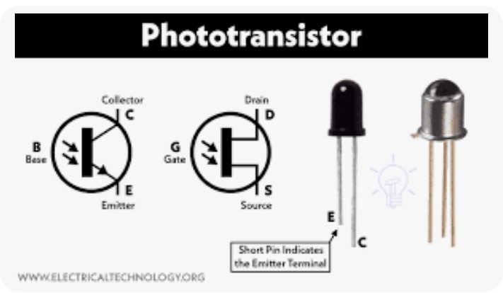

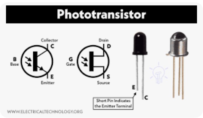

    you need to go back to school
    " In simpler terms:
    Think of a transistor as a general type of switch, and a MOSFET as a specific, efficient type of switch that's commonly used in modern electronics. "
    JPG, 33.9 KB, uploaded by DonaldB on June 30, 2025.

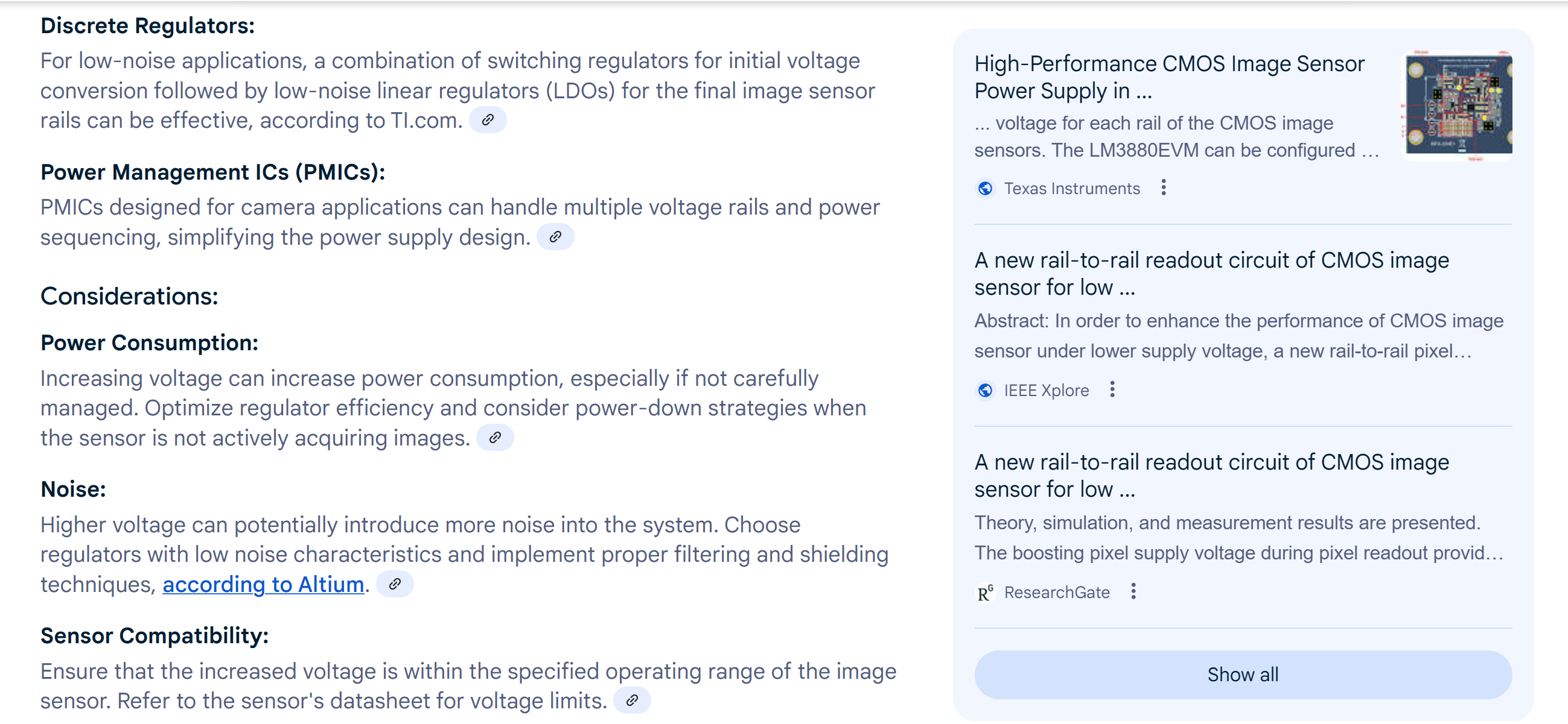

  • Members 2650 posts
    June 30, 2025, 4:03 a.m.

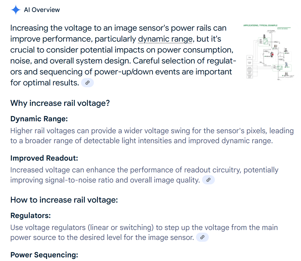

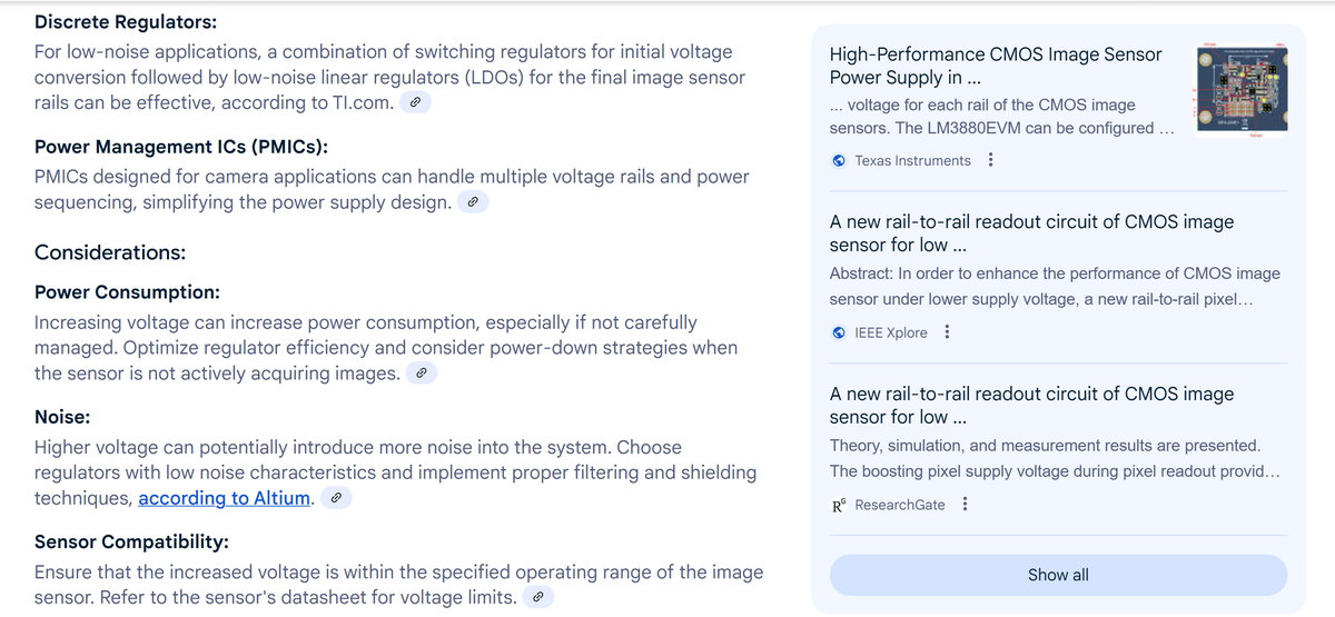

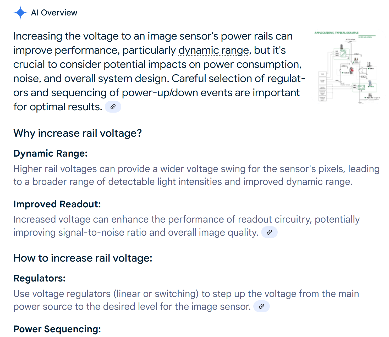

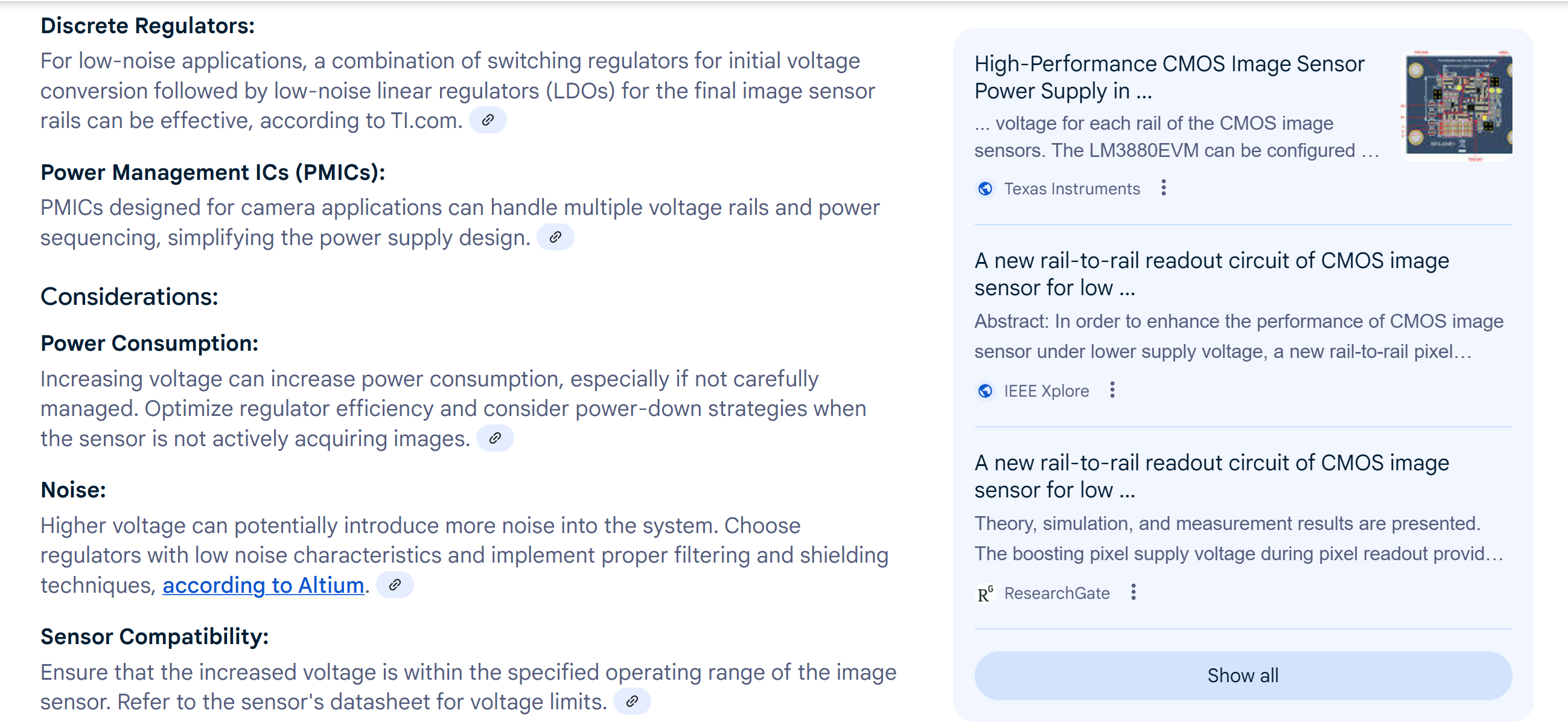

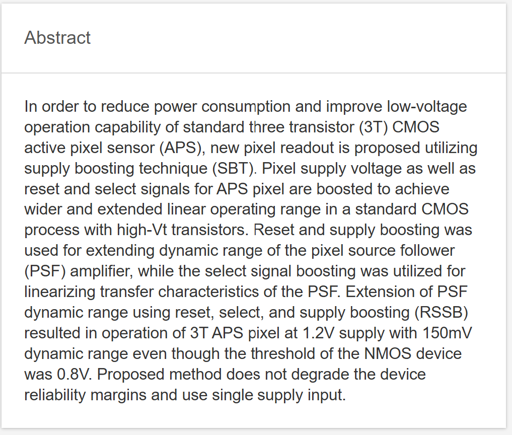

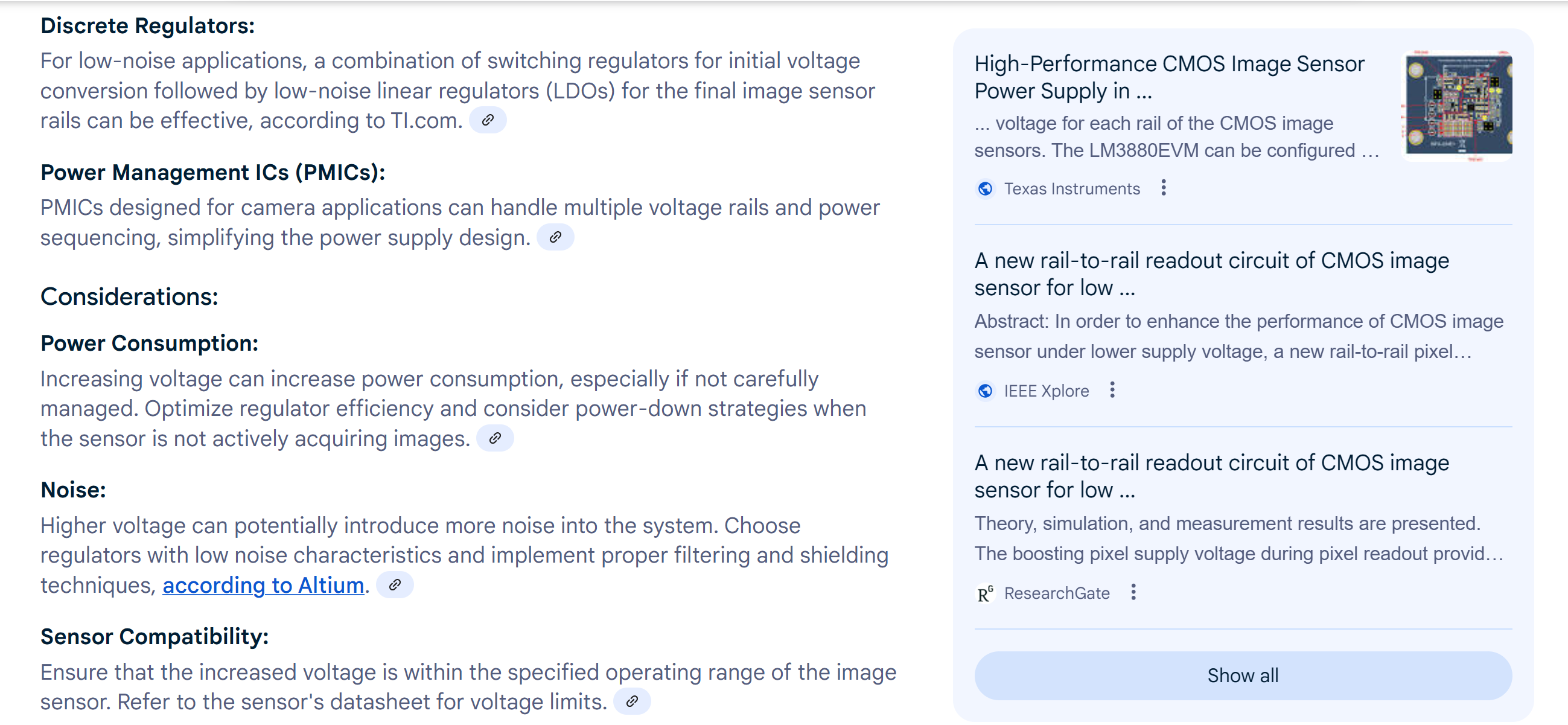

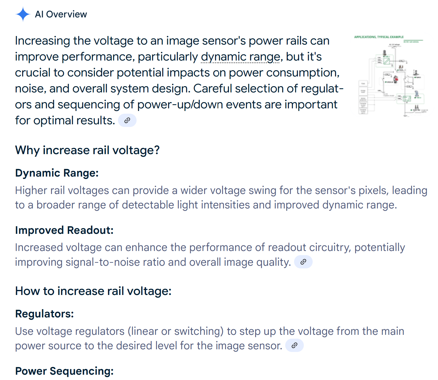

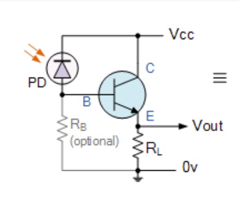

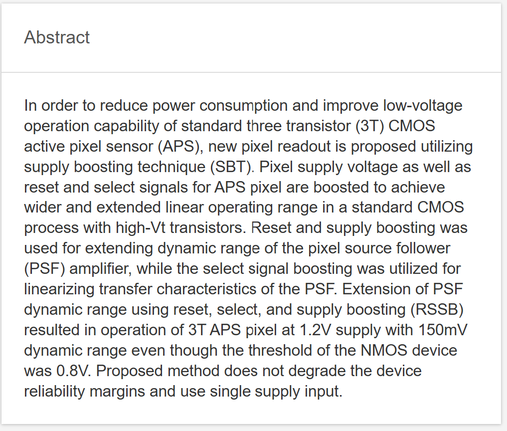

    brush upon your ignorance, dual gain has nothing to do with iso settings as its added at the analogue stage.
    www.electronics-tutorials.ws/io/io_4.html

  • June 30, 2025, 8:03 a.m.
    Ok - calm down everyone.
    As has been said, I'm not an electronics engineer. But I do understand digital circuitry. Let's move away from the transistors etc.
    As I understand it, in order to produce a meaningful picture in low light, the camera has circuitry either on or just after the sensor. This amplifies the signal that the sensor captures. Because of that, more noise is show on the final image. This I understand.
    Then you come to 'dual gain' sensors where different circuitry is applied once a certain ISO is reached (which really means once the light recorded drops below a threshhold.). I presume this is done because the original amplification can only go so far before it reaches its ceiling.
    Assuming my understanding above is correct, I have two questions:
    1. Why does the second set cut in so low in the ISO settings (e.g. 200ISO).?
    2. Why does this appear to produce less noise?
    So, can anyone answer those two? Preferably without circuit diagrams.
