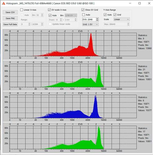

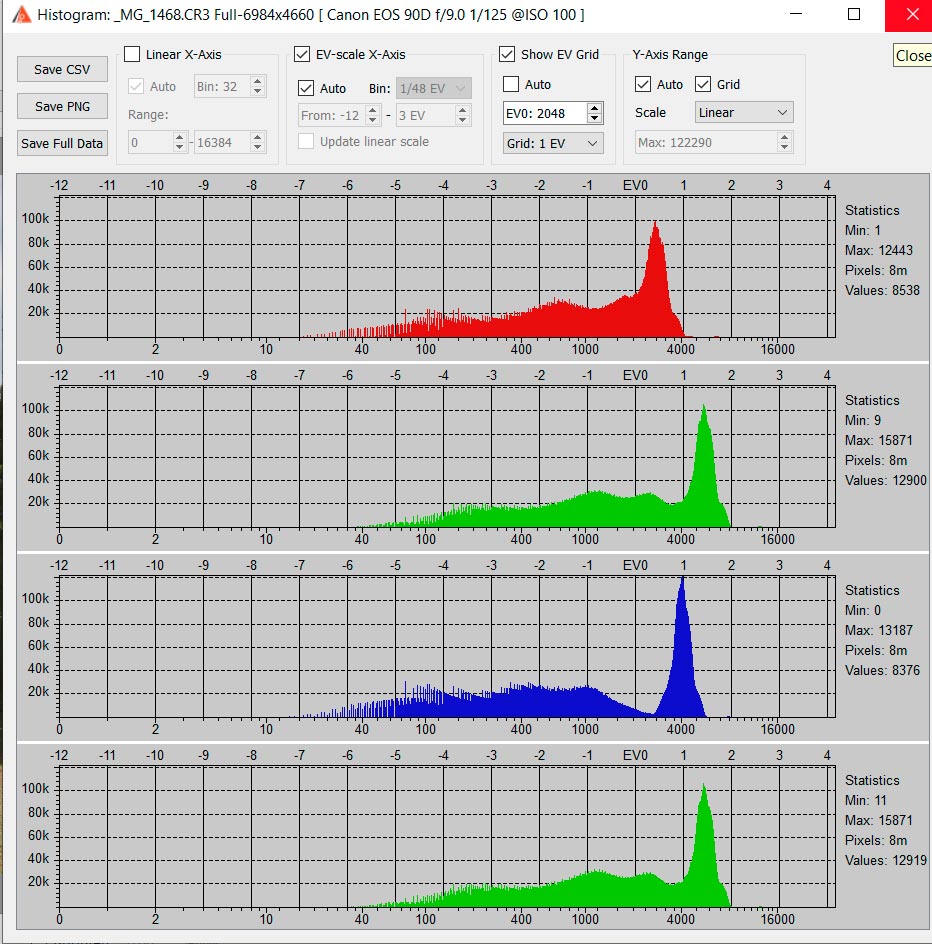

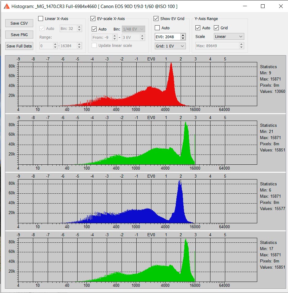

    This raw histogram shows the red are 2 stopped underexposed, the greens 1 stop underexposed, the blues about 1.5 stops underexposed.
    The ACR histogram data is pushed to the right side.
    After adding 1 stop of exposure the raw histogram shows the reds, blues and greens pretty close to optimally exposed. The ACR histogram shows clipping but the actual raw data is not clipped as can be seen in the raw histogram.
    Opening the optimally exposed raw file in ACR and lowering the image lightness by 1 stop results in an image with the same image lightness but the visible noise is reduced, due to the increased SNR, compared to the underexposed raw.
    That is the main benefit of using raw histograms for me.

    What are those peaks at the right side of the green histograms on the optimal exposure? Looks like clipping.

    Your eyes are much better than mine. Yes it looks like a bit of clipping so I should have added only 2\3 of a stop since my aperture and shutter speed are set to 1\3 stop increments.
    But these histograms are just quick and simple examples to prove the concept behind the benefit of raw histograms.
