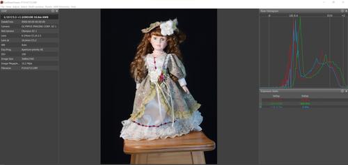

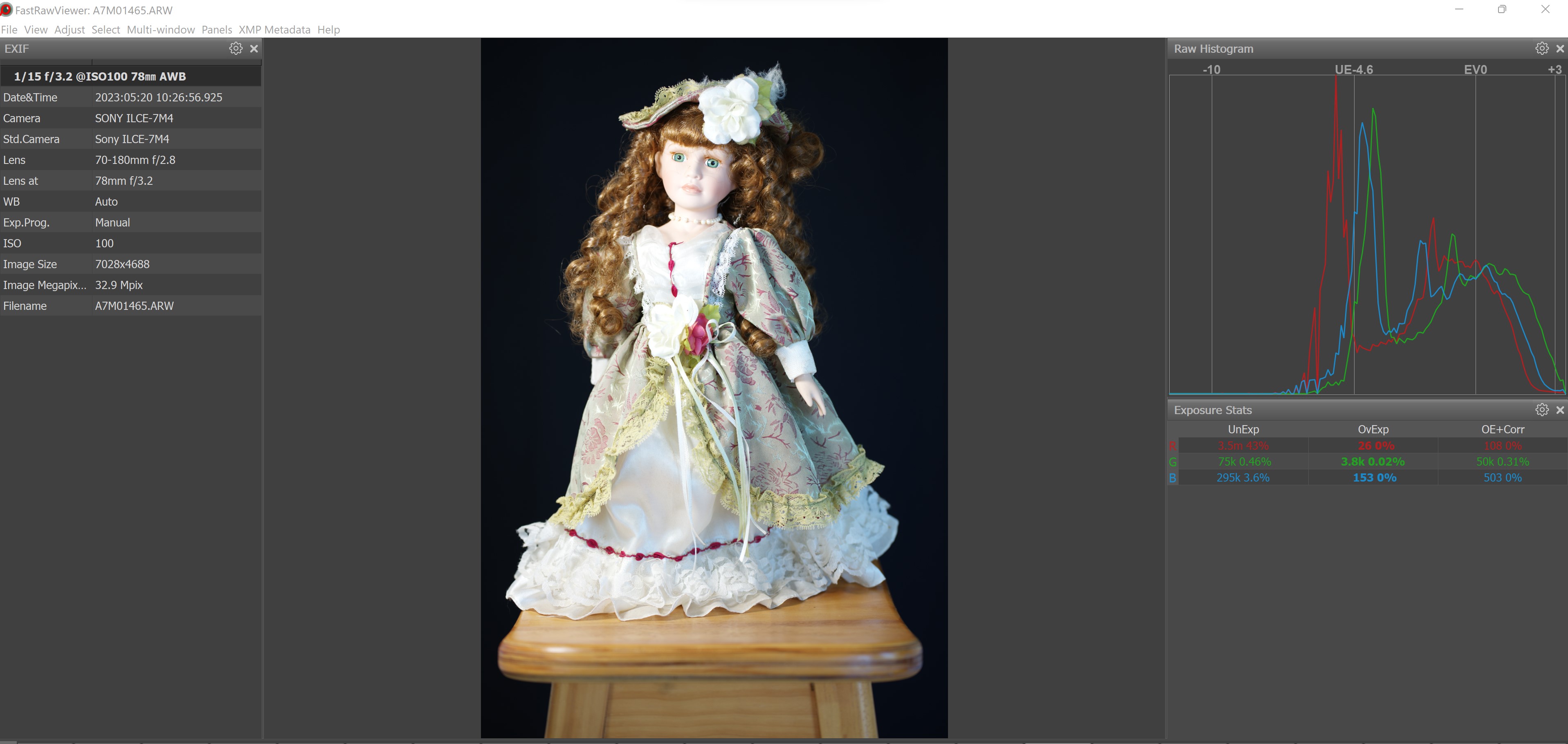

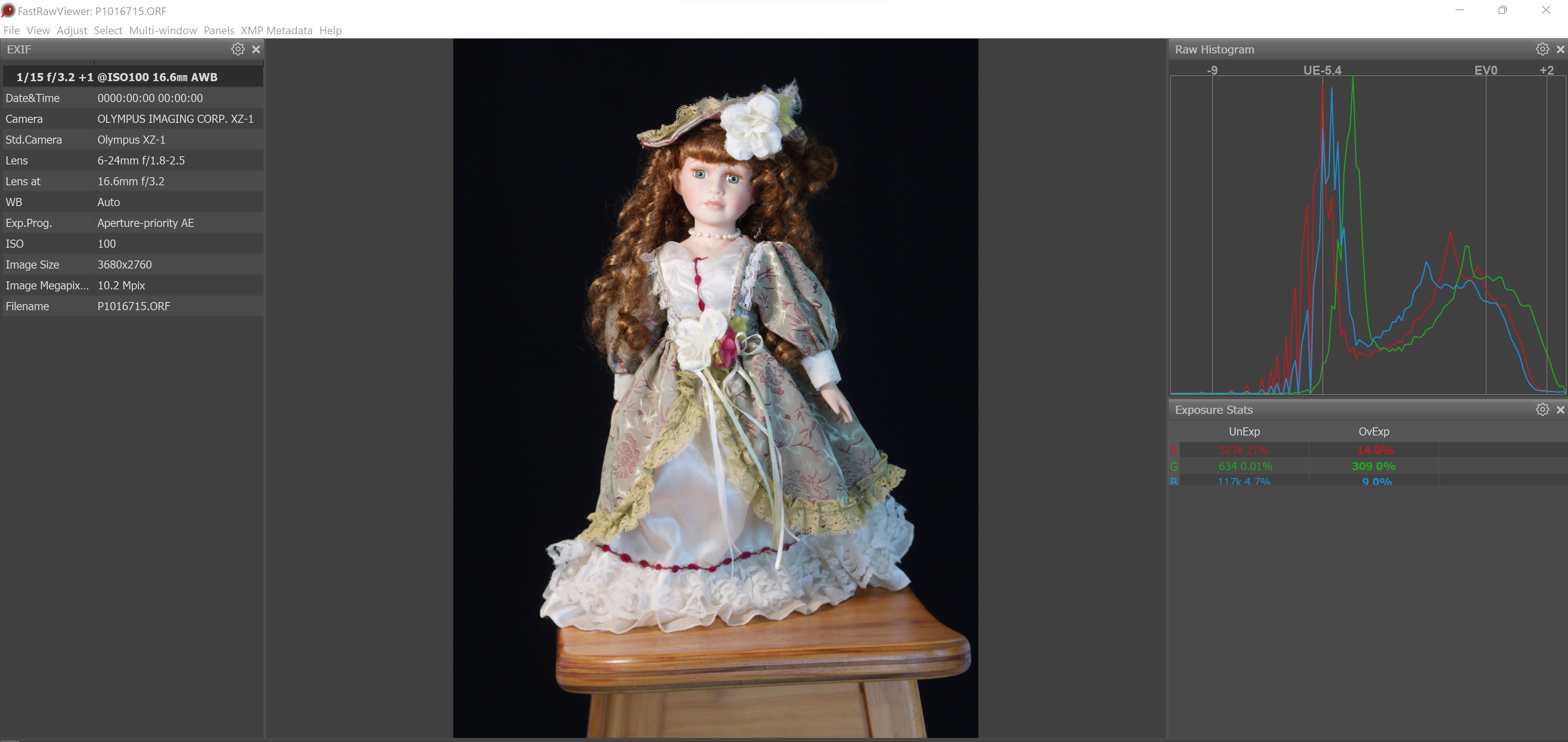

    @DonaldB has written:
    @IliahBorg has written:
    olympus xz1
    That's one of the very few cameras that are calibrated in raw close to the standard.
    Funny that you should say that. because the exposure settings on that camera were always different than any other camera i owned. now i will compare it to my a74.
    just did the test and the A74 and XZ1 histograms maxed out showed the identical exposure. thats awesome. the olympus playback RGB histogram is unbelevabley detailed.
    JPG, 554.2 KB, uploaded by DonaldB on May 20, 2023.
    JPG, 543.0 KB, uploaded by DonaldB on May 20, 2023.
    you need to rework those tests
    Jim is correct.
    not unless i see images of the rear LCD screens and raw histogram im not convinced.
    olympus xz1
    1/15 f/3.2 vs. 1/15 f/3.2+1. What's that +1?

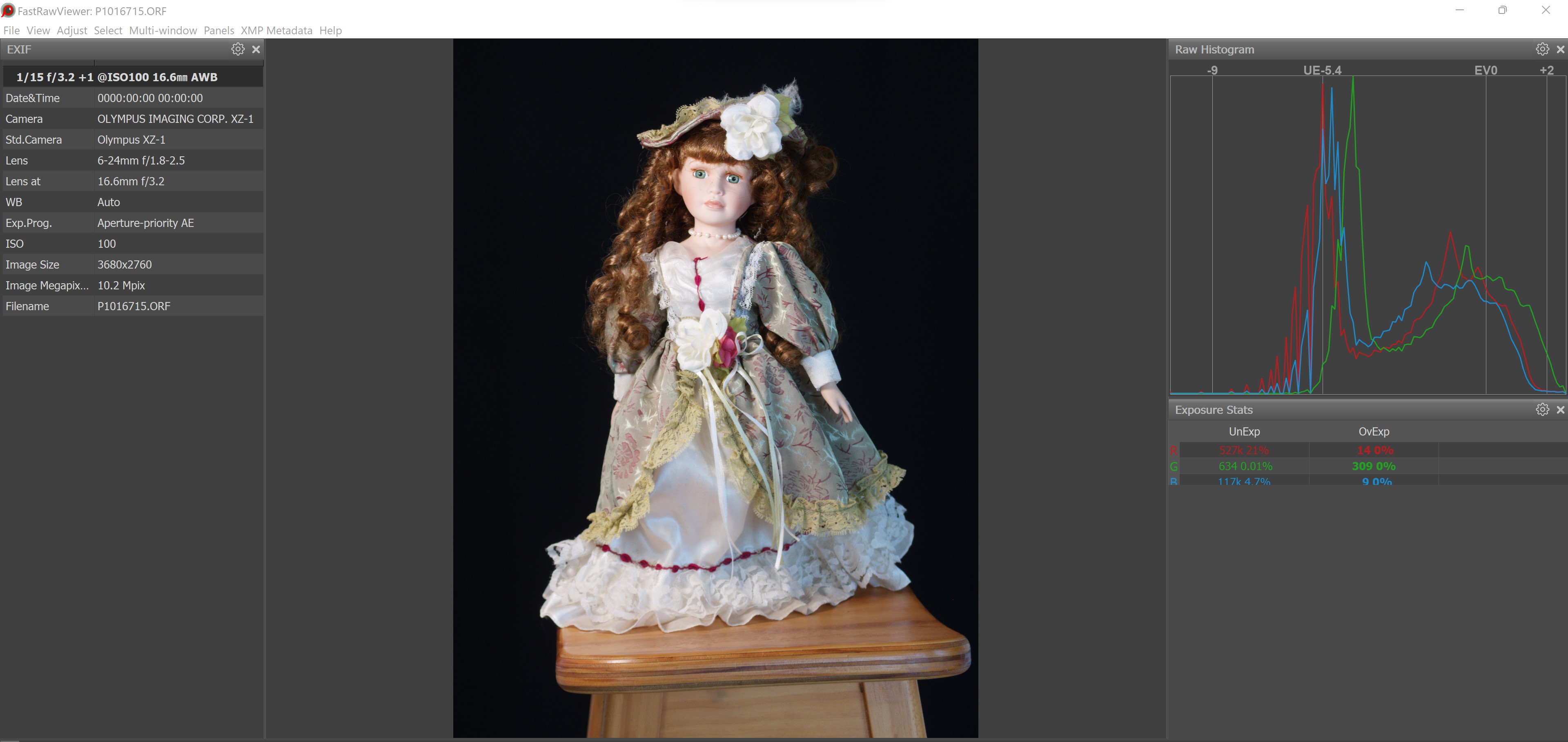

    @JimKasson has written:
    where is everyone getting the idea that incamera histograms are not acurate ?
    In my case, from testing. Here are a few of the cameras I've tested: Sony a7, a7II, a7III, a7R, a7RII, a7RIII, a7RIV, a7S, a7SII, a9, a9II. Nikon D3, D4, D5, D800, D810, D850, Z6, Z7, Z9. Fuji GFX 50S, GFX 50R, GFX 100, GFX 100S.
    seriously Jim, i think you need to rework those tests.
    1/20 on FastRawViewer screenshot, 1/25 on the LCD. Interesting.
    IanSForsyth likes this.

    DonaldB
    Members 2663 posts
    May 20, 2023, 1:49 a.m. May 20, 2023, 1:49 a.m.
    good catch. have no idea will have to look into that.
    DonaldB
    Members 2663 posts
    May 20, 2023, 1:53 a.m. May 20, 2023, 1:53 a.m.
    olympus xz1
    will check it out.
    checked it out thats just the over exposure amount form the cameras normal exposure, its not a correction.
There are 162 more posts in this thread.
