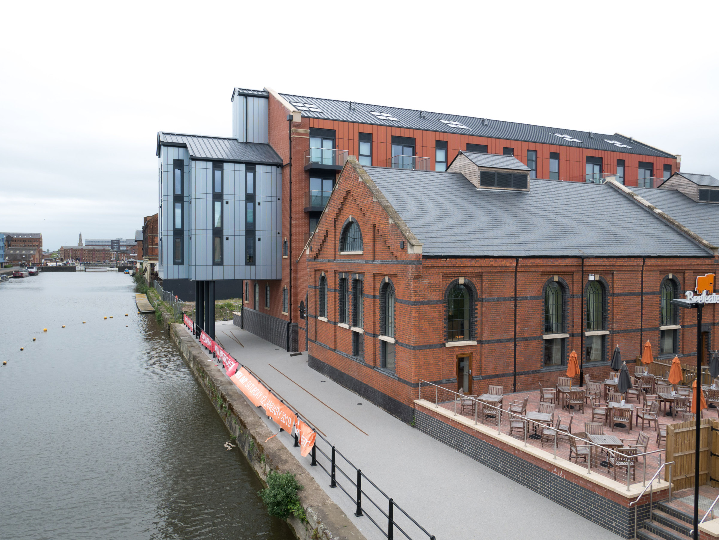

    The first image is a wide-angle view of a building (28mm FFequivalent).

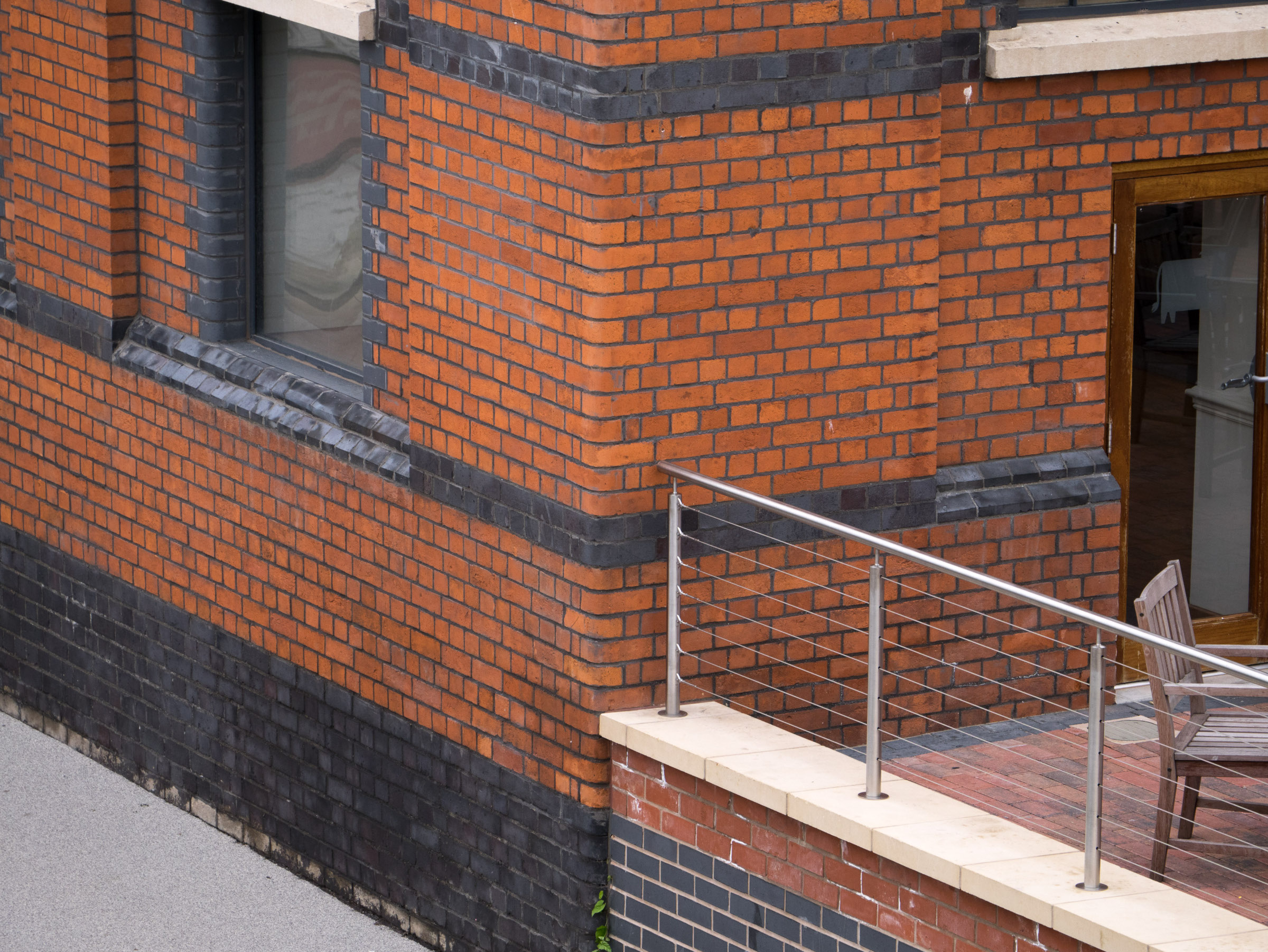

    The second image is a view with a 200mm FFe lens, taken from the same camera position. It is effectively the same as a small crop from the first picture, enlarged about 7 times.

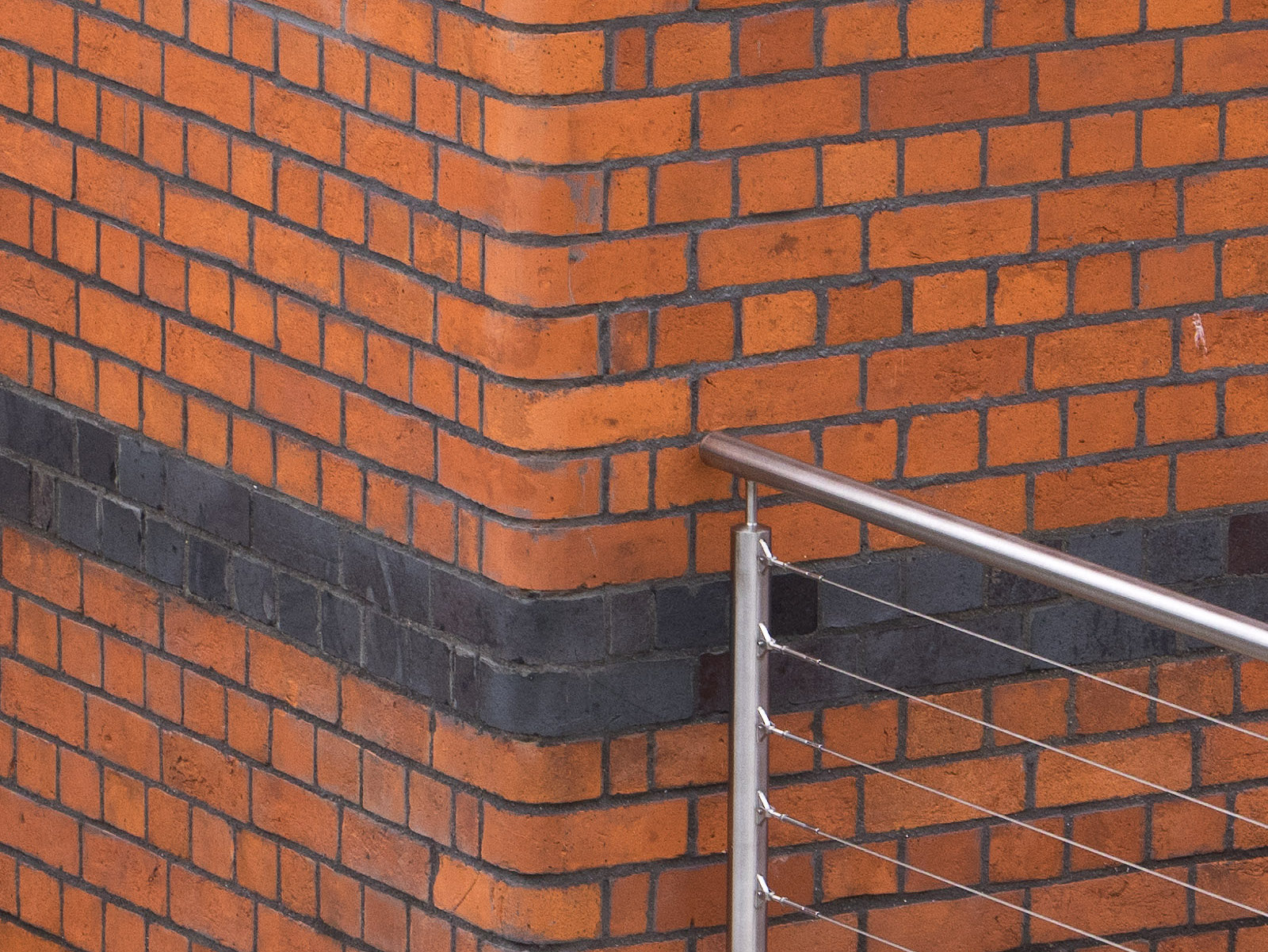

    The third image is a small crop from the centre of the second image. It is equivalent to an image taken with a 570mm FFe lens from the same position.
    If all images are viewed normally, the first image shows the scene with magnification of 0.65x (i.e. it's like looking through a telescope with magnification of 0.65x). The second image has about 4.6x magnification. The third image has about 13x magnification (compared to what the eye would see from the camera position).

    However, the third image (viewed normally) will probably show strong perspective compression to most people. The brain is familiar with the usual size of house bricks and the brain then works out that the viewer is probably between 2 and 3 metres away from the building. Starting from that assumption, the whole scene looks very flat because the size of the bricks varies very little from one part of the wall to another. So the brain deduces that the two sides of the building are both nearly perpendicular to our line of sight. Hence the two sides of the building are not at 90 degrees as might be expected, but at a much flatter angle to each other. Also, the angle of the railing doesn't look quite right either.
