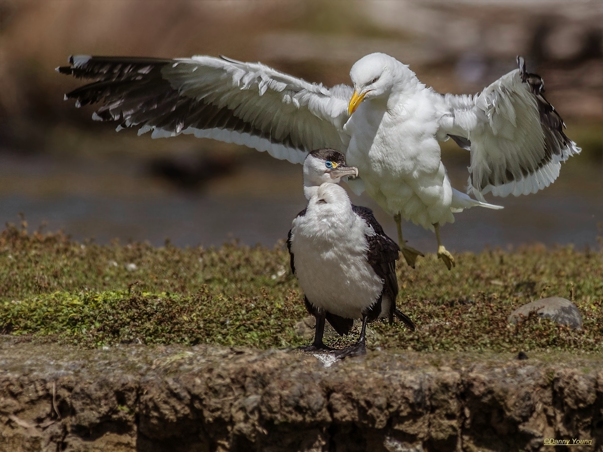

    So zoom with your feet. Tried that once and jumped when taking a bird in flight shot ...... It didn't work!
    So me being really basic and all. The seagull is not close to the Cormorant.
    800 F/5.6.
    Danny.

    So basically, both birds are a long way away. The seagull is even further away. But the gap between them is very small compared to the gap to the camera. So the reduction in apparent size of the seagull from that little bit of extra distance is very small compared to the reduction in size of the pair of birds. The brain can't make easy sense of that and it makes us think they are at the same distance. We notice it because the magnification brings the subject close to us and the compression easy to recognise. Exactly the same effects apply to wide angle lenses, but the subjects are rendered so small we can't even see them, so we overlook the effect.
    Why then does everyone still call it telephoto compression? (Not that it makes much practical difference to photographers. We see the compression effect when we use teles, we don't when we use wides, so it might as well be caused by the focal length for all practical purposes).
