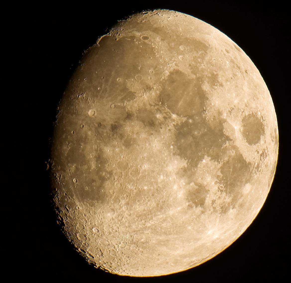

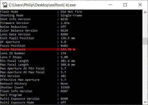

    Speaking of viewing distances and long lenses, did you know the Earth-Moon distance is only 133.35 meters when viewed through a Nikon 200-500 f/5.6 lens @ 500mm? A lot less than when viewed with the naked eye, which I'd guess about some 400,000,000.00 meters.
    JPG, 86.2 KB, uploaded by Flashlight on April 21, 2023.
    JPG, 235.3 KB, uploaded by Flashlight on April 21, 2023.

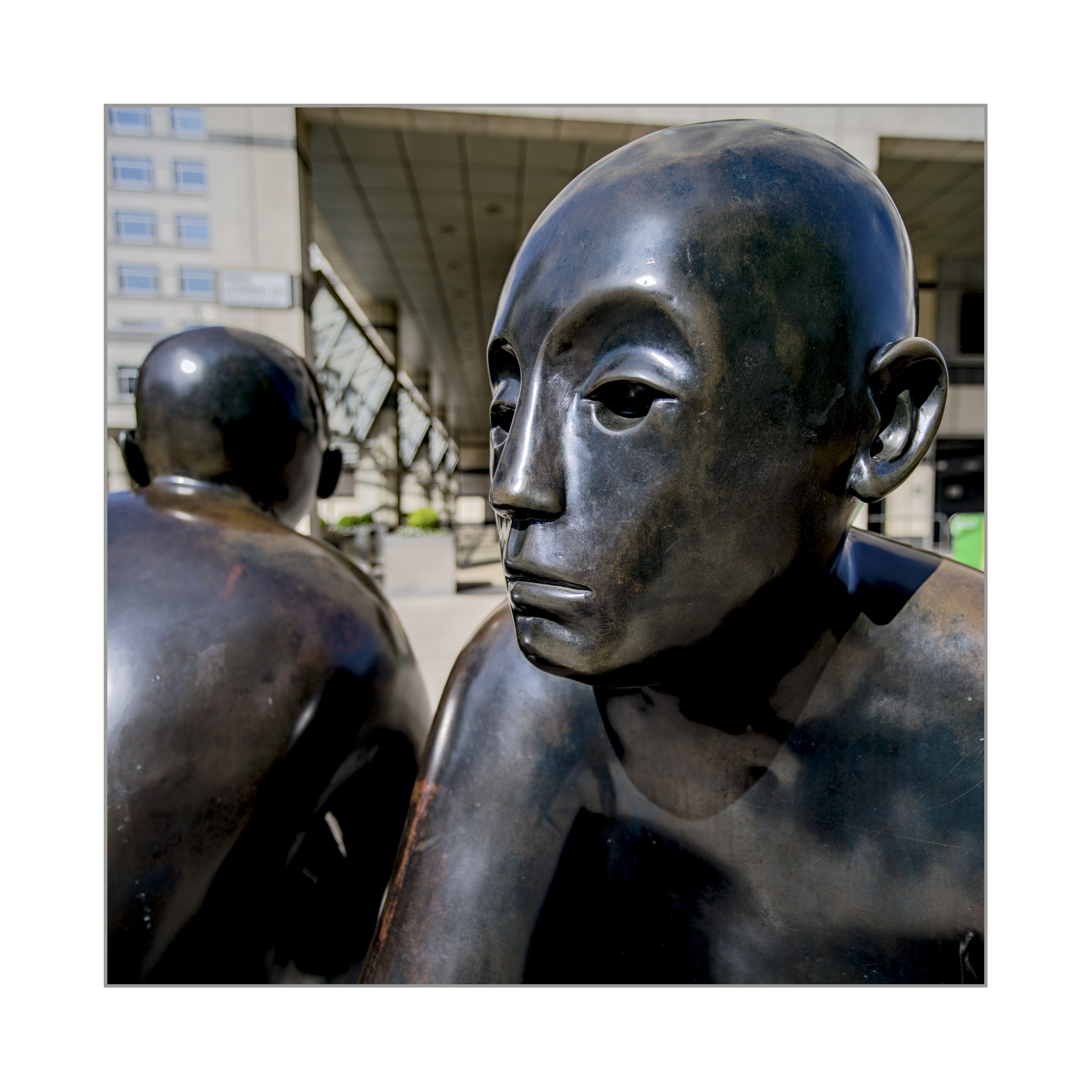

    Talking of illusions, is it just me, or does this picture provide the illusion that the statue on the left is wearing headphones (it isn't)?
    JPG, 884.0 KB, uploaded by DavidMillier on April 21, 2023.
